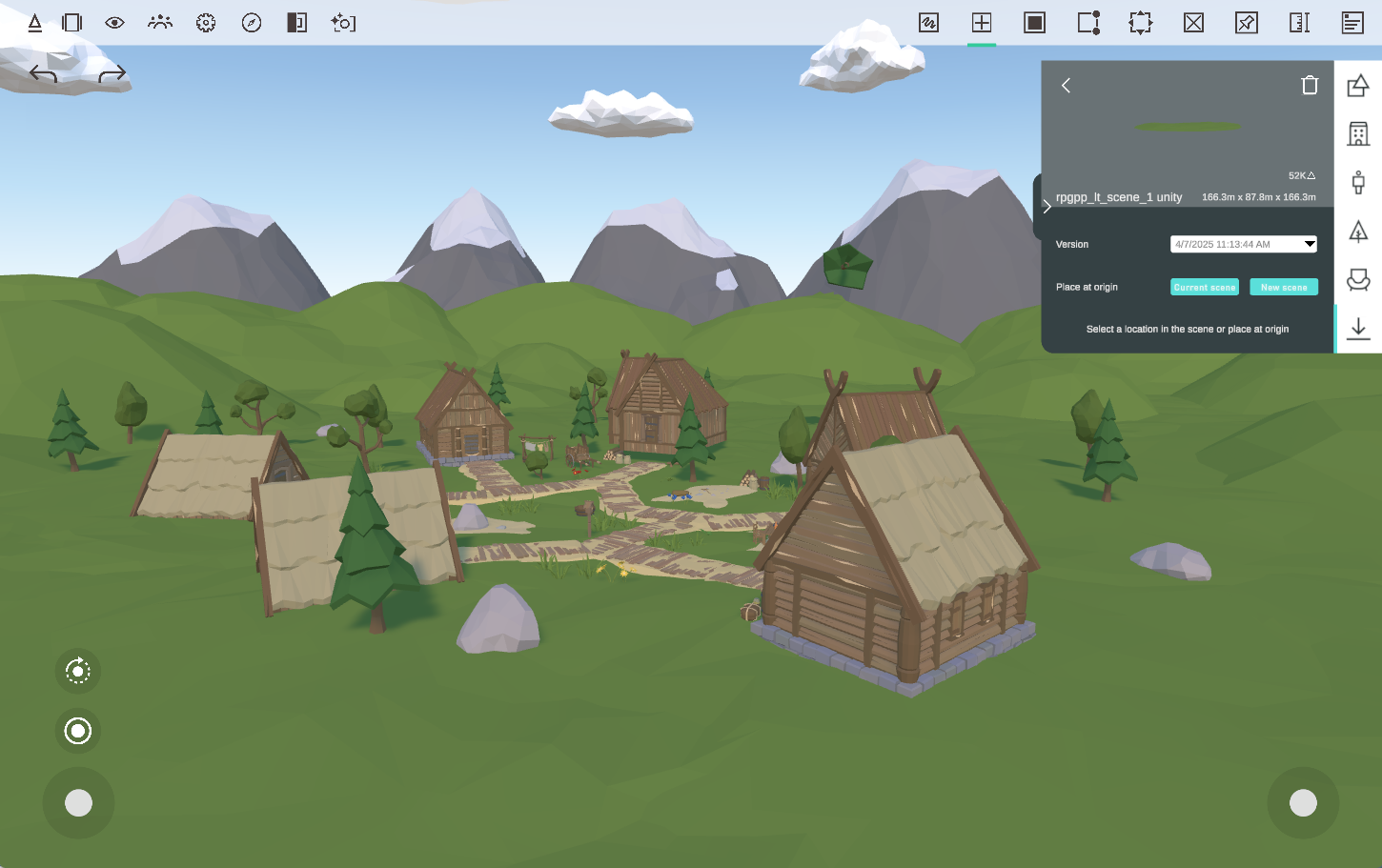

Once the scene has been exported from Unity, you can import the scene to Arkio on PC from the Create > Import tab. You can place all your scene objects at the origin position in the "Current scene" or a "New scene".
This will pin your imported scene. You can unpin the file to make it movable in Arkio and share your editable scenes by inviting others to join you in a live meeting or by sharing the scene via the Arkio Cloud.
