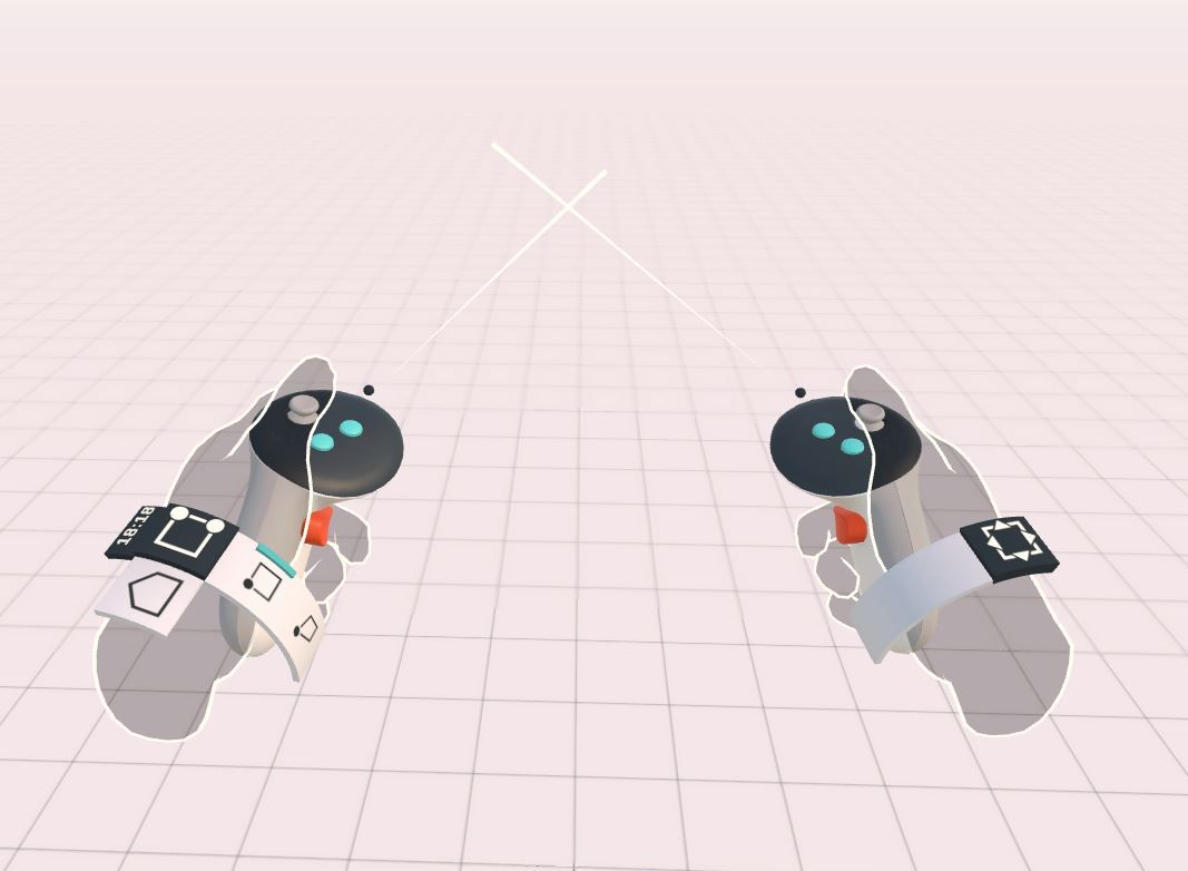

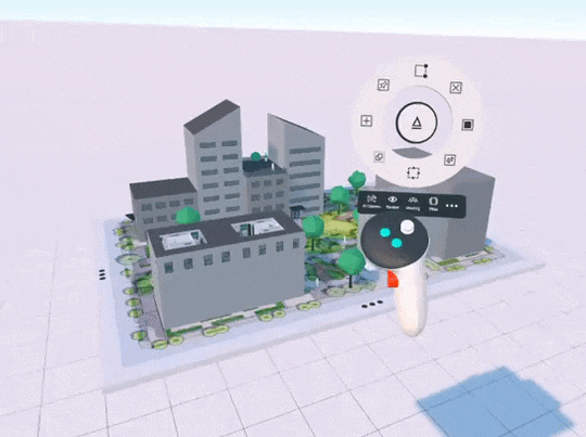

By default, Arkio starts with no tool selected on each hand. The black plate indicates which tool is currently active on that hand. This can be an icon for operations like edit and move, or a 3D object or paint material if those tools are selected. In Arkio, you can use tools in both hands. You can select these tools using the main menu. The Arkio home logo will reset you to the front of your table, and you can access device-specific features like passthrough and locking your position on a Mixed Reality headset like the Meta Quest.
If you are using different VR controllers, the position of your wristband might change. You can also use these wristbands with hand tracking to press the buttons with your index finger.

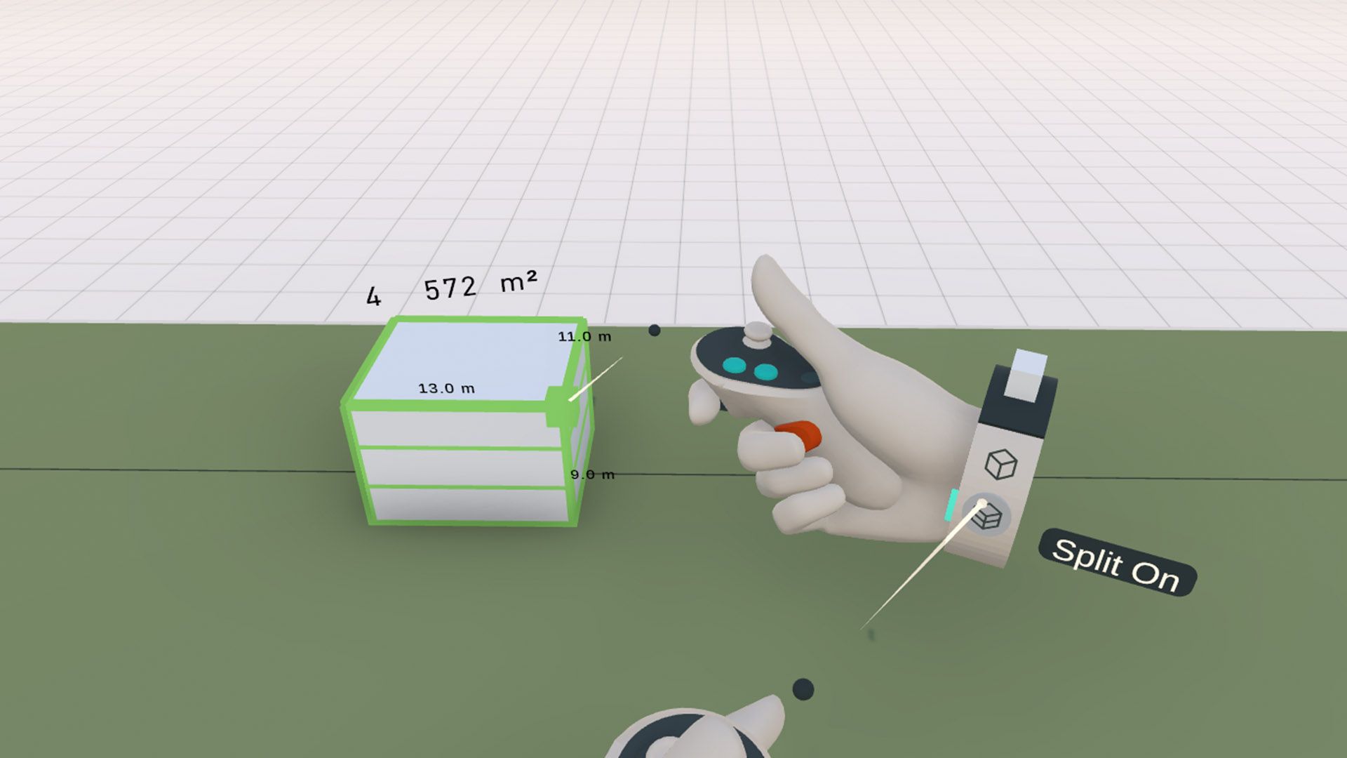

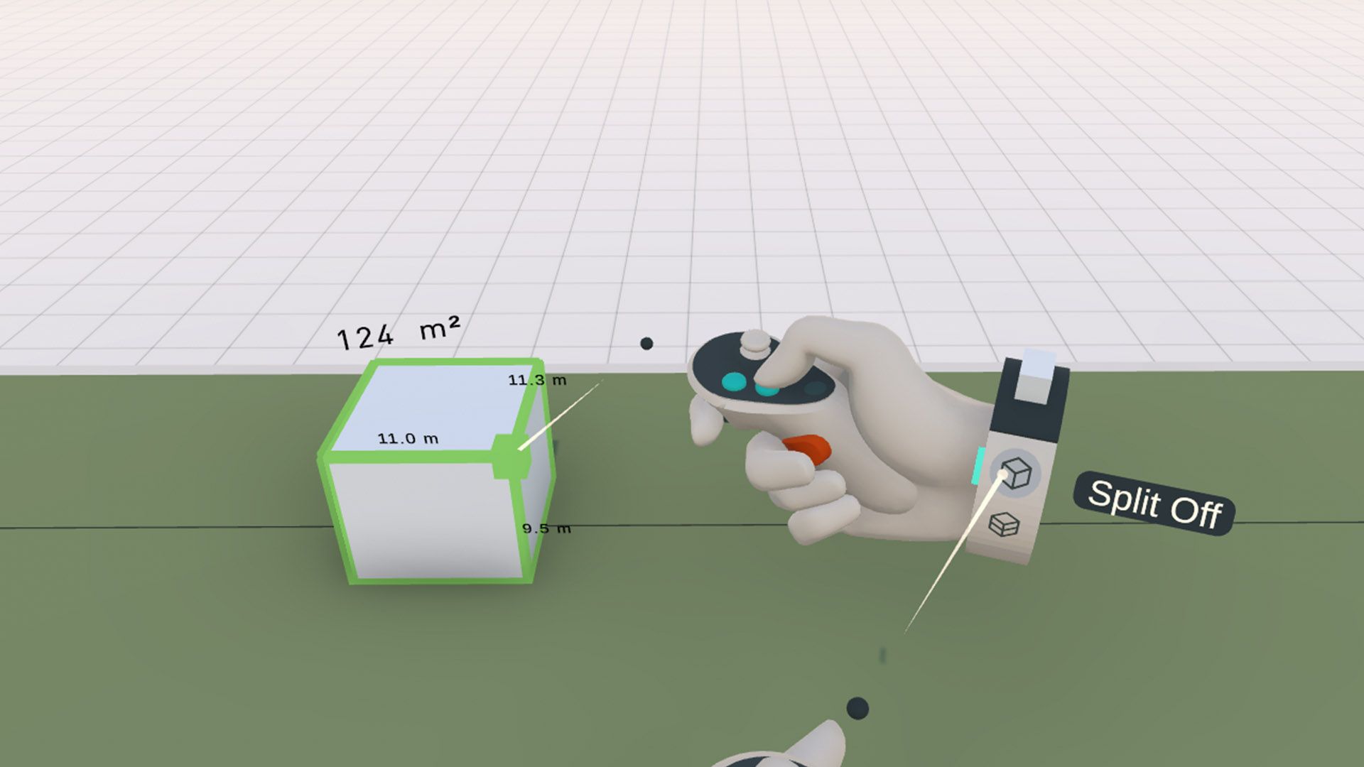

Create - for solid/hollow shapes, it defaults to creating a full volume, but can be toggled to a volume that is automatically split into stacked floors.
