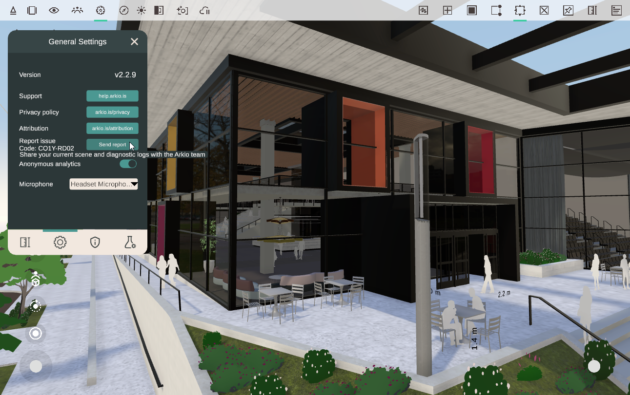

If you are experiencing issues with Arkio, you can help us debug the issue by sharing an issue report with us using the Send Report button under General Settings. This will collect the latest Arkio logs from that run and scene on your device and include other information like device profiles that help us to investigate the problem.
