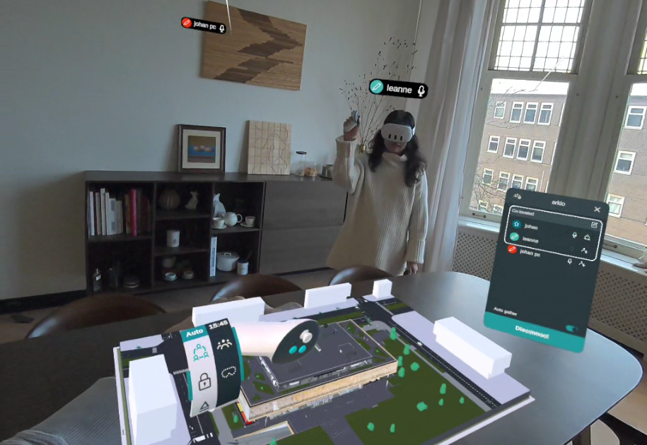

When working with multiple Meta Quest headsets in one location, Arkio allows them to be co-located. This aligns the headsets with each other's positions, allowing users to be positioned relative to their current physical location when gathered or anchored in Mixed Reality.
This can make your live presentations and tours more engaging by allowing meeting participants to experience models as virtual maquettes. You can then jump into these models in virtual reality with boundaryless mode, or use mixed reality at human scale to blend the real world with your imported files or Arkio geometry.
Manage colocated groups

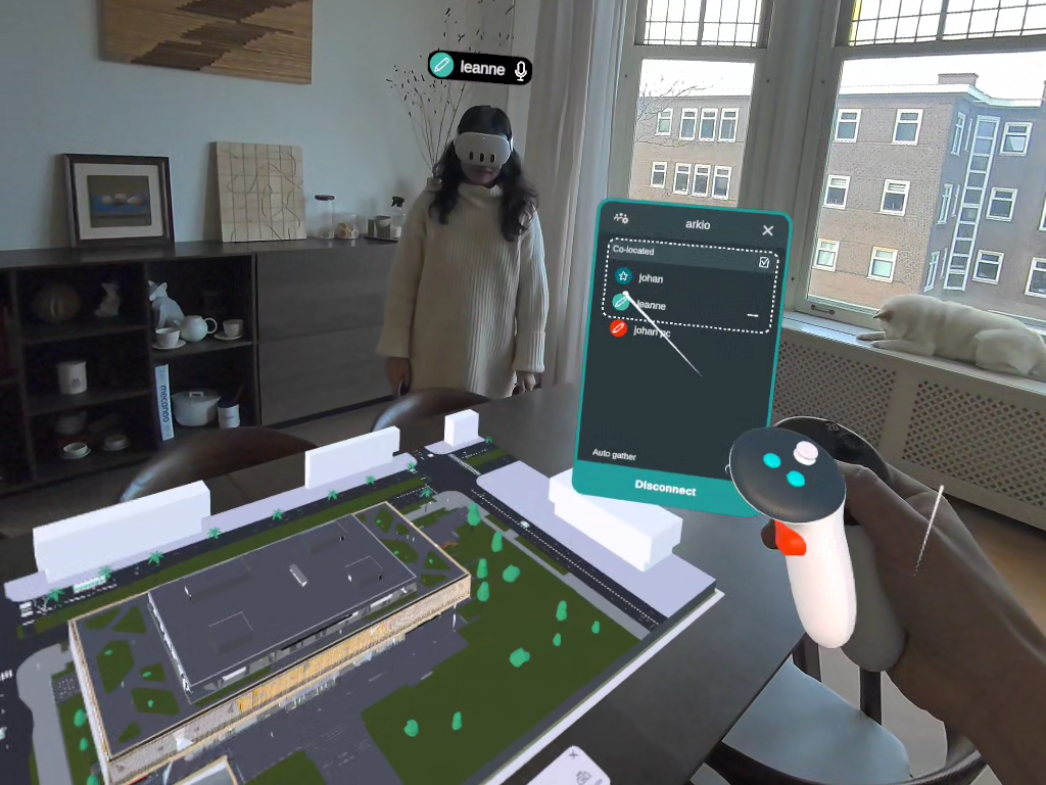

Colocation groups can be managed from a Meta Quest headset. The meeting host will see a co-located outline that includes the host and any co-located users. Meta headsets in a meeting will automatically search for the same spatial anchors on nearby devices and try to join the co-located host. Use the "Manage Group" button and the "+" and "-" icons next to each user to manually manage users in this group. Other Quest users in the meeting can also request to join or leave this group using the top-right button in this outline.
Users on non-Quest devices cannot join the co-location group because spatial anchor sharing between Meta and other devices is not yet supported. Users who are not colocated will be gathered like normal meeting participants set in the meeting settings. If you are having trouble adding colocated users, you can follow the troubleshooting steps at the bottom of this page.

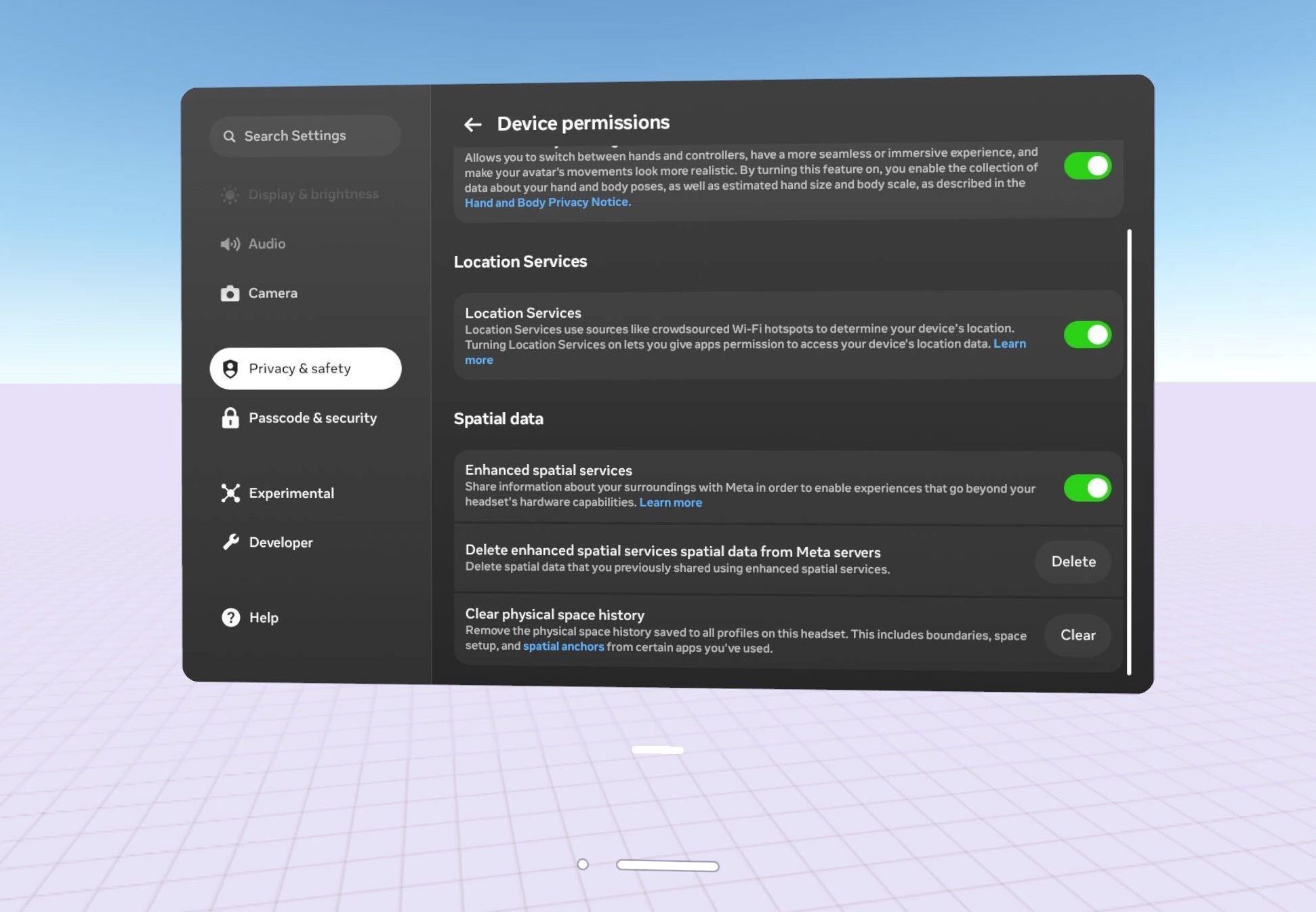

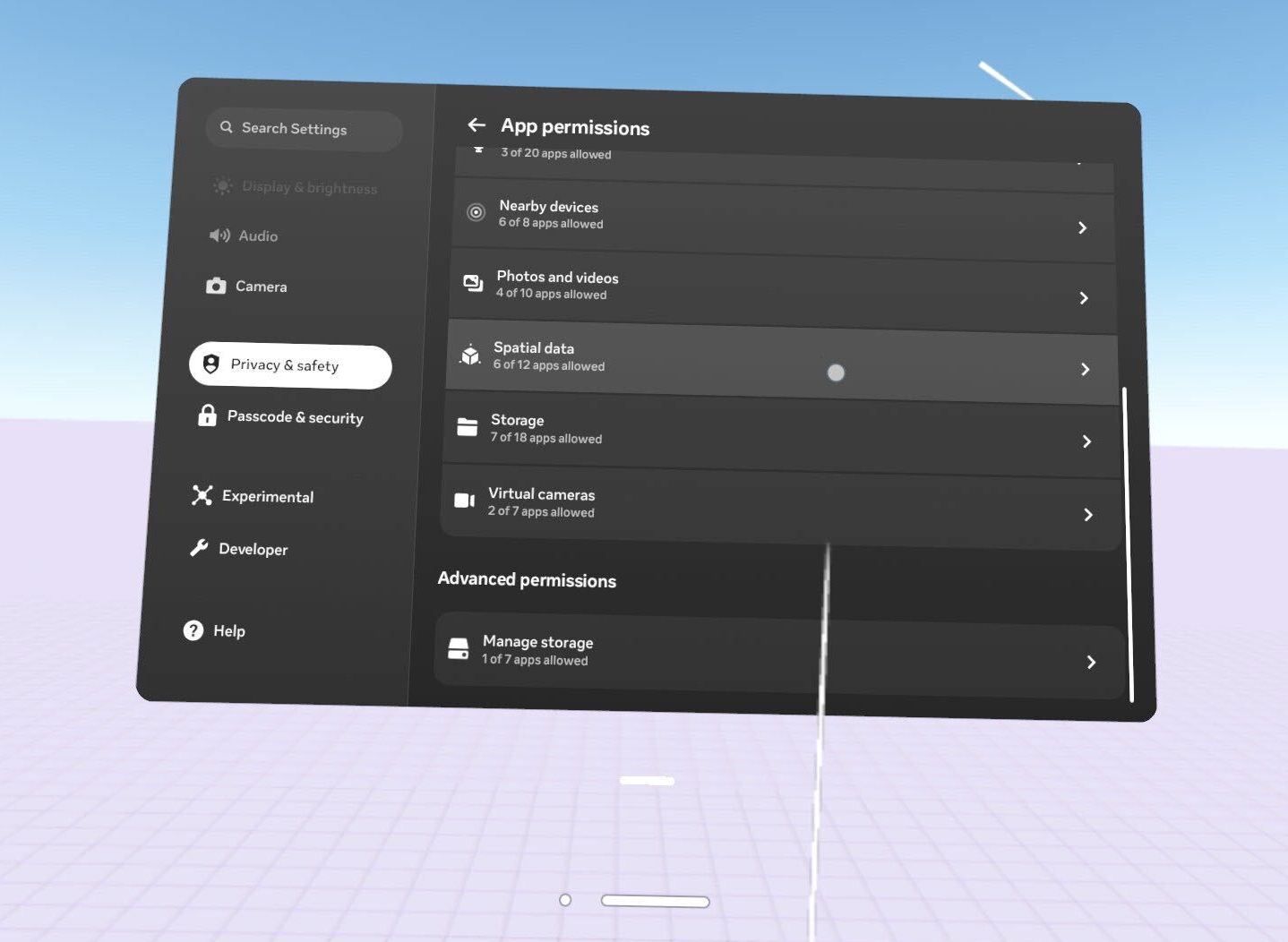

Enhanced Spatial Services and the Spatial Data permissions must be enabled on your Quest devices for Arkio to enable a colocated meeting. You receive a notification to enable this on startup, and you can later change this setting in Settings > Privacy & Safety > Device Permissions

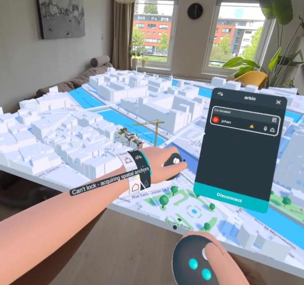

A warning in the meeting panel or on your wristband indicates if there is an issue with your device's spatial data. Once the spatial anchors are available and you are in the same meeting, your Quest devices should be able to join the same co-location group.
Sometimes, devices have difficulty finding the same spatial data because of outdated or invalid data from previous spaces. A warning icon will appear behind the username in the multiuser panel to indicate that the user cannot join the same colocation group.
It can also happen that a colocation group is joined without warning, but there is a misalignment among two or more headsets. Every time colocated users are gathered, there is an offset due to misaligned older anchors.
To reset and improve colocation detection, you can best "Delete enhanced spatial services spatial data" and "clear physical space history" in Settings > Privacy & Safety on the headsets experiencing the colocation issues. The headset will then automatically rescan your space. After walking around your room and rejoining the Arkio meeting, your colocation alignments in Arkio should work better.
