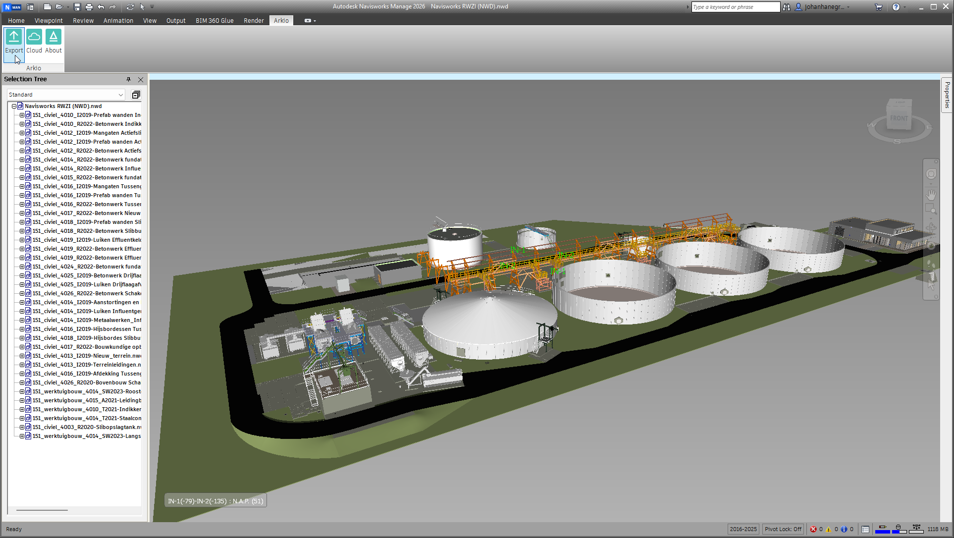

To export your models from Navisworks, you must have the Arkio plugin installed. Open Navisworks in 3D view, make sure all the elements and layers you want to export are visible, then press the Export button.
After a model is exported, Arkio opens on your PC and displays the newly exported model in the Create > Import tab. You can open the model to preview it and place it at the origin in your current or a new scene from the import panel or place it manually by clicking in the scene.

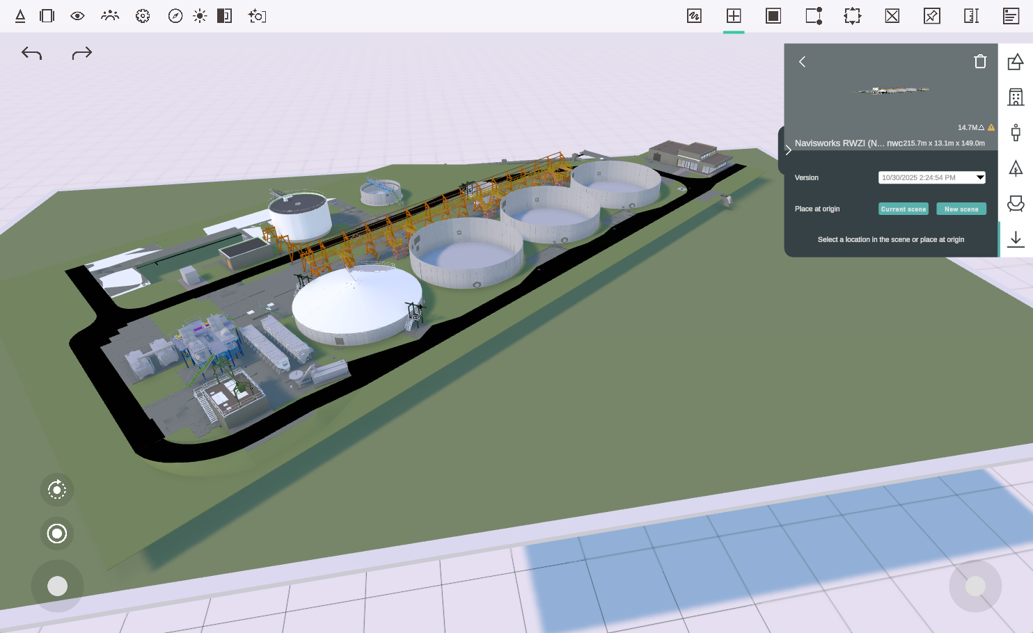

From the import panel, you can click on the filename of your import to open the placement sub-menu, where you can preview your model and select model placement options like the size, orientation and version.
With the placement sub-menu open, you can click anywhere in the scene to manually place an instance of that model. Or press the green Place at origin buttons to place the model pinned in the current or a new scene. Models placed at the origin can be aligned with other models, enabling a round trip between your design tools when exporting Arkio-added geometry back to your existing tool.

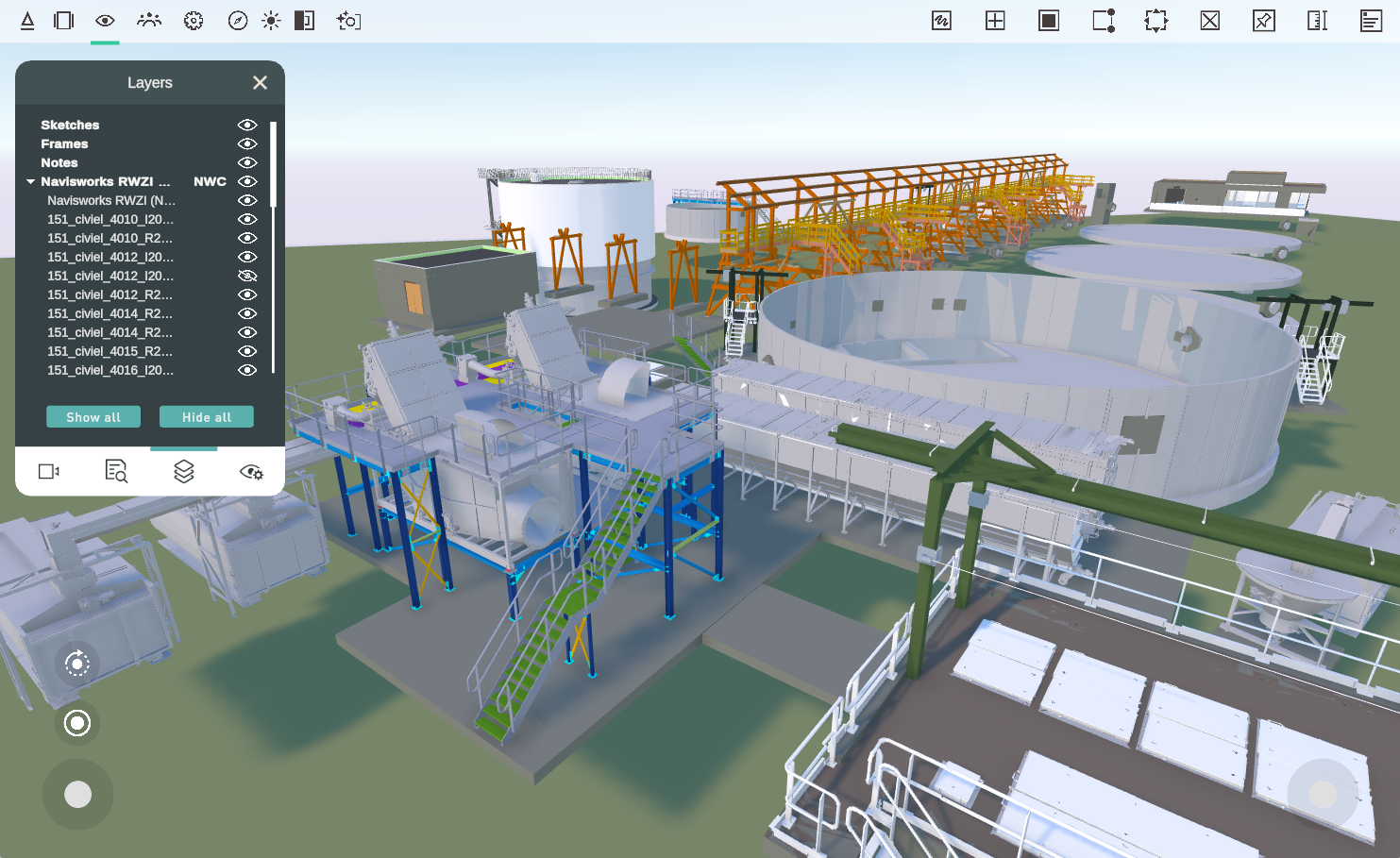

Layers and BIM data
Your Navisworks-exported files contain layer information in Arkio, mapped to the Navisworks model selection tree. If you want to present or switch between layers in Arkio, you can customize the model hierarchy and re-export your file to update your model in Arkio.

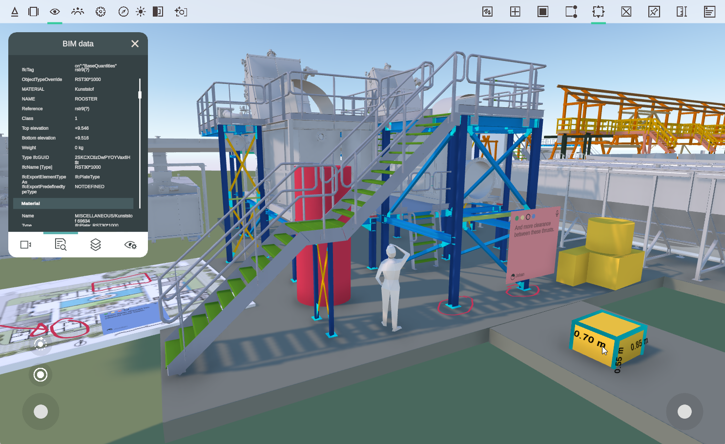

The Arkio plugin exports all the available BIM data for objects. The panel can be opened from the Review panel > BIM data tab, and the imported elements can be hovered with the laser/mouse/touch.

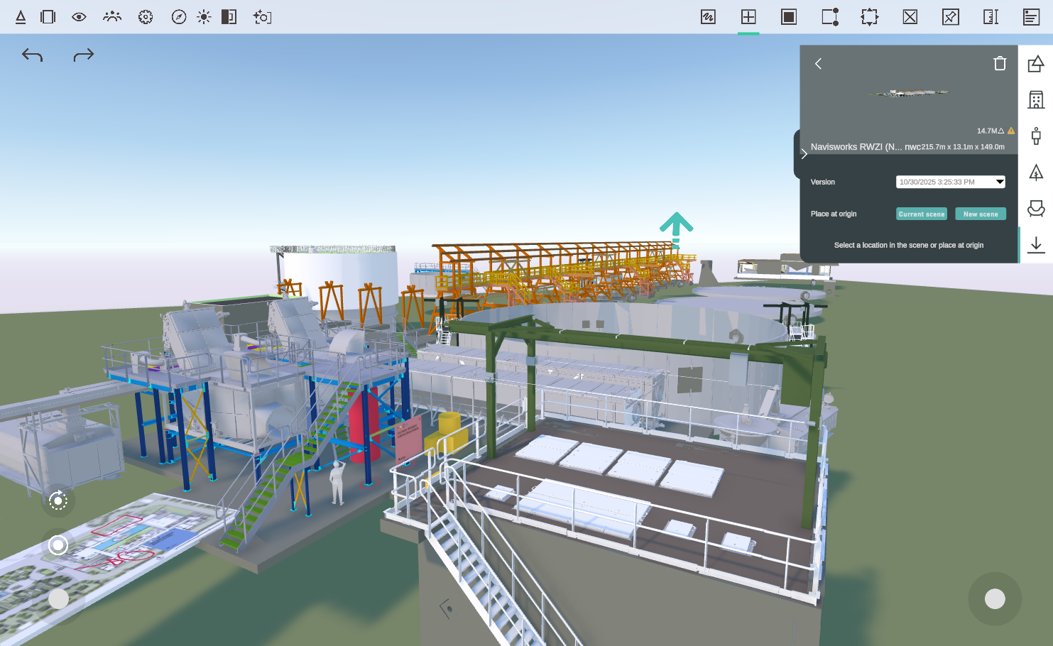

You can update an existing imported model by overwriting your Arkio import files with the same name. In Navisworks, this can be achieved by re-running the export with the same file name. Arkio will then recognize and process the new version, displaying a green update arrow above the model to indicate that a new version is available. You can click this arrow to replace the older file in the scene with the new version on the current coordinates.
Arkio will retain the older versions of your imported models, allowing you to revert to a previous version by selecting the desired date in your placement menu and clicking "Update".
