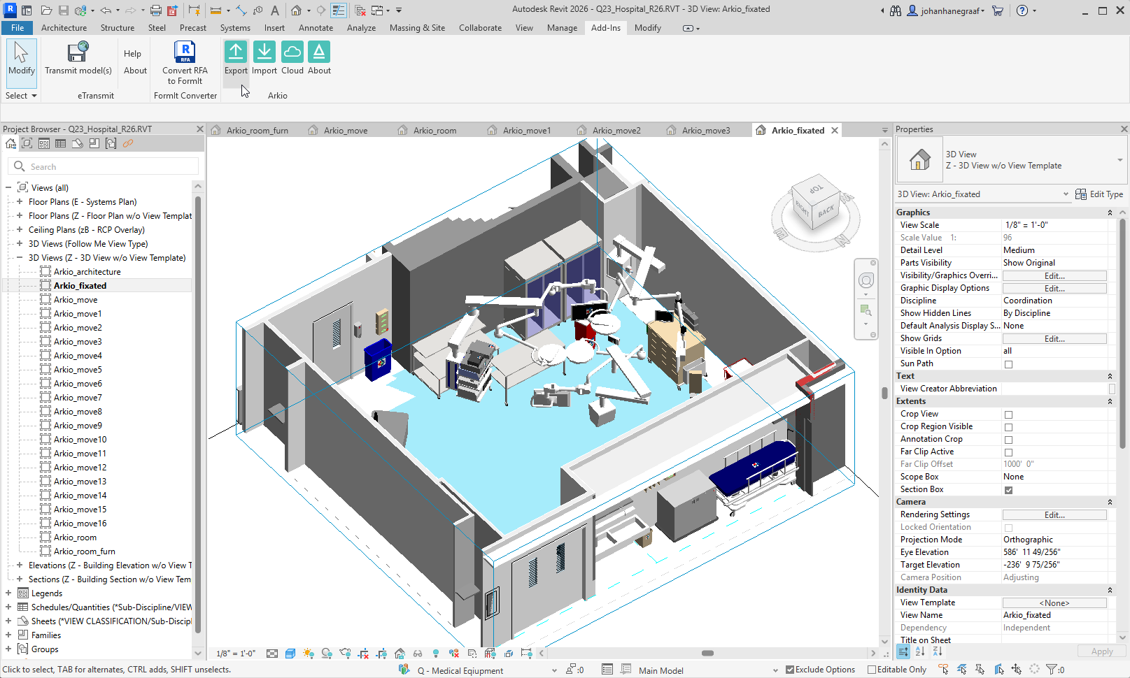

Step 1 - Prepare fixed objects 3D view
Objects that don't need to move in Arkio can all be combined in one single 3D view to be exported in one go to Arkio. This 3D view filtering can be done by creating a section box around the space you want to export, then filtering out the individual objects or categories you want to move.

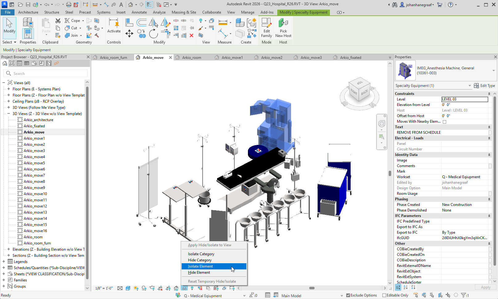

Step 2 - Prepare the movable objects in separate 3D views

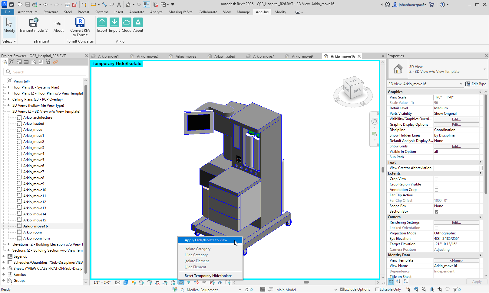

Objects that need to move individually in Arkio can be separated in a single 3D view. You can first make a master 3D view with all your movable objects visible in your section box, and then make a number of duplicates of this view where you can Hide-Isolate the individual objects belonging together (Shortcut HI) and then apply that temporary hide to the view.

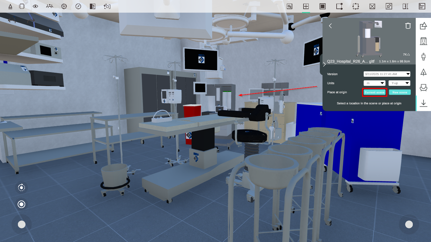

Step 4 - Place the exported Revit families in Arkio at the current scene origin
The final step loads the instances as individual objects to Arkio on the same coordinates. Here you can unpin/pin, move, copy, or apply other Arkio edit operations to your geometry. You can host a meeting with your VR headset or other devices to share your scene and work on these objects together.
