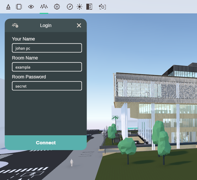

When joining a meeting, the following details need to be filled in:
Your Name - your name that will be displayed for other users in the meeting
Room Name - A meeting name to share with other people (needs to be at least 3 letters)
Room Password  - (optional) A password to access this meeting for login security
All users must enter the same Name and Password to join the same meeting. (non-case sensitive)

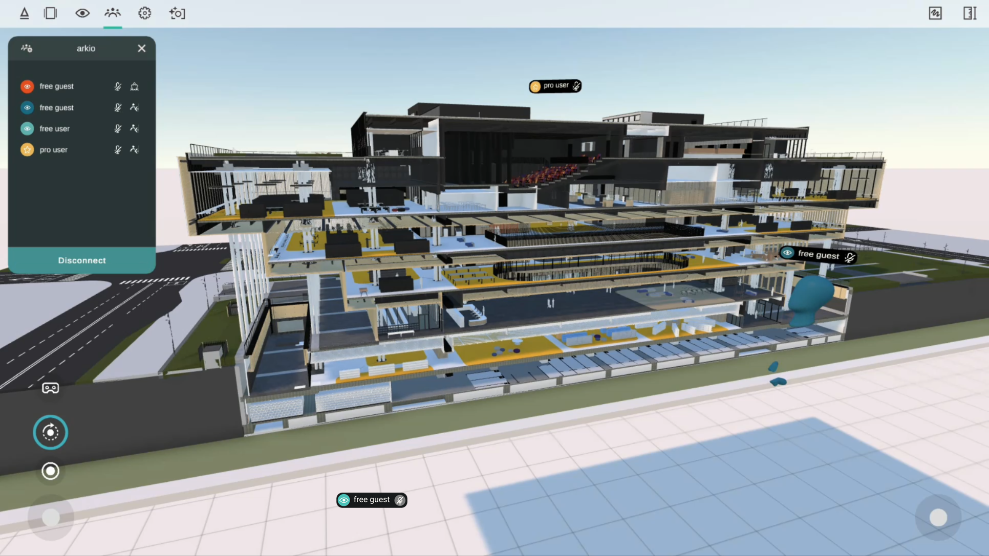

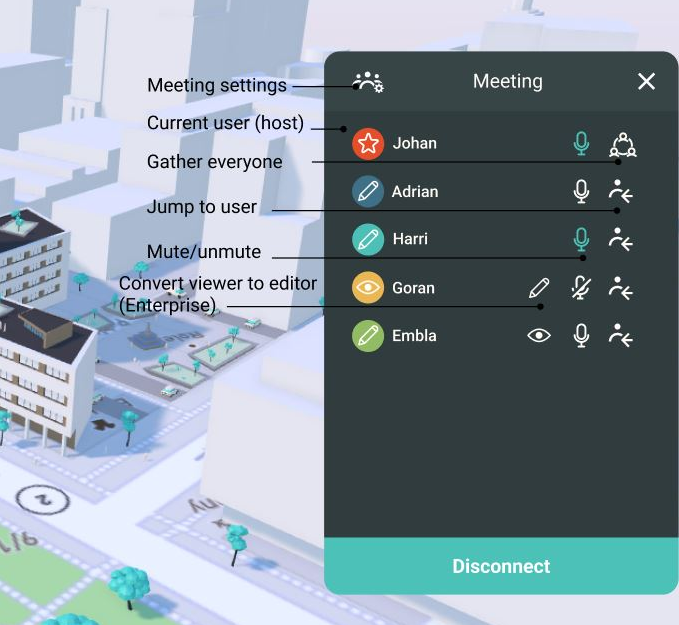

The first user to join a meeting becomes the meeting host, who manages the meeting and switches between scenes. All active participants in a meeting will be visible in the multi-user panel and in the scene, with each user's color and name tag.

You can mute yourself by selecting the microphone icon behind your name. If you don't see your mic icon light up while talking, your microphone is likely not set up correctly. This can be changed in the meeting settings. You can also gather users and jump to other users.

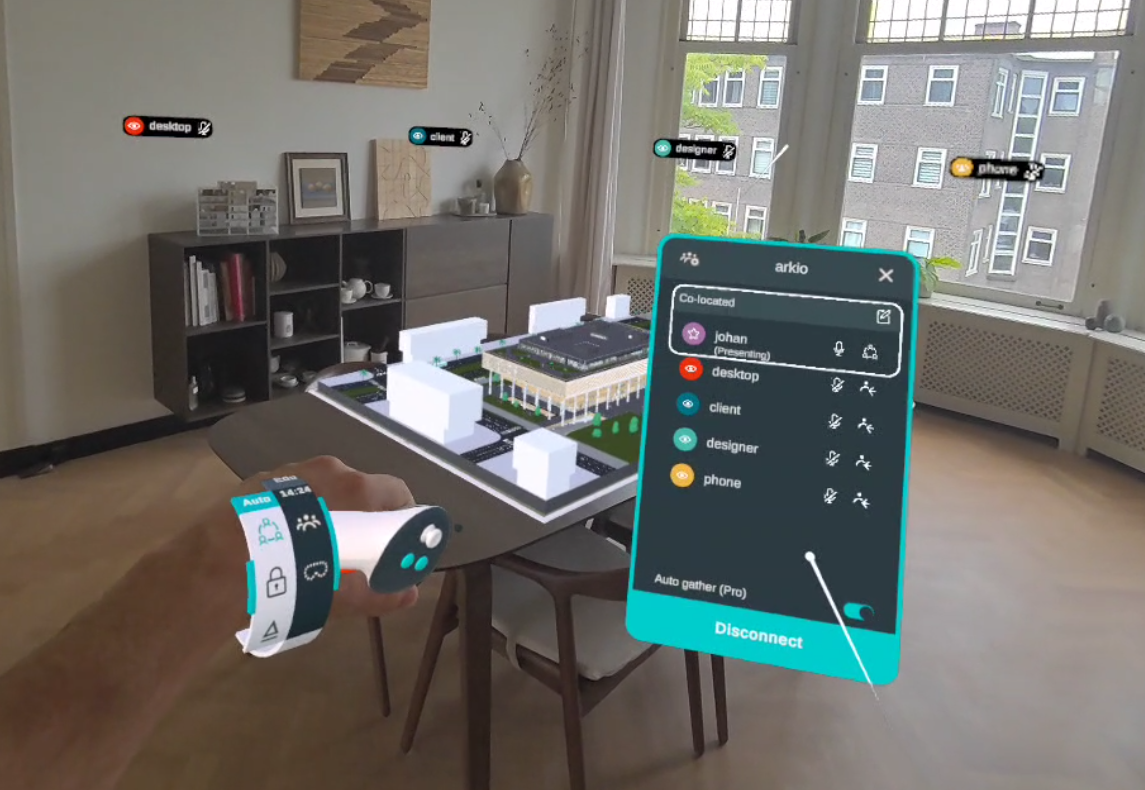

The host and other VR guest in the meeting can use their wristband to access the main meeting tools. There is a button to open the meeting panel, which also indicates whether your mic is inactive. And you can also (auto) gather all users, lock the scene for colocated mixed reality, or jump to the host.

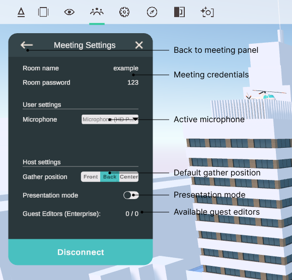

Additional meeting settings
In the Meeting Settings tab, you can find additional settings, including your microphone and the name/password for your meeting. You can also set the default way you want to gather users around you to streamline guided tours. This allows you to gather everyone in the meeting (VR and non-VR) to face you from the back, to form a circle in front of you, or to gather centered on your current position.
