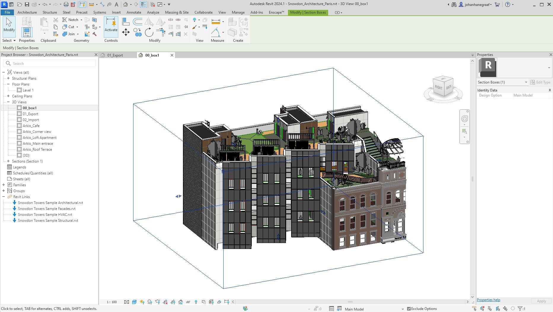

Section box
The easiest way to control your export is to use the built-in section box tool in Revit, which limits the export to objects within the section box bounds. Using the section box, you can easily prepare several saved views with smaller sections of your model. If you want to load extremely large files in Arkio, it can help to reduce the model per building, wing, atrium, or courtyard, so you can see more detailed geometry on devices with limited rendering budgets.
It can also help troubleshoot geometry that might cause import/export issues: pick a part of the building you suspect has geometry that might cause issues, and first create a smaller section box around the model to see what parts of the model still load.
Often, geometry far from the origin of your modeling software can cause export issues, so creating a section box around the main building can address that. Far-away geometry can also cause other issues in your original modeling tool, so it's best to fix this before it affects your model performance.
If you have issues loading a model, it helps to break the building into smaller fragments to see which parts still load well. When a part of the building does not load, you can further narrow the section box to identify the exact geometry causing the issue.

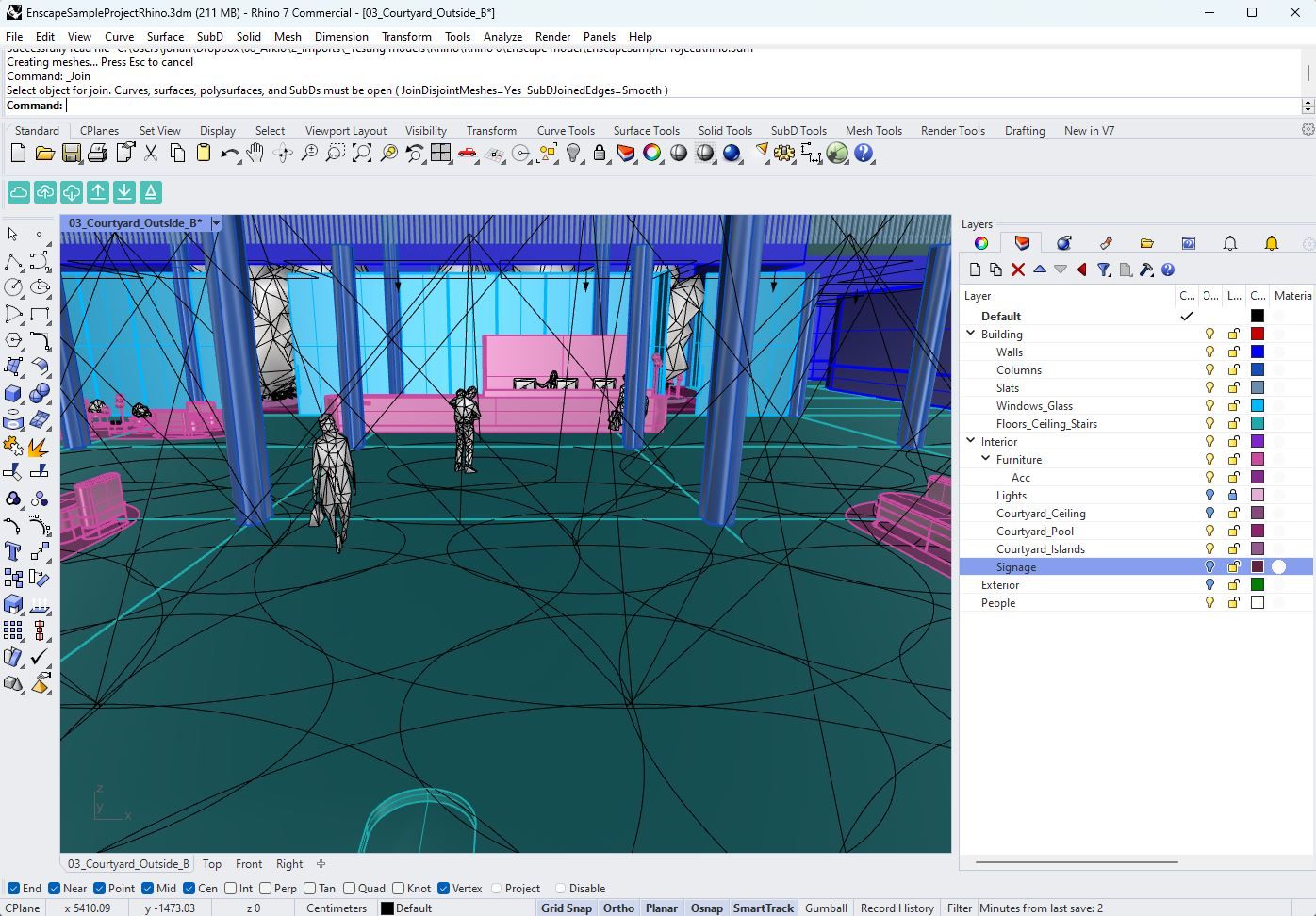

Worksets, layers, (sub)categories
When working with CAD/BIM tools, you often organize your geometry by Workset/Categories (Revit), Layers (Rhino), Tags (Sketchup), and Hierarchy (Unity). You can disable many of the objects you don't need before exporting to Arkio to simplify the export for mobile devices and troubleshoot which geometry might be causing issues.

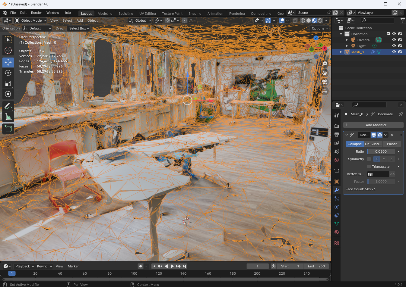

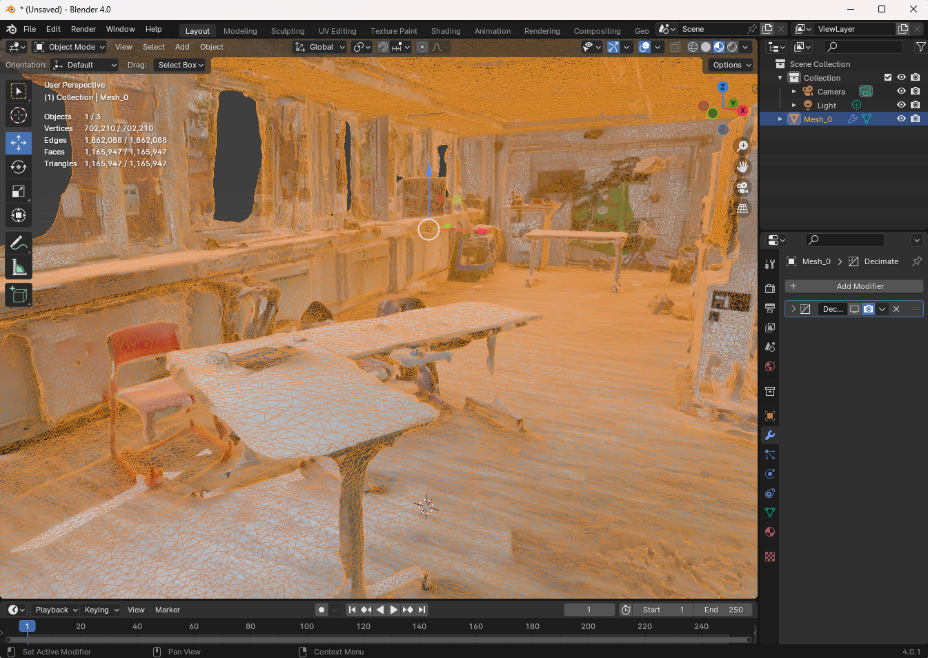

If your model has too many triangles and you are not using Arkio's plugins to optimize and export your 3D view, you can optimize your mesh models manually using 3D mesh editing software like Blender, 3D Studio Max or mesh optimization tools like Simplygon.
Using Blender, you can import the mesh and apply a "Decimate" modifier to easily reduce your geometry up to 5% of its original size. After applying this modifier and exporting your geometry to GLB, these optimized models can be loaded to Arkio to better fit your device's render budgets (see Importing large 3D models)
Files exported from other modeling tools can be several million triangles, so the import process can take a while in these tools, but the triangle stats and wireframes can directly point you to unneeded dense geometry in the model and allow you to optimize the model before loading it to Arkio.
You can find tutorials online on how to optimize your 3D mesh files, which require some knowledge of the tools mentioned above.

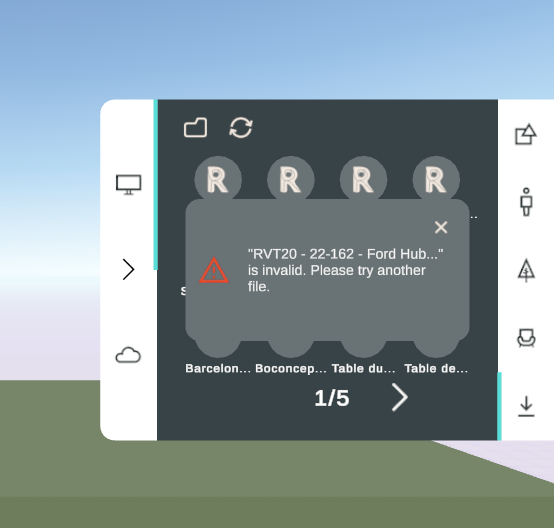

Models not loading in Arkio
When a model cannot be loaded in Arkio, there may be an issue with the model's data or Arkio’s importer. You can try the following troubleshooting steps:
1) See if your source file for Arkio to process in your Documents/Arkio/Import models still loads correctly in online viewers or tools like Blender.
2) Sometimes, failing imports affect other files from loading. Clearing your temporary resources often resolves most issues.
3) Try exporting fewer elements first by hiding most elements, then gradually increasing the number of objects to see if the issue persists.
4) Contact us at support@arkio.is if you have a model that does not load well, as we love to learn about this to improve Arkio’s importers.
