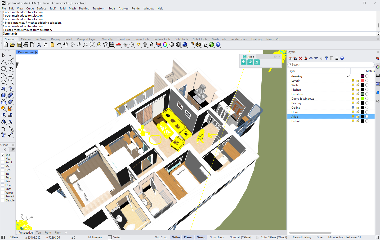

To export models from Rhino, you must have the Arkio plugin installed and open Rhino in a 3D view with the elements you want to export visible. Then, press the Arkio > Export button. If you don't see the Arkio buttons/toolbar, install Arkio on your PC or enable them by right-clicking your toolbar. (A restart of Rhino might be needed after a first installation)

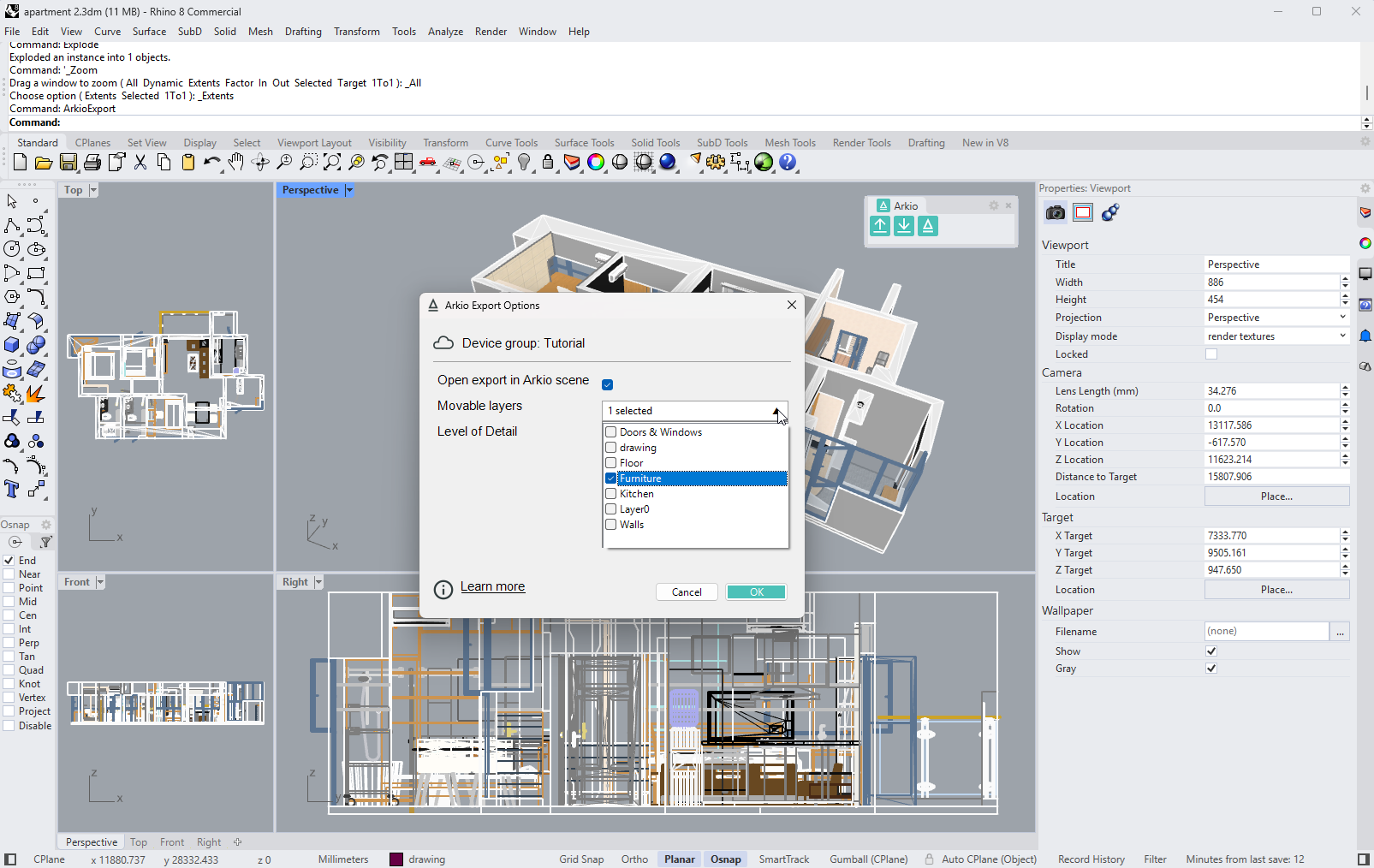

Clicking "Export to Arkio" opens an export menu with settings for preparing your current 3D view for Arkio. You can control whether your Rhino file directly opens in a new Arkio scene. Select which Rhino blocks, by layer, will be converted into movable objects, and control the level of detail for your export. You can reduce the detail of 3D models for mobile devices by selecting a lower LOD and clicking OK to confirm.

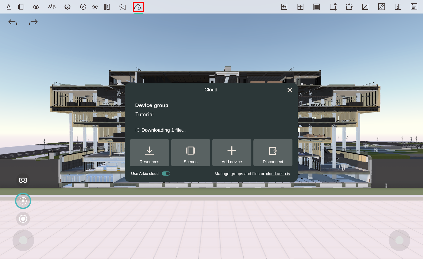

After you place the imports on one device, you can start a live meeting with your other device to share the scene, including all imported geometry. You can also link your PC to the same Arkio Cloud to automatically synchronize new imports to your other devices.

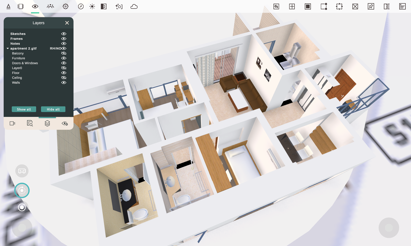

Your Rhino-exported files contain layer information in Arkio that is mapped to the (flattened) layer information in your Rhino project. If you would like to have more control over your Layers in Arkio, for example, to present your design options, you can make changes to your layers and then re-export your model.
You can export different Rhino models into one Arkio scene (and models from other supported design tools) and load them at the exact origin to gain additional control over layers in your scene, as you can control the visibility of all loaded files separately.

Rhino blocks, with the layer selected as movable in the export settings, are converted into individual movable objects in Arkio. These objects can be moved, duplicated, deleted, edited, and painted like any other objects in Arkio. In your view settings, statistics, you can see how many movable objects are in your scene.

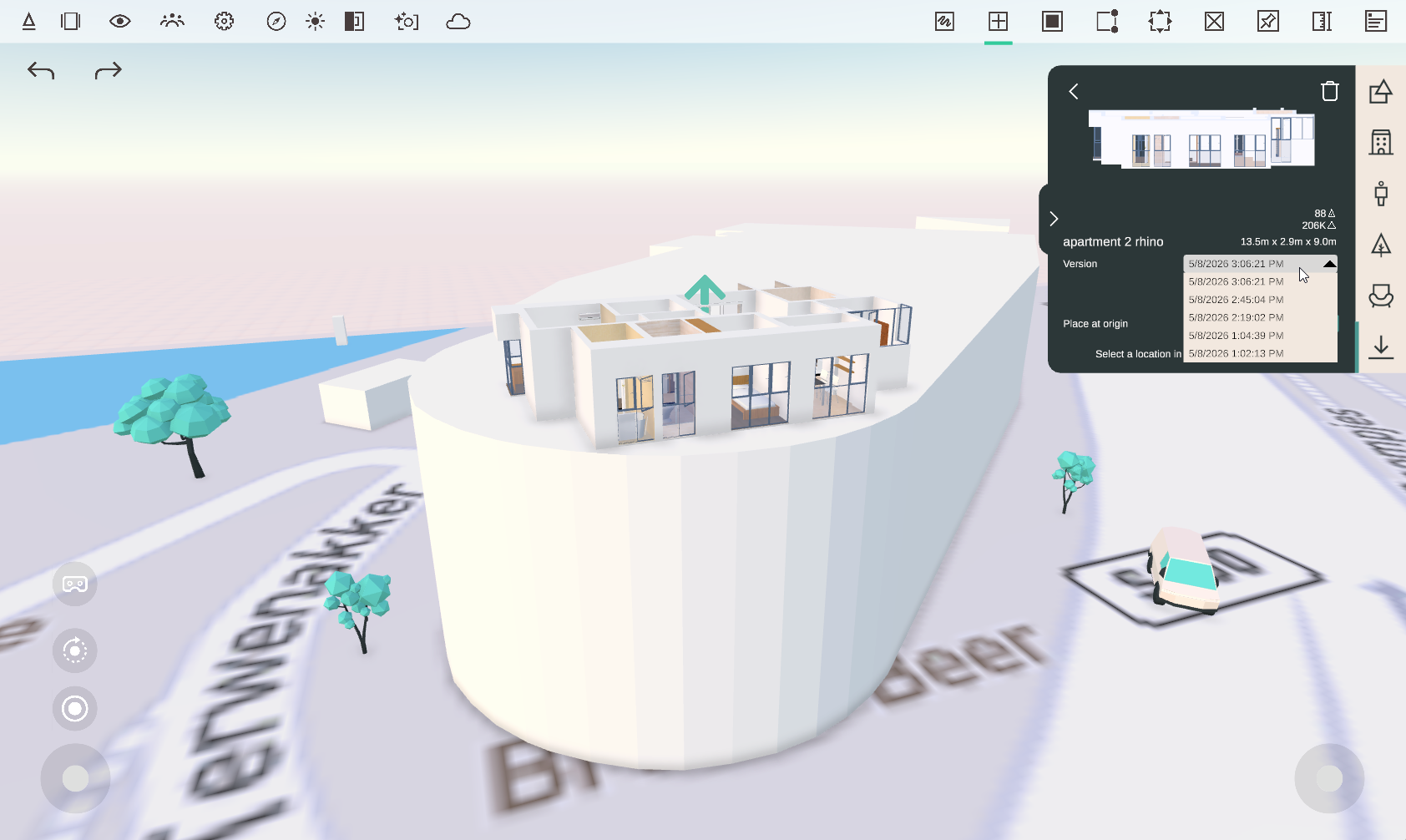

You can update an existing imported model by overwriting the model with the same name. In Rhino, you can export the same file again to make a green arrow appear in Arkio above your current model, indicating that a new version is available. You can click this arrow to replace the older file in the scene with the new version on the same coordinates.
Arkio will retain older versions of your imported models, allowing you to revert to a previous version by selecting the desired date in your import preview menu and clicking "Update".

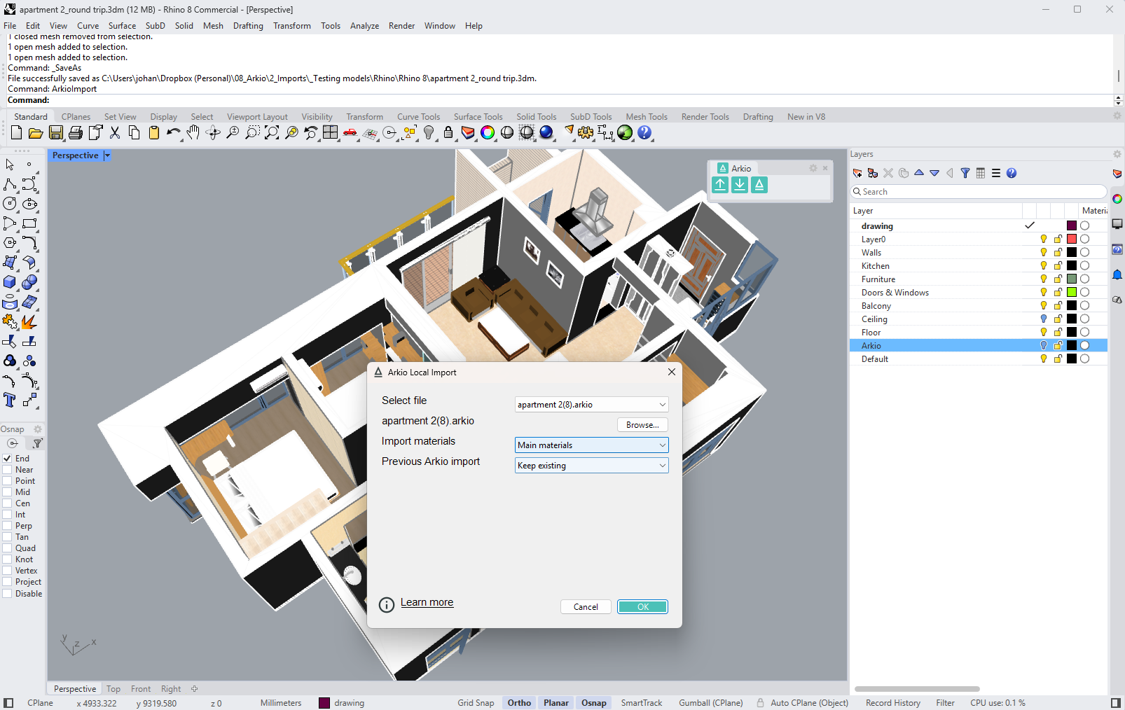

Arkio scenes can be exported by opening your File browser and selecting the desired export format. Your scene will export locally and via the Arkio Cloud. You can then connect Arkio on your PC to the same cloud device group to automatically sync the latest exports to your PC \Documents\Arkio\Export\Rhino folder and import the file to Rhino using the import button.
In Rhino, the import settings allow you to select the latest available Arkio exports on your PC. From this panel, you can also control whether to bring in your Rhino import with its materials or erase any previous Arkio imports.
All newly added geometry in Rhino will be assigned to the Arkio layer for easier filtering, and movable objects that were moved out of their original positions in Arkio will be imported back as new elements. From these elements, you can move your original objects or make any final changes before repeating the process and loading them back into Arkio for your next collaborative design session! :)
