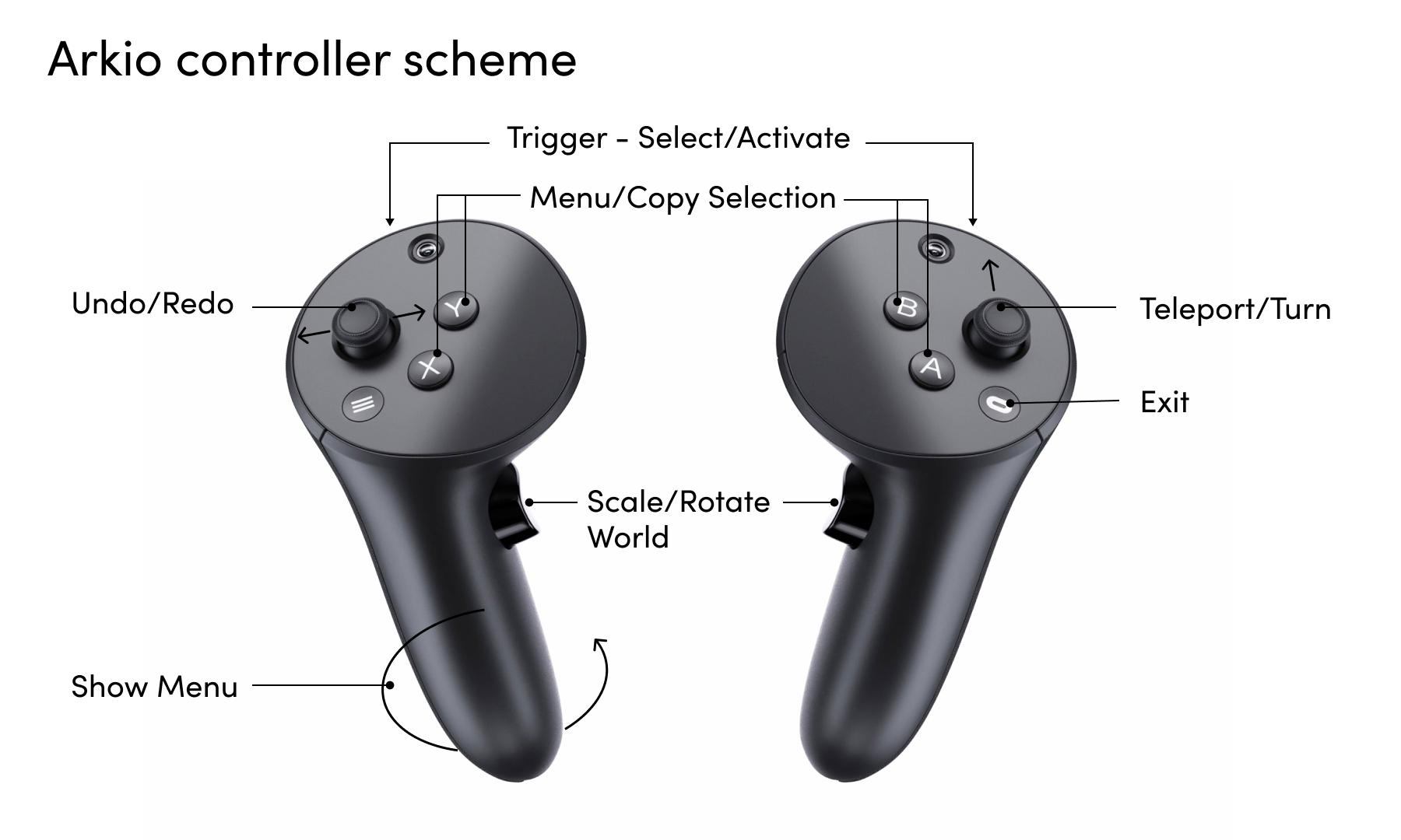

All tools are primarily used by pointing the laser at the object you wish to interact with and pulling the trigger. Some tools have a secondary action that is triggered by pressing an action button whilst the trigger is held down (e.g., duplicate). When a component is moved, it can also be rotated by pressing the touchpad or moving the joystick left or right.
To navigate around, use the grip buttons on the side of your controllers for panning, scaling, and rotating the scene, and the right thumbstick forward will teleport you to 1:1 scale in the scene or back to god scale when pointed up towards the sky.
If you place your grab point (the black dot in front of the controller) within a shape, you can grab the shape or edit its features by selecting its face, edge, or corner.
Undo/redo is on the left controller, activated by moving the joystick left or right, or, on a touchpad, by pressing the touchpad left or right.
There are three ways to use the main menu:
  1. Twist the left controller outwards so your palm is facing up to open the menu, twist the controller inwards so your palm is facing down again to close the menu
  2. Press one of the blue buttons on the controller quickly to open the menu in front of you in a fixed position
  3. Press and hold the blue button - select a tool by simply hovering the 8 main tools in the tool circle or hovering the other tools, and use the trigger to activate those tools or menus

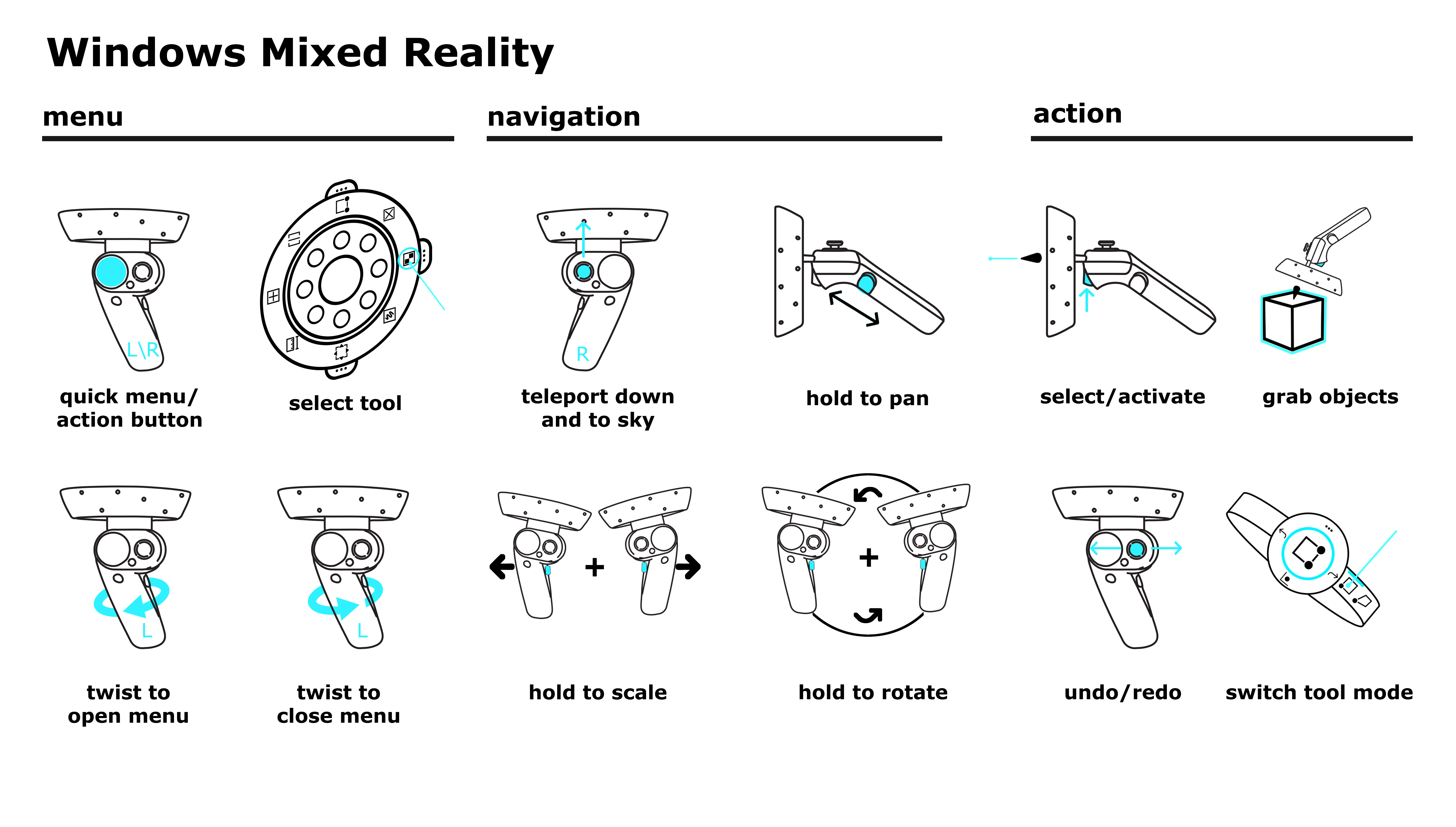

Windows Mixed Reality controllers are similar to Meta Quest controllers and feature both a joystick and a touchpad for quick menus and secondary modeling actions.
