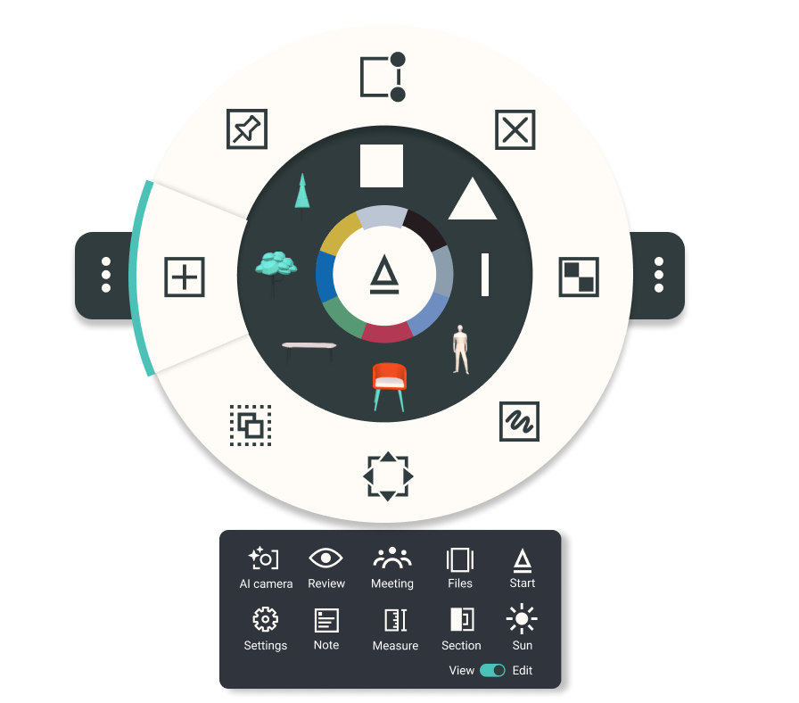

Favorites
The first ring of Arkio's Main Menu serves as a favorites palette, allowing you to drag and drop your favorite objects and colors from the corresponding drawers. The outer ring contains all the primary editing tools, where an outline shows the active tool for that controller. The inner ring acts as a shortcut to your favorite paint materials for newly created primitive shapes.
Main Tools
You can use the laser to select a tool by aiming at the icon and pulling the trigger, or by physically touching the menu button with your index finger while using hand-tracking. From the top, clockwise, the primary editing tools are:
Edit - Edit faces, edges and points to stretch or scale the shapes - toggle between orthogonal edits and freeform edits from your wristband
Delete - Delete objects - toggle between the full object or individual faces on your wristband
Paint - Apply materials - toggle between the full object or individual faces on your wristband
Sketch - Draw a free-form sketch on any existing surface in Arkio - toggle between sketching 3D or 2D surfaces on your wristband
Move - Pick up and move objects and their children with the laser - You can rotate and duplicate the held object by pressing the thumbstick or green menu button.
Group - Group objects together by drawing a selection cube around the object
Create - Create new geometry and objects based on the selected primitive or asset - toggle between creating a normal one-layer shape or a multi-level stack from your wristband
Pin - Pin objects in the scene to disable moving/editing/deleting of the objects
