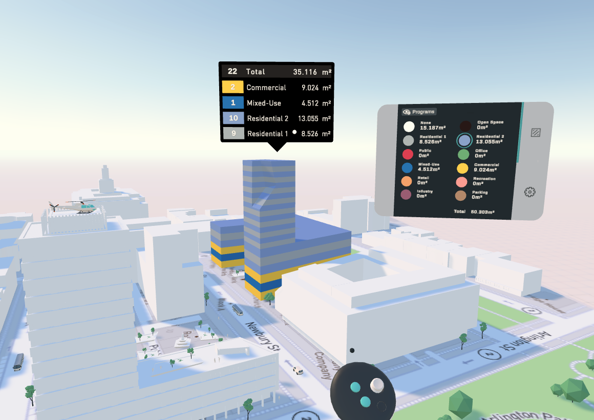

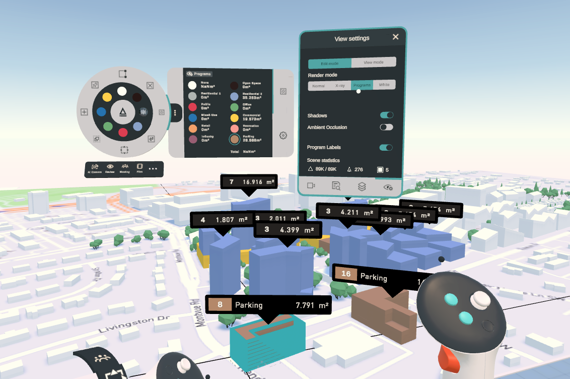

The program mode can be activated from the paint tool, where you can switch between render modes using the View settings shortcut to assign program data to your volumes. Switching render modes changes your pain icon in the main menu, allowing you to see which mode is currently active. The window will let you model new programs using the create tool or apply new program categories to existing shapes using the paint tool.
While the Program mode is active, all your Arkio volumes in the scene will default to none (white), and you can choose any of the predefined categories in your scene. You can also load your own program categories and generate volumes into the scene using a custom CSV file.
All shapes created or painted with a program material will display a label above them or in stacks of shapes. You can minimize individual labels in the scene by clicking on them.

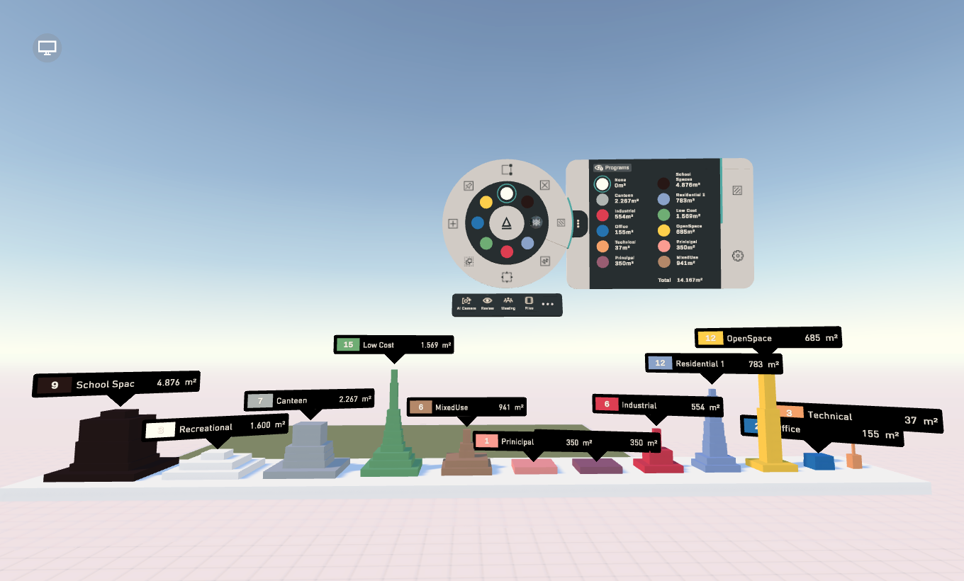

Once loaded, you'll see all your program shapes in front of the table, organized into stacks of your chosen categories. You can then move them to the worktable to arrange and glue your programs in place.
