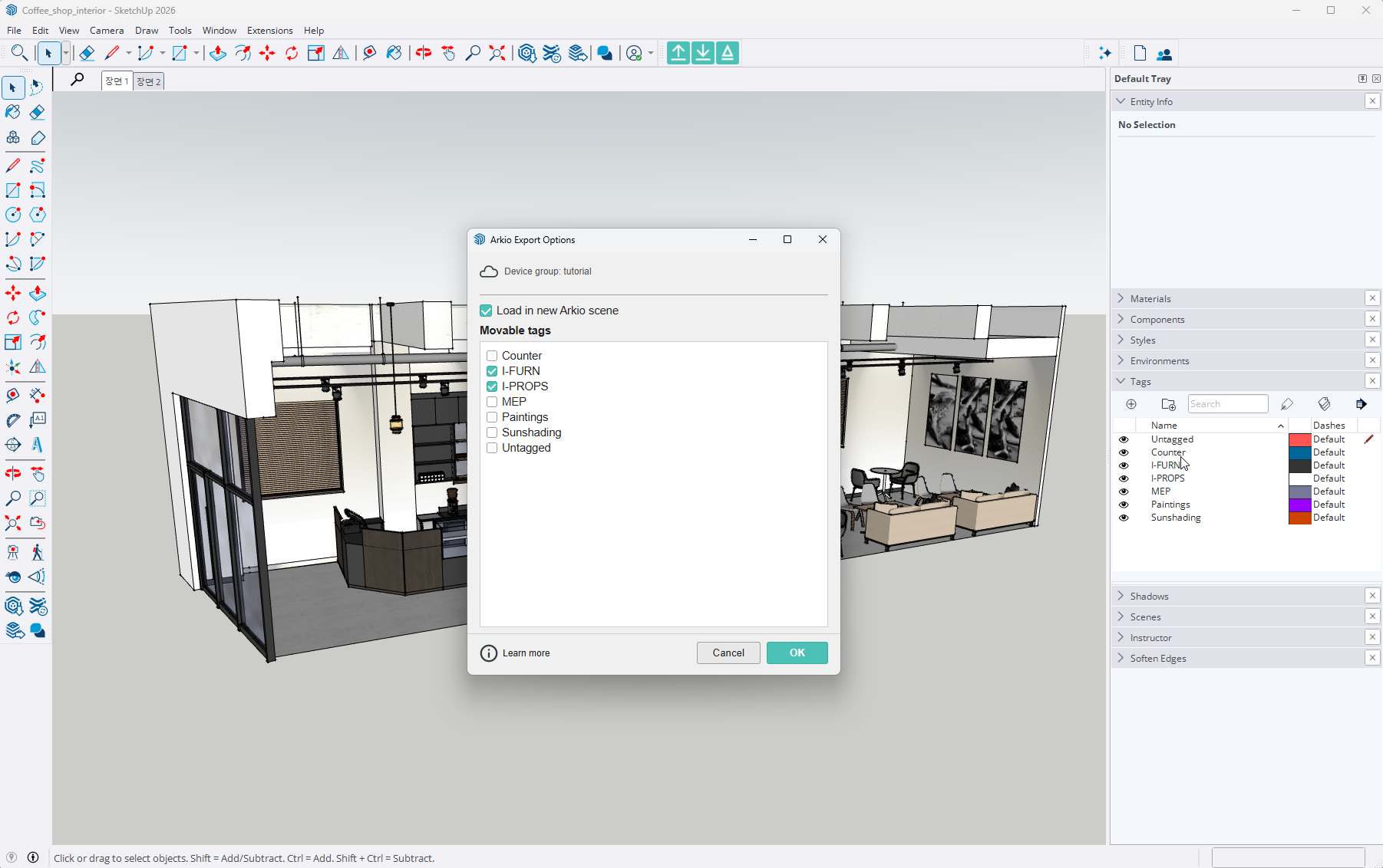

To export models from SketchUp, you must have Arkio installed on your Windows device and open SketchUp in a 3D view with all the elements you want to export visible. Then, press the Arkio > Export button. If you don't see the Arkio buttons, install Arkio on your PC first, or enable the buttons by right-clicking your toolbar.
This opens an export menu with settings for preparing your current 3D view for Arkio. You can control whether your Sketchup project directly opens in a new Arkio scene. Select which Sketchup components and groups will be converted into movable objects and click OK to confirm. If the model is large, you will receive a notification that your export may take longer. If that is the case, you can best start by saving your work or grabbing a coffee! :)

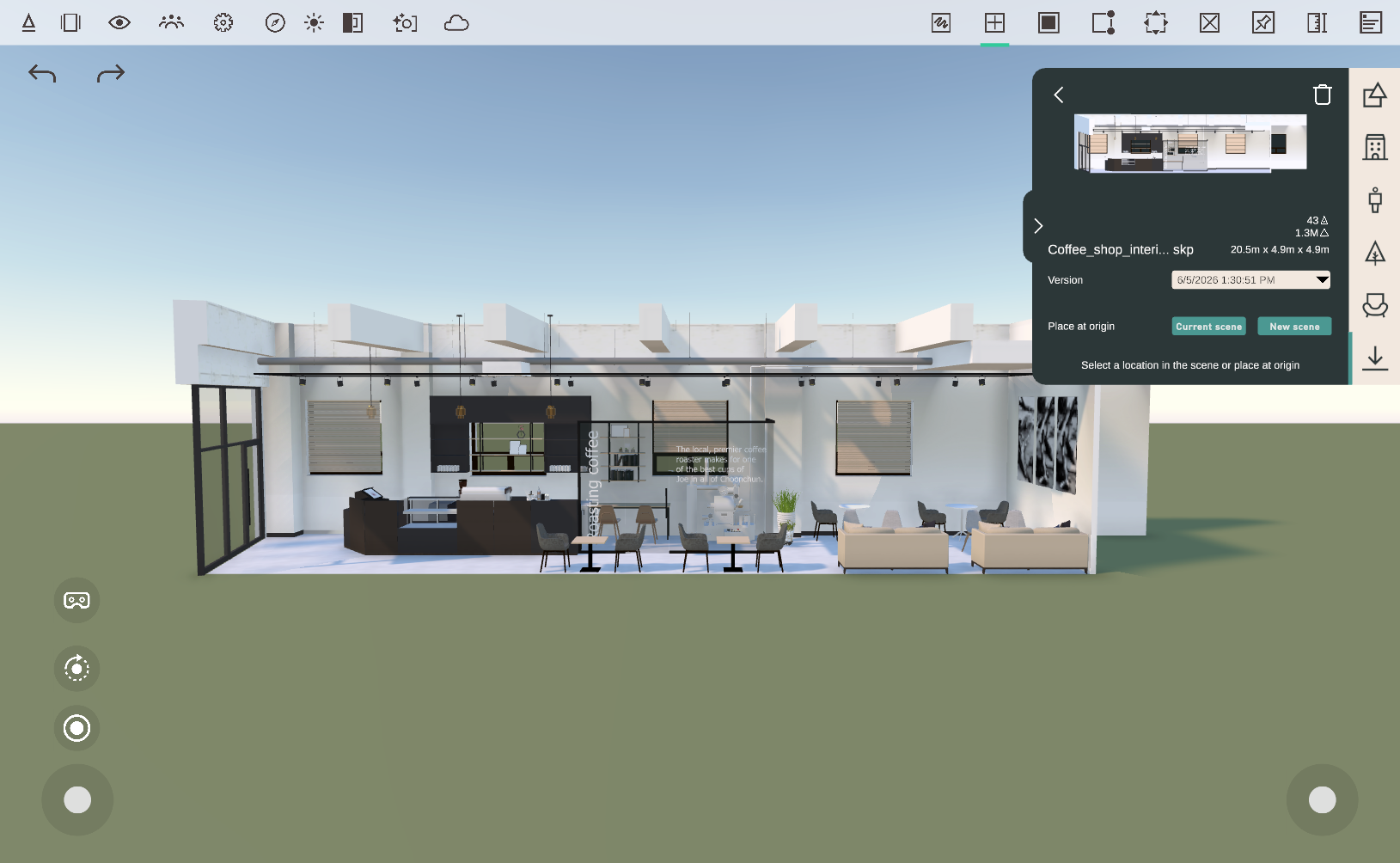

All files imported to Arkio or synced via the cloud will show in your Create > Import drawer. You can sort these imported resources by name, date, or type and click the file to open a preview with placement settings for that resource. In your model preview tab, you can see the number of triangles and movable elements for that imported object.
With the placement tab open, you can click anywhere in the scene to manually place an instance of that model. Or press the green Place at origin buttons to place the modelpinned in the current scene or a new one. Models placed at the origin can be aligned with other models, enabling a round trip between your design tools when exporting Arkio-added geometry back to your existing tools.

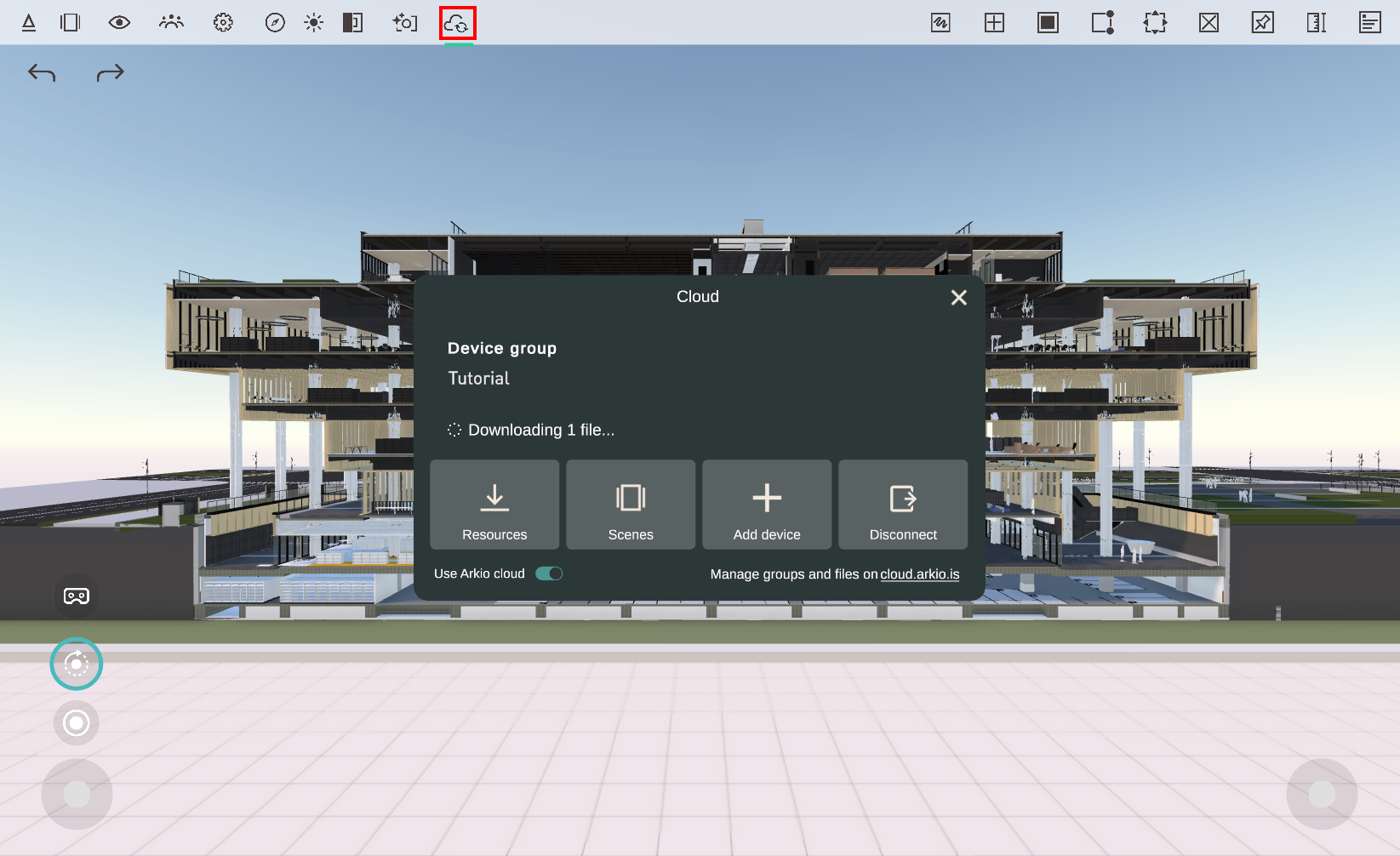

After you place the imports on one device, you can start a live meeting with your other device to share the scene, including all imported geometry. You can also link your PC to the same Arkio Cloud to automatically synchronize new imports to your other devices.

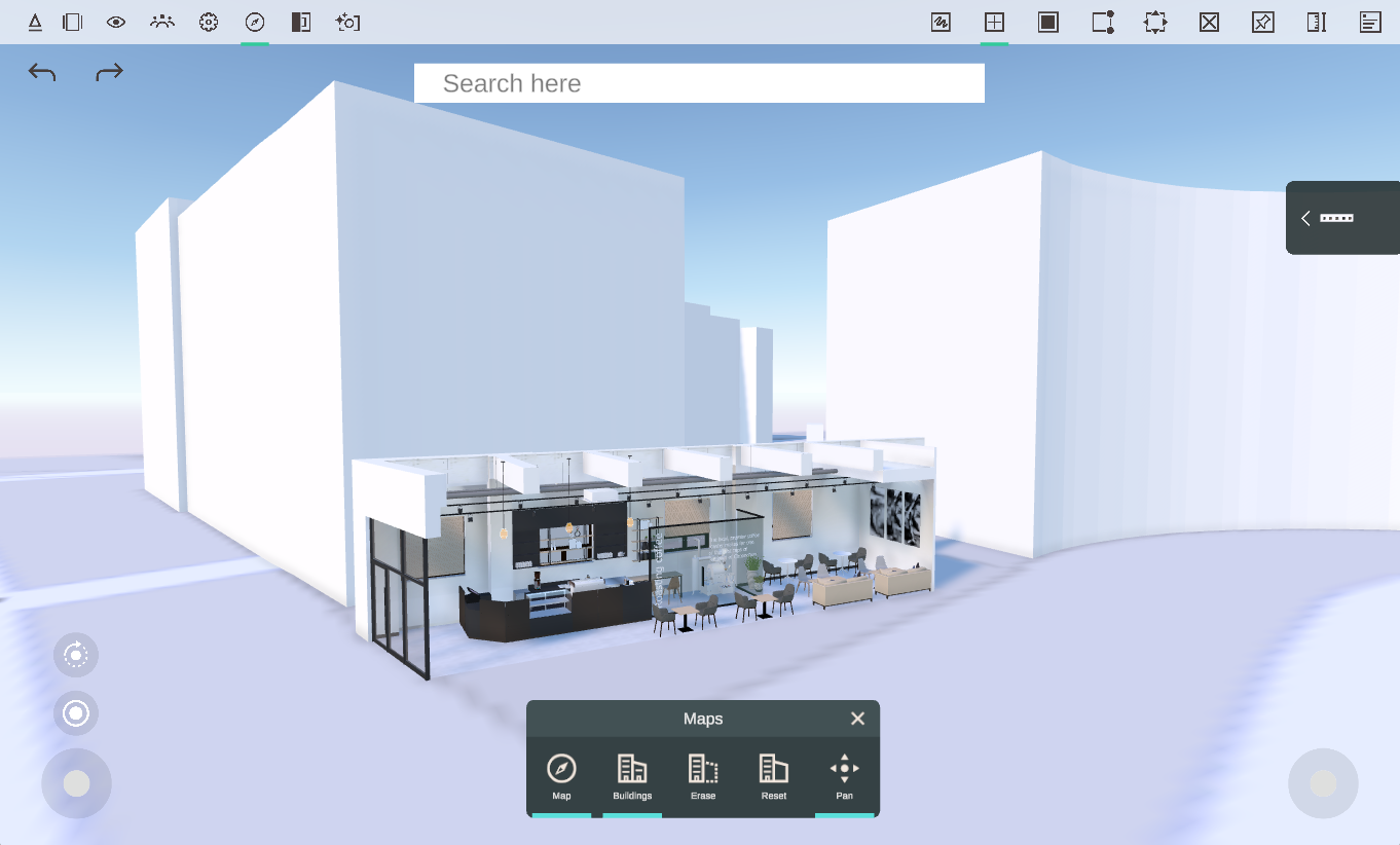

SketchUp's origin will be used for placement. From that placement, you can use the map feature to load a site around your design and enable more precise sun studies for your project.

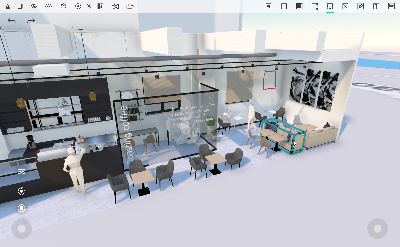

Movable objects

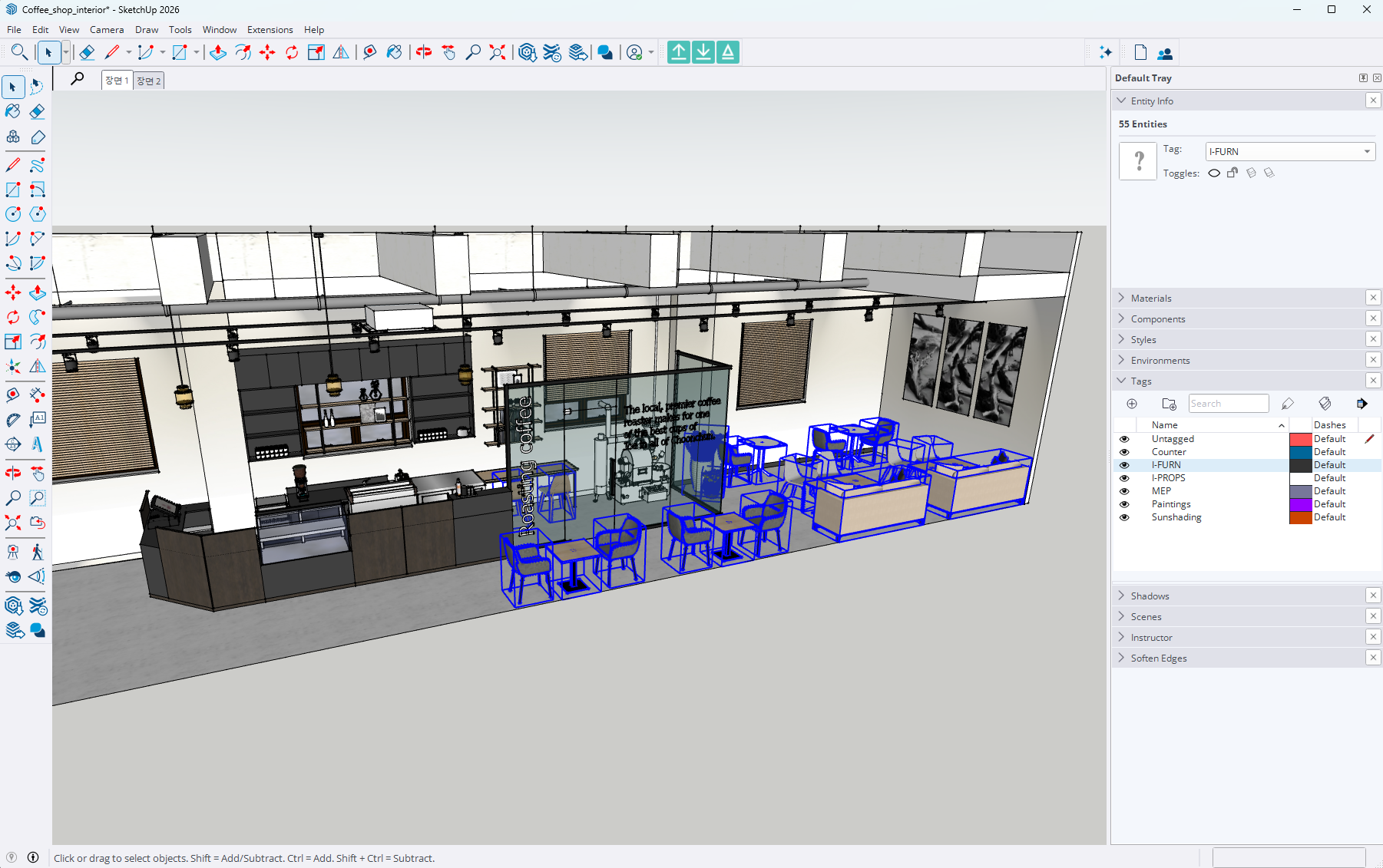

Sketchup components and groups can be exported as movable objects by assigning a tag to the parent component and selecting that tag in the export settings. This will convert those components and groups into individual movable objects in Arkio that can be moved, duplicated, deleted, edited, and painted like any other object.
Objects that are moved outside their original origin position will be exported back into your design tool to enable round trips, along with all newly added Arkio geometry and sketches. Cross-tool workflows are also supported, so you can convert movable Rhino blocks or SketchUp components to Revit families.

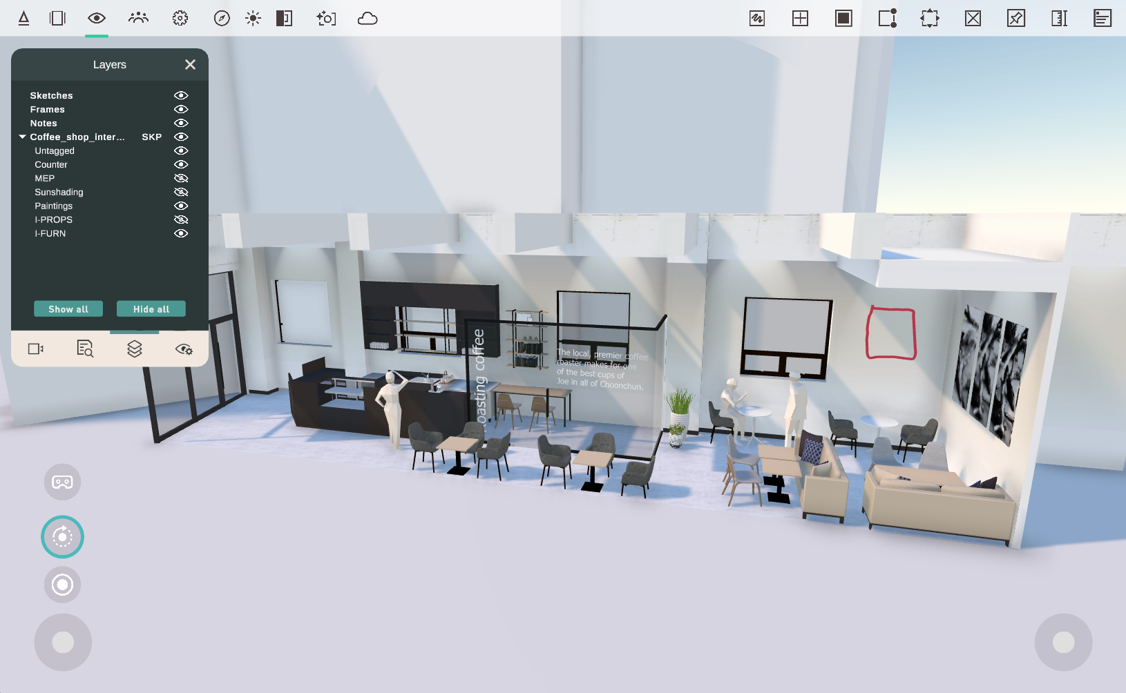

Layers
Your SketchUp parent geometry, group or components Tags will be mapped to layers in Arkio. Nested geometry with tags assigned in groups and components will use the tag of the parent group/component instead.
If you would like to have more control over your Layers in Arkio, for example, to present design options, you can make changes to your tags per entity and re-export your model or export your Sketchup model with a different file name to load it as a separate model in Arkio.
You can export different SketchUp models (and other supported design tools) into one Arkio scene and align them at the origin to gain additional control over layers in your scene, as you can control the visibility of all loaded files separately.

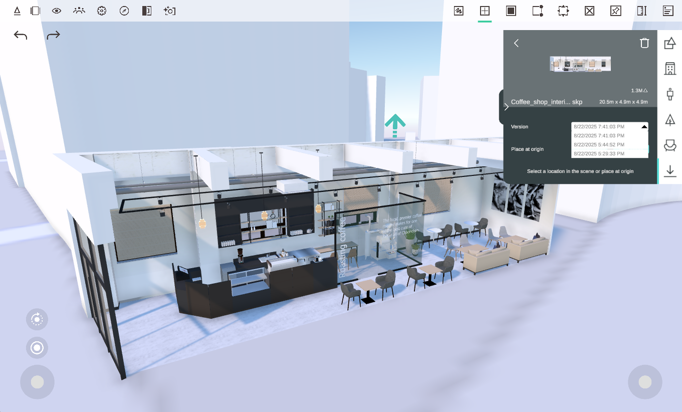

You can update an existing imported model by overwriting your Arkio import files with the same name. In SketchUp, this can be achieved by rerunning the export with the same filename. Arkio will then recognize and process the new version, displaying a green arrow above the model to indicate that a new version is available. You can click this arrow to replace the older file in the scene with the new version on the current coordinates.
Arkio will retain the older versions of your imported models, allowing you to also revert to a previous version by selecting the desired date in your menu and clicking "Update".

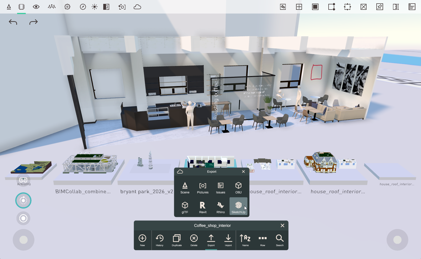

Arkio scenes can be exported to sketchup using your File browser and selecting the desired export format. Your scene will then be exported locally to your device and, if active, via the Arkio Cloud.

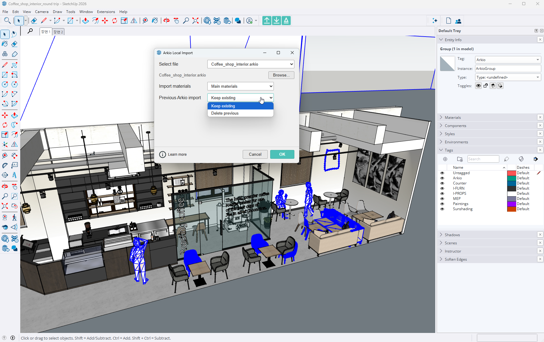

Once back in Sketchuo, you can import this Arkio file into your active project from Arkio > Import. This will open an import settings panel where you can select the file to import and configure the import settings. Arkio geometry will be imported using the Tag Arkio so you can easily filter out what’s imported.
Import settings
Select file - shows all available Arkio Sketchup exports on your PC. When you make an export from Arkio connected to the same cloud device group, the export you make with Arkio on other devices will also be synced to your PC when the Arkio PC app is running. The path to all your Arkio Sketchup exports on PC is Documents\Arkio\Export\SketchUp
You can also use Browse to manually select an .arkioexport file on your system.
Import materials - selects if you want to bring in all materials from your Arkio scene into your Revit project (main materials) or if you want to not bring in any materials (all white)
Previous Arkio Import - allows you to remove any previously imported Arkio files to clean up after multiple round-trips between Arkio and Sketchup and to prevent duplicate elements.
