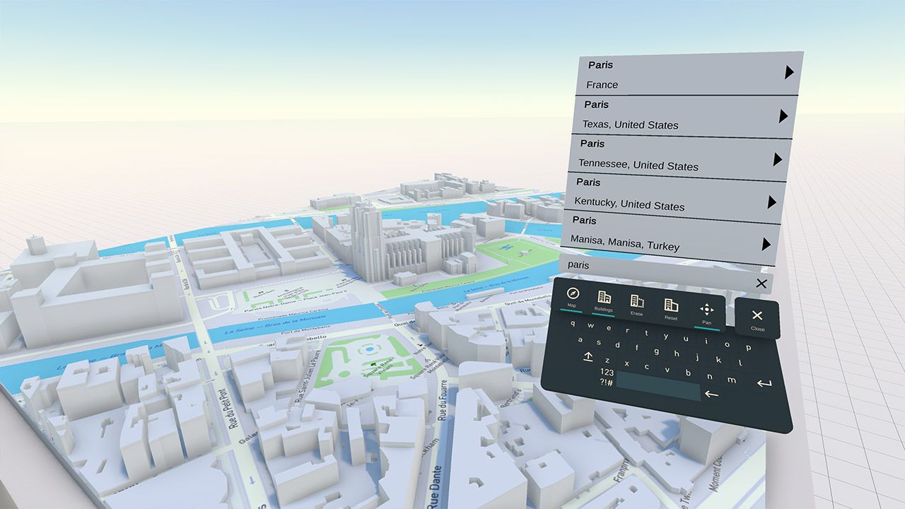

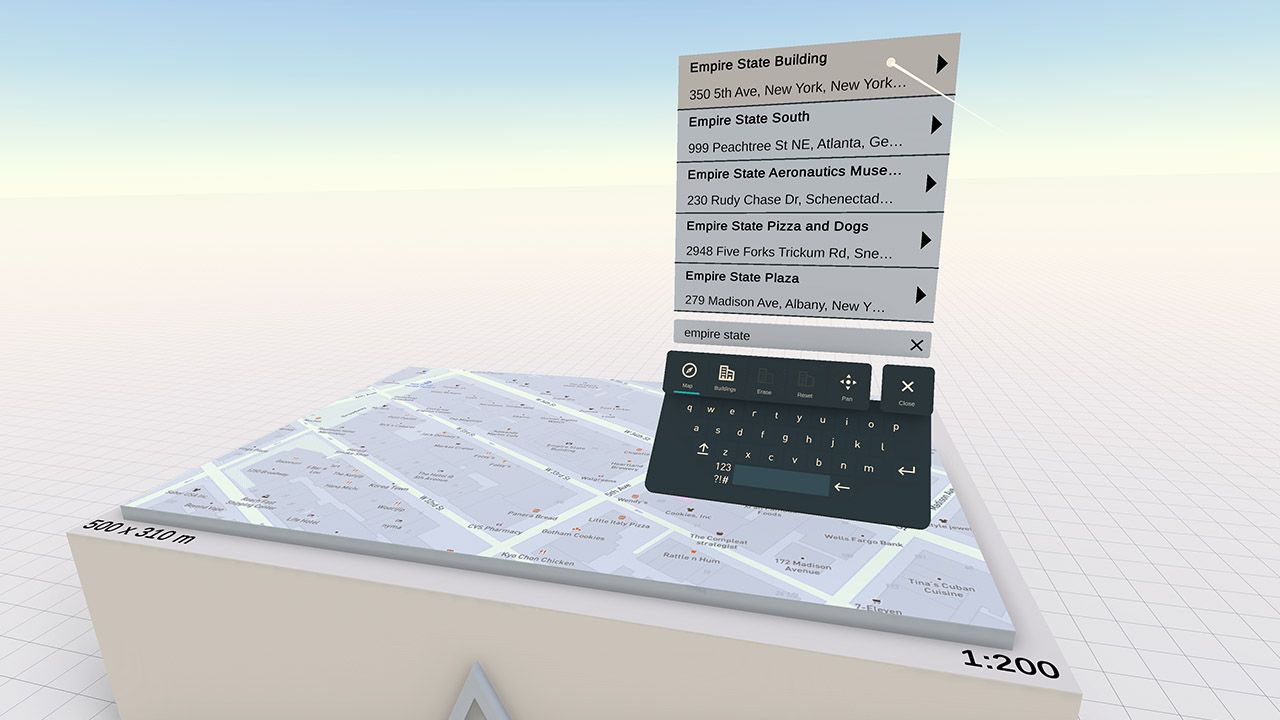

The Map tool can be accessed from the table UI in VR and the top tool ribbon on the flat version of Arkio. The keyboard can be used to search for any place or address in the world, and suggestions at the top can be clicked to load it into the table and update the sun's longitude and latitude accordingly.

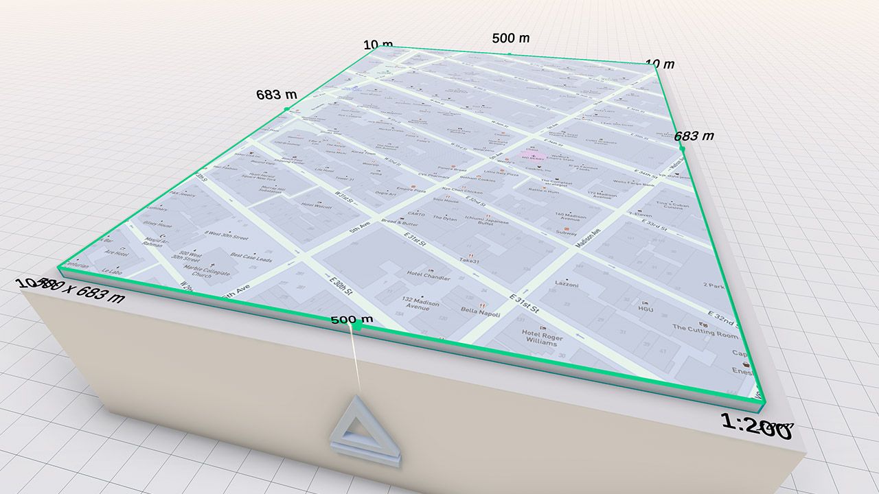

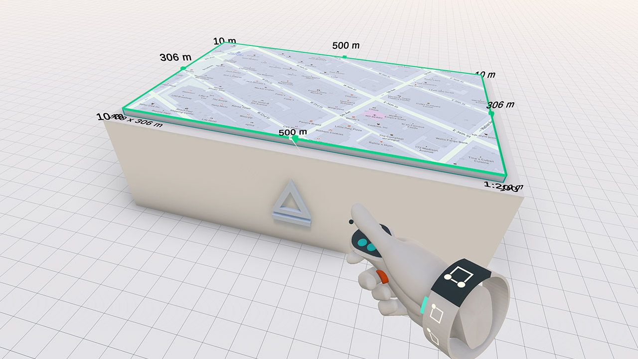

The map size and your Arkio working surface can be adjusted using the edit tool. Just hover your edit laser over the side of the table you want to resize, then drag the surface to make it bigger or smaller.

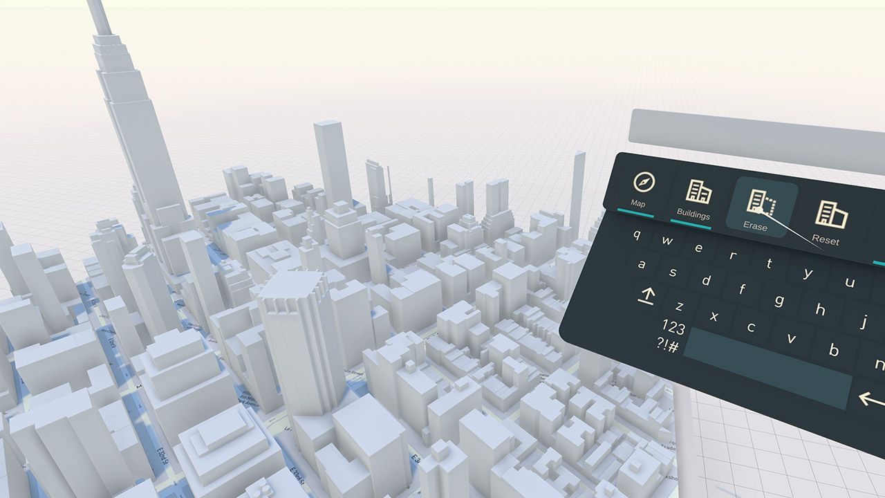

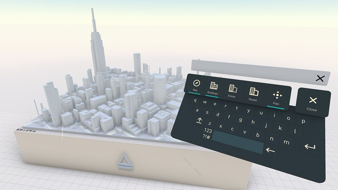

Arkio can generate 3D buildings using data from OpenStreetMaps. These 3D buildings can be activated by clicking the buildings tab in the map UI. Sometimes, 3D building height information is not available for that city on OSM. Buildings will then extrude with a default height of 3 meters (~10 feet). The OSM database is updated regularly, so you can expect more cities to become available in due time.
When your map is not in the correct position (e.g., you need to align it with your imported Revit model), you can update its location using the pan tool in the map interface. This will allow you to pan the map in the direction you like by grabbing it with your laser, mouse, or touch.

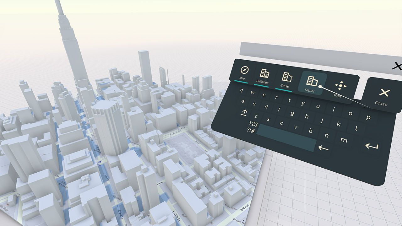

When a site needs to be cleared of existing 3D buildings that are still in the OpenStreetMaps Database, you can erase parts of the imported building by drawing a box around the buildings you would like to erase. You can create as many boxes as you need, and you can reset your erased buildings using the reset button.

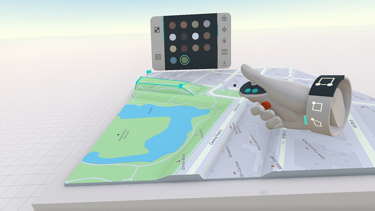

The Arkio table is flat by default, but by carving voids into the ground, the map will be projected onto them. This map projection can also be applied to other Arkio solid shapes. This allows the creation of simple sloped terrains in Arkio that might be required for your site's experience.
