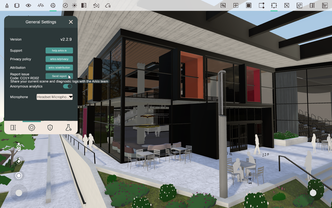

If you experience an issue in an installed Arkio 2.3 app, open General Settings and select Send Report. The report collects logs from the current run and scene, along with device information that helps us investigate the problem.
