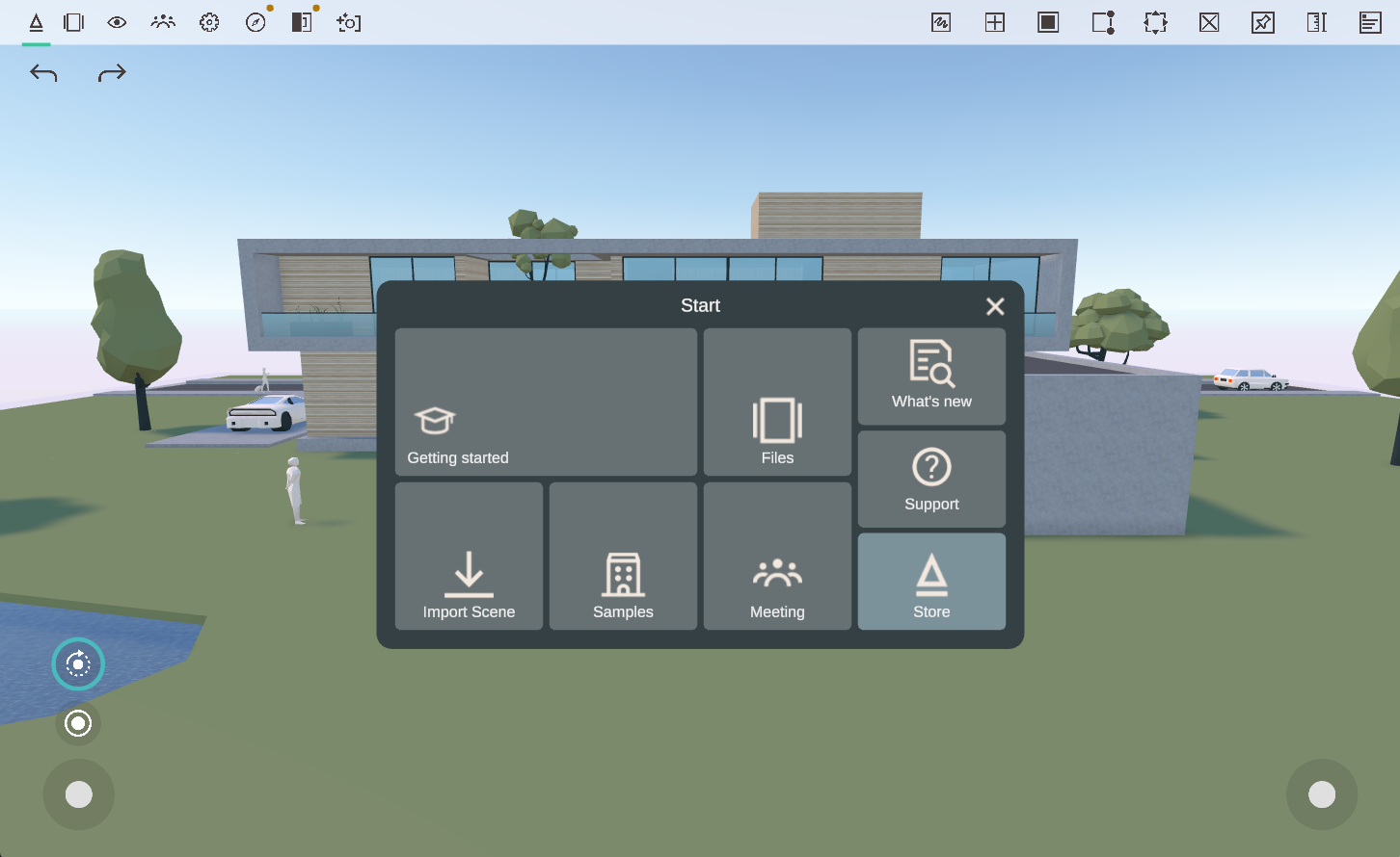

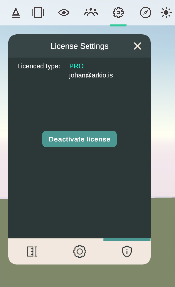

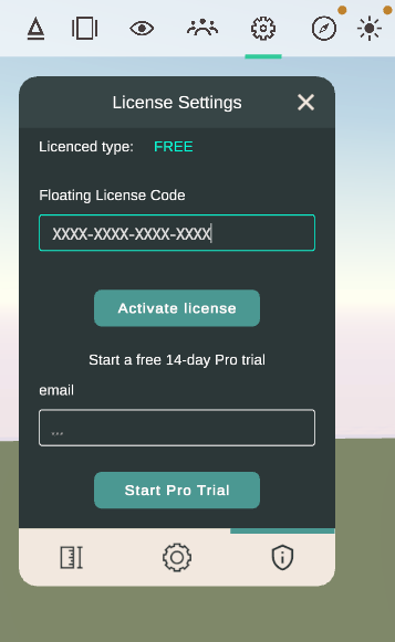

Copy your cross-platform license key and enter it in Settings > License in Arkio 2.3. An App Store subscription activates through the store account on your device and does not provide a cross-platform key.
For legacy licenses purchased through our website, the original order confirmation email contains the license code (1), a subscription-management link (2) and an invoice link (3). These codes are for the installed Arkio 2.3 apps.

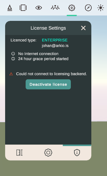

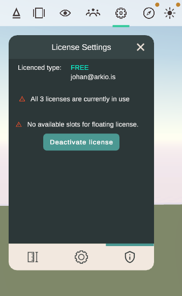

Legacy Pro keys can be activated on up to two devices. Legacy Enterprise keys use floating seats and can be added to multiple devices; a device takes an available seat when Arkio starts.
If all seats are in use, another device may show a No License notification in the interface or on the VR wristband. For a Pro key, deactivate it on a previous device before activating it on another. For an Enterprise key, wait for a floating seat to become available.
These screenshots show the legacy licensing interface. For the current availability of the installed apps during the transition, see Arkio 2.3 apps and transition information. If you already have a paid license, check its key and available devices or seats before purchasing another subscription.
A previously validated legacy license allows a 24-hour offline grace period. Reconnect to the internet to validate it again when that period expires. If an existing key still does not activate, contact support@arkio.is.
