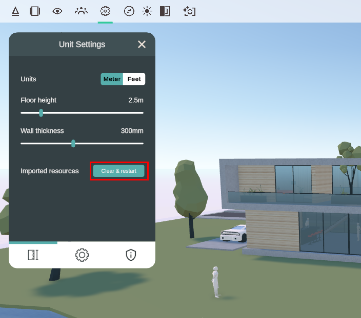

Temp resource files
If you experience problems with your imported/downloaded content, such as files not loading or your list of imported files behaving oddly. You can clear your temporary resource cache. On the next startup, Arkio will re-process all source files in your \Documents\Arkio\Import folder and redownload any models and images that have been shared with you in Arkio meetings, the cloud or scenes on your device. You can also unlink your Arkio cloud before doing this to prevent invalid models from being redownloaded and processed.
It's also possible to manually remove these resource files and the source import files from your device by clearing the files from the device paths at the bottom of this page.
