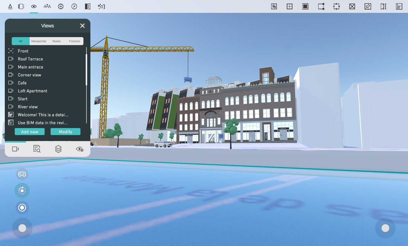

Saved views for the current scene can be accessed from your Review panel, located in the top ribbon in the flat version or the bottom menu in the VR version of Arkio. With the Review panel open, you can view a list of all previously saved viewpoints for your scene, as well as an overview of all your placed Notes and Frames in the scene that can be filtered using the top buttons.

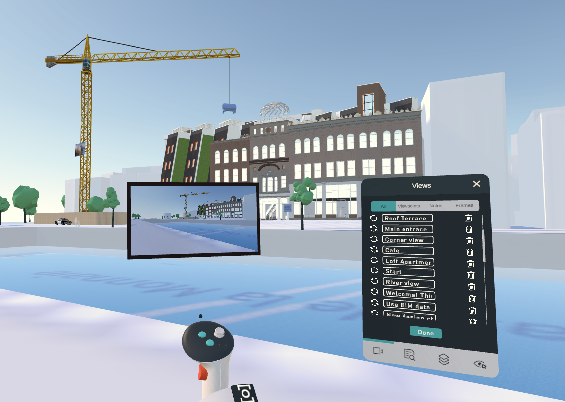

If you select "Add new", a camera will appear in your hand in VR, allowing you to position your new viewpoint. When the trigger is pressed, the view is created, and the viewpoint's default name can be modified or clicked to jump to this view.
You can repeat these steps to add as many viewpoints as you like. You can delete and update existing views with a new location by using the Modify button and pressing the Update button next to the view name, or by clicking the delete icon located behind the view name. The view lists functions similarly in flat versions of Arkio. The main difference is that you don't need a VR handheld camera to frame your new or updated views, as your device already does so.

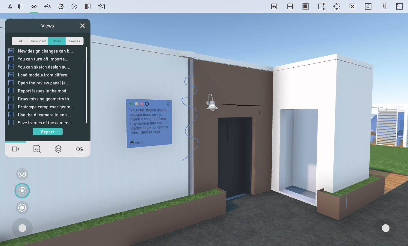

Notes and Frame views
You can jump between existing notes placed in the Arkio scene to switch to the camera position from which the original note or frame was created. If this note or frame is moved in Arkio, the view's position will be updated accordingly. A Note will get the same name as the textual content of the Note, and a frame can be renamed to your liking.

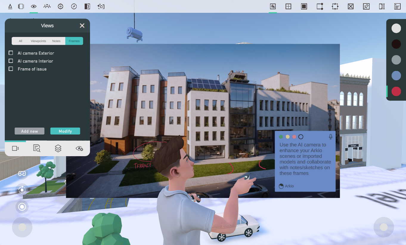

When you delete a note or frame, the corresponding view will also be removed. You can view samples of the saved viewpoints, Notes, and Frames in our Revit sample projects and learn more about working with Notes and Frames on their respective pages.
