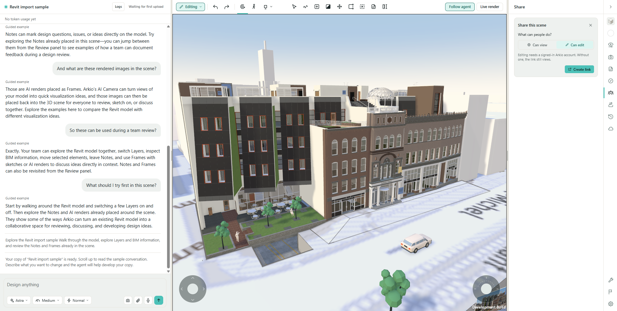

Share your scene
Open the scene you want to share.
Click the Share icon in the right-hand toolbar to open the Meeting panel.
Select Share this scene.
Choose Can view or Can edit.
Select Create link and wait for the scene to finish uploading.
Copy the link and send it to your collaborators.
You must be signed in to create a sharing link.
Choose who can edit
Use Can view for presentations and design reviews. Choose Can edit when you want collaborators to make changes.

In the Meeting panel, select the link access setting to choose the viewing or editing link, then copy it. Anyone who receives that link can use the access it provides, subject to sign-in and account permissions.
Changing the link setting does not revoke an edit link you have already shared. Send editing links only to people you want to give editing access to.

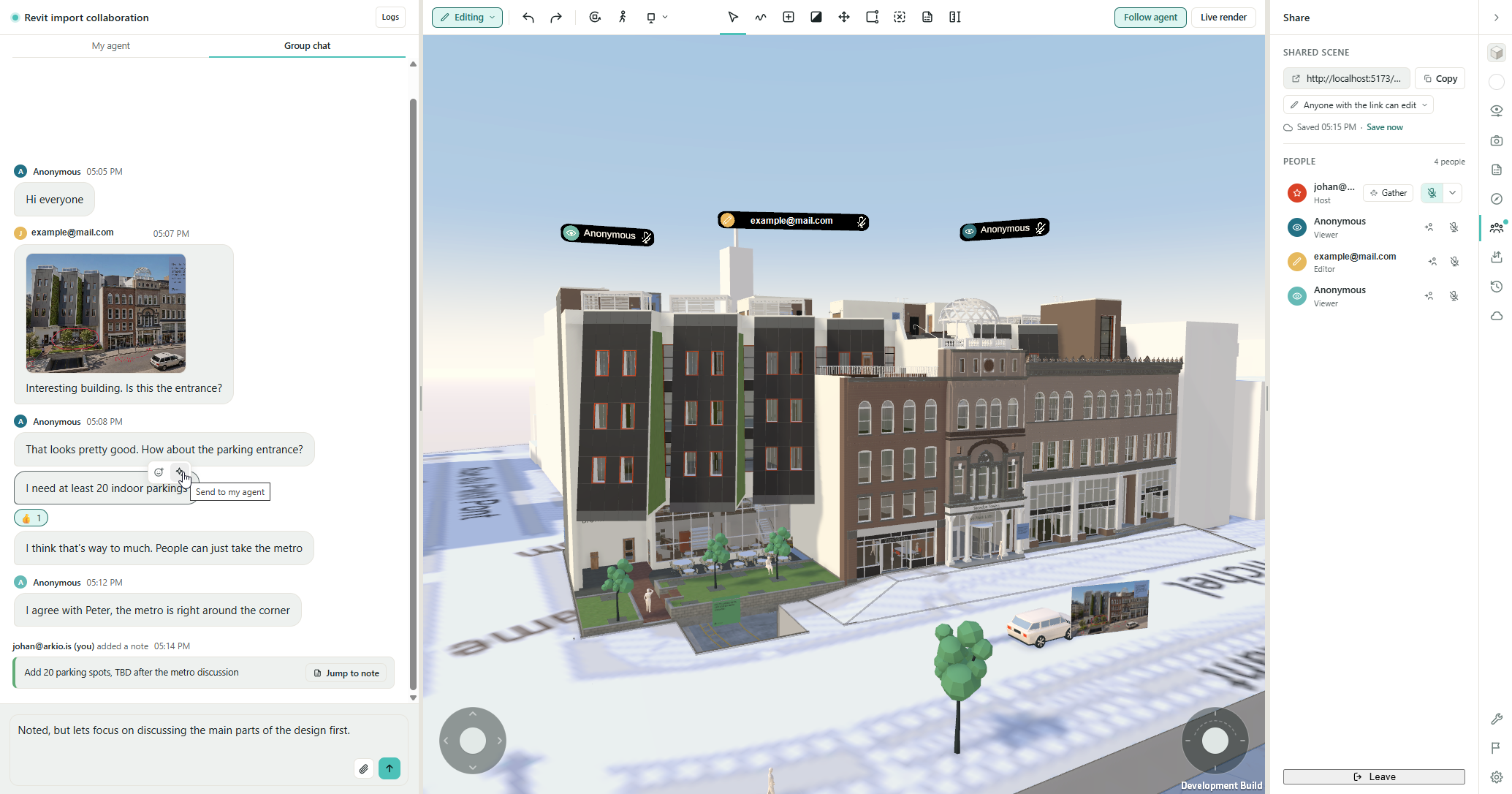

In a shared scene, the chat area has two tabs:
My agent: Your own conversation with the AI.
Group chat: Messages shared with the people in the scene.
Use Group chat to discuss changes, attach files and images, and react to messages. Add attachments with the paperclip, drag and drop, or paste. You can edit or unsend your own messages.
To share an agent response, generated image, or video, use its share control. It is prepared in Group chat so you can add a message before sending.
Agent conversations remain private: Collaborators see your agent’s model changes, but not your conversation in My agent. Agent messages are not automatically posted to Group chat.
To use something a colleague shared, choose Send to my agent. This prepares the message and attachments in your own agent chat. Review them, add your instructions, and send the request when ready; forwarding does not start AI work automatically.

Talk with other participants
In the Meeting panel, use the microphone control beside your name to unmute. Allow microphone access when your browser asks.
You join muted. Use the microphone menu to choose an input device. The host can mute participants, but each person must unmute their own microphone.
Meeting audio connects you to other people. The microphone in My agent starts a separate AI voice conversation. If Arkio says the microphone is already in use, mute meeting audio before starting AI voice, or end AI voice before unmuting in the meeting.
Meeting audio is not currently supported in Safari. If meeting audio is unavailable in your browser, use Group chat or a separate call. See Browsers and devices for compatibility guidance.
