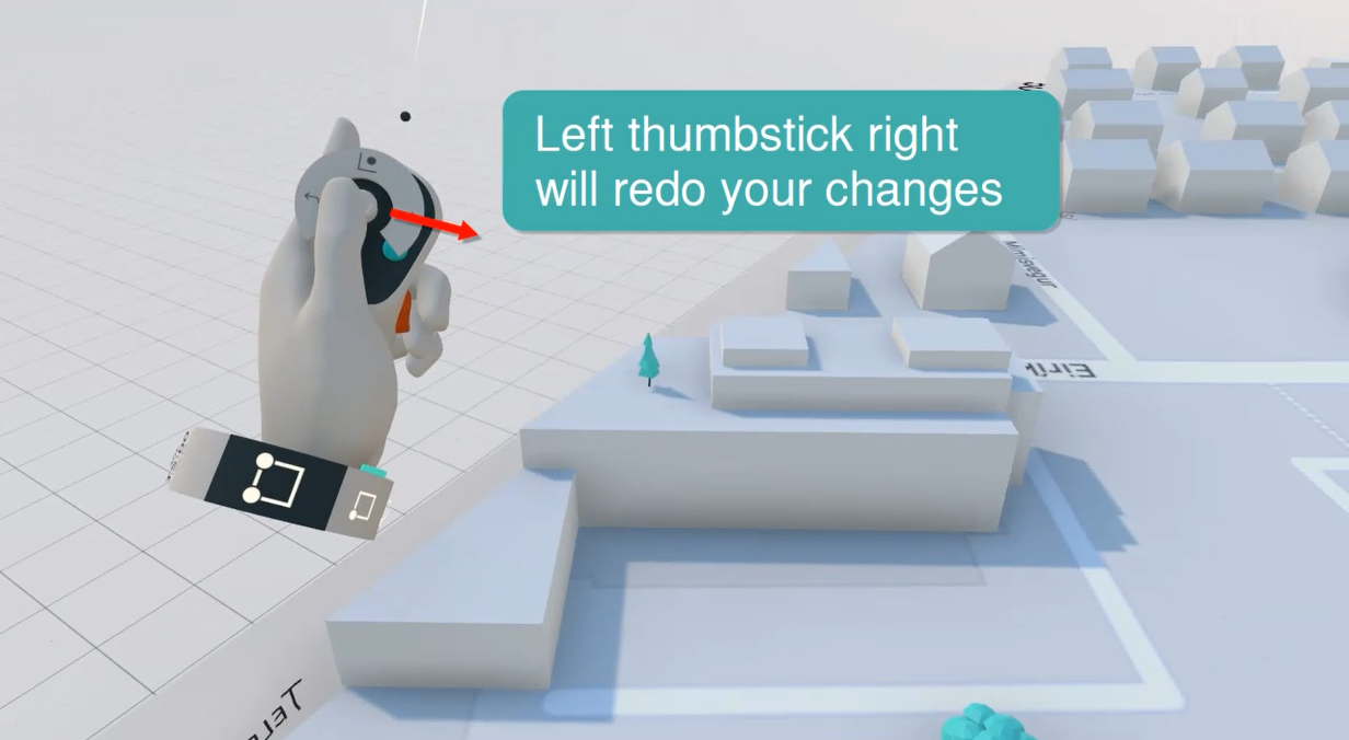

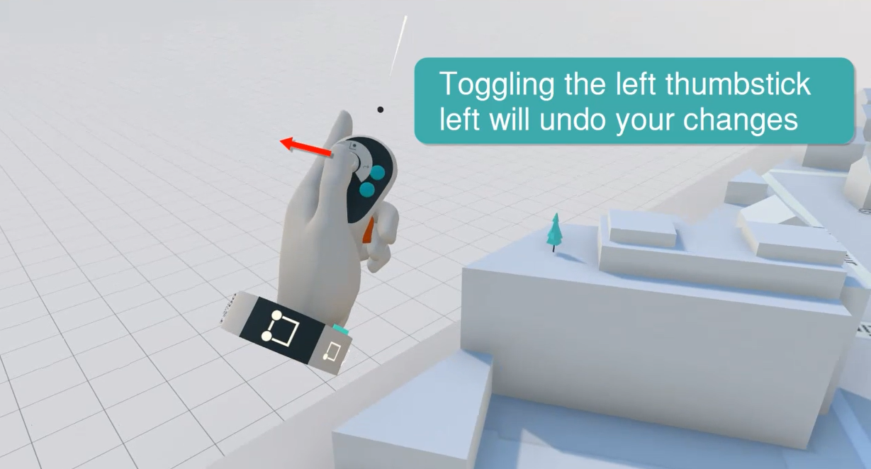

VR controller
Undo and redo are done using your non-dominant controller or hand. Undo is done by pressing the joystick left, and redo is triggered by moving the joystick right. (or by pressing the touchpad left or right if you are using an older VR device)

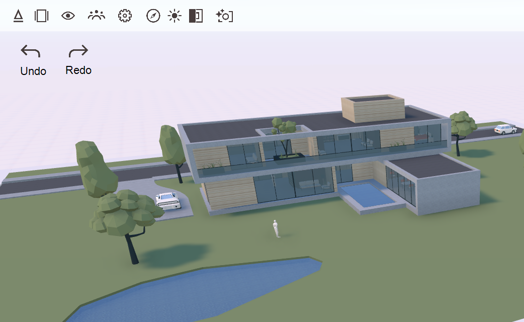

Non-VR
If you are using the non-VR version of Arkio, the undo/redo buttons are in the top-left corner of your screen. You need to be an editor for the Undo Redo buttons to show.

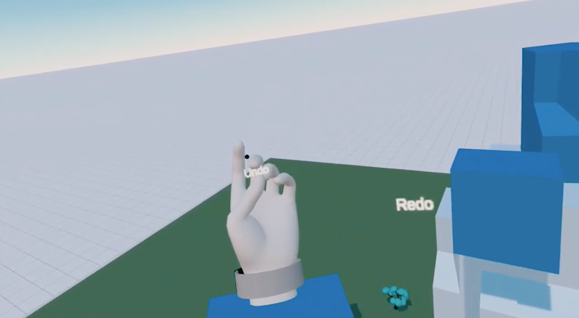

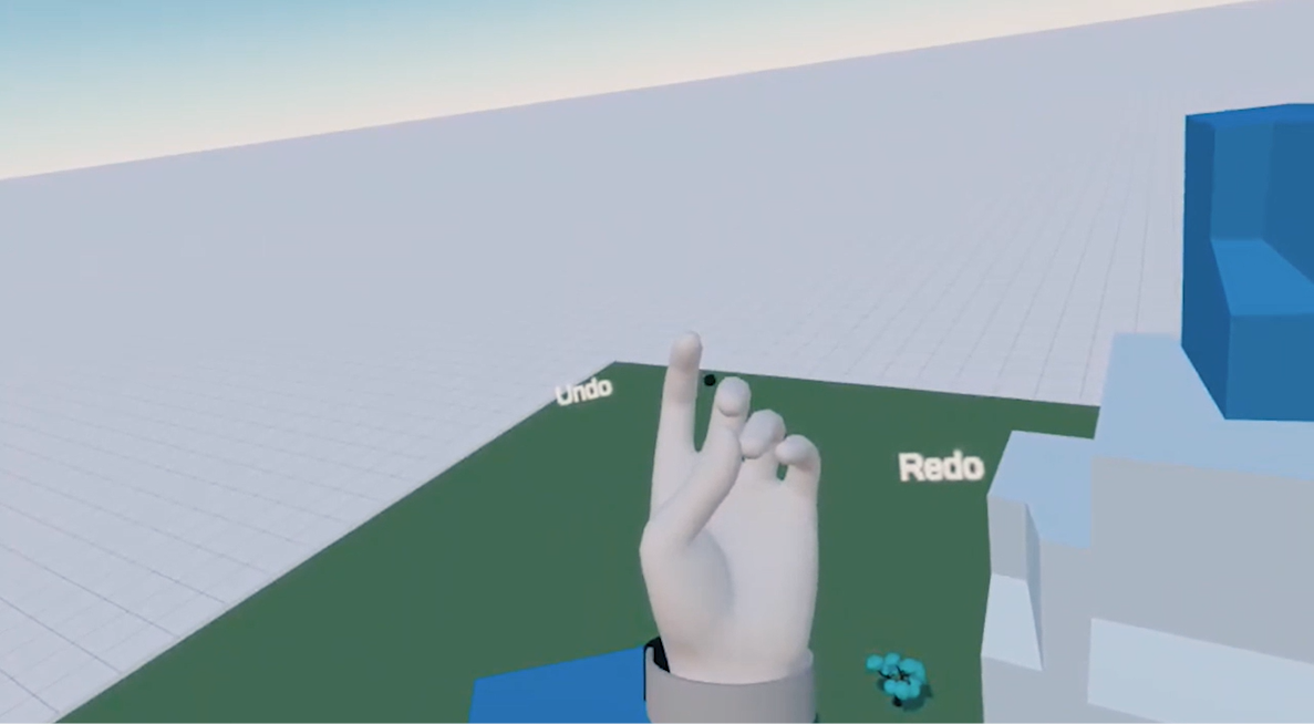

Hand Tracking
If you are using the experimental hand tracking on a Quest or Quest 2, the Undo/Redo can be triggered by pinching your thumb and middle finger together on your left hand while watching your wrist and moving your hand left to undo or right to redo
