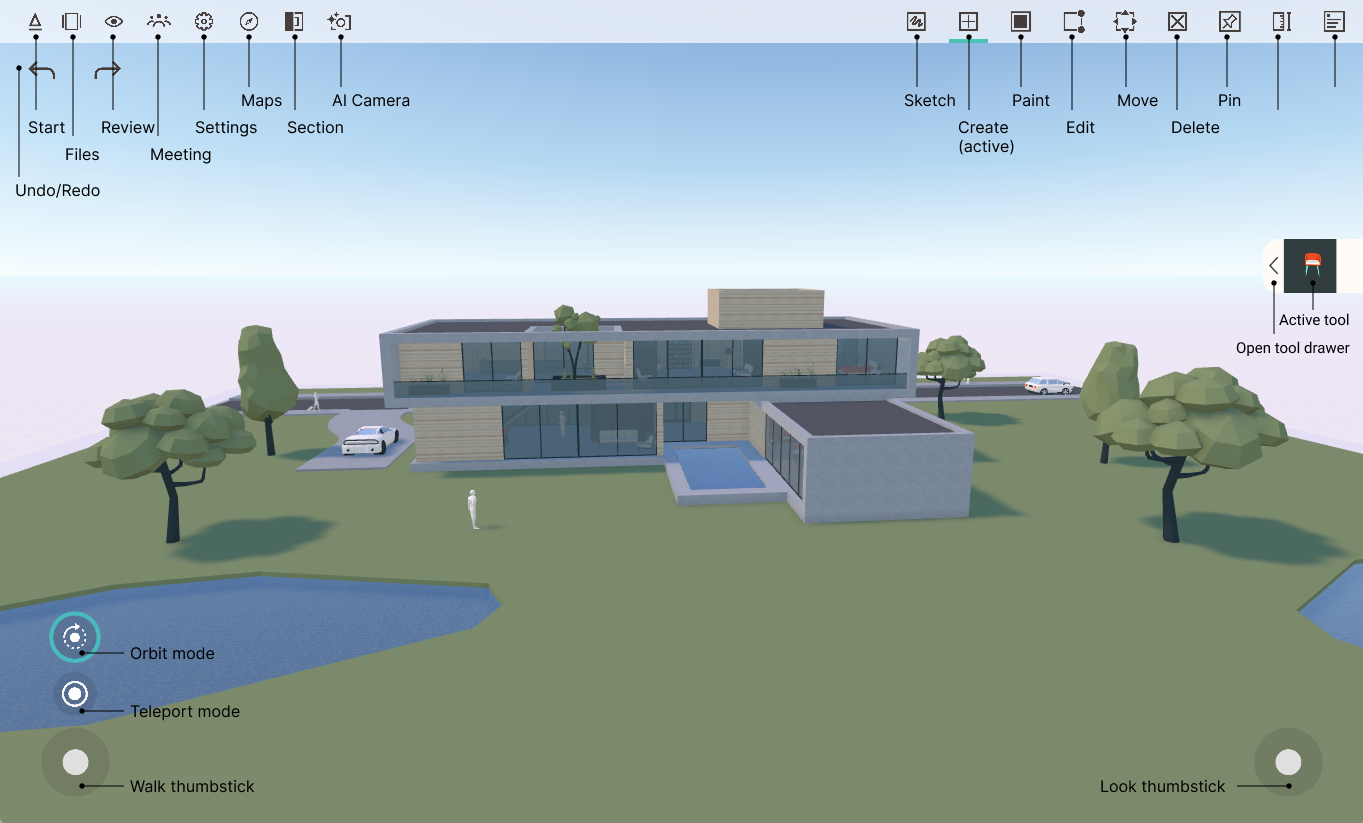

When you start Arkio in Windows/Mac/iOS/Android without a VR headset, the navigation tools are located in the bottom-left corners. You can find the orbit mode, teleport mode, and walk/look thumbsticks to navigate around.

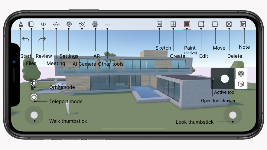

iOS/Android navigation
  • Two-finger pinch gesture to zoom in and out
  • Two-finger swipe gestures to pan
  • Touch and drag anywhere on the sky, the white ground below the worktable or the bottom of the green worktable to orbit the camera if any tool is selected.
  • Use the orbit or teleport tool in the bottom left corner to directly orbit or teleport
  • Use the thumbstick navigation controls to walk and view

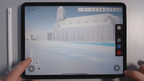

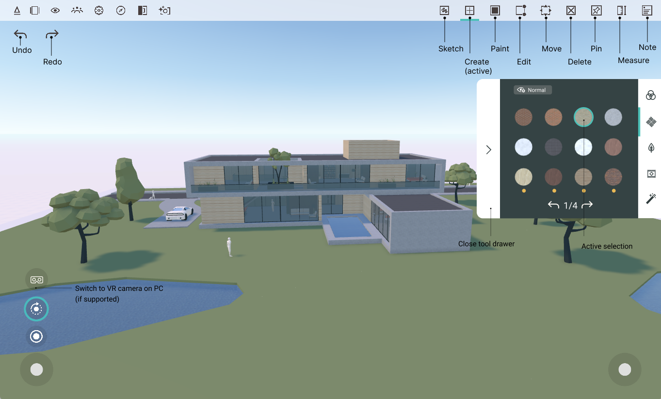

Tools in Arkio are activated by clicking the top toolbar buttons. The active tool will be highlighted, and additional tool options may be shown on the right side of your screen. The tool drawer can be expanded to offer more options for certain tools, such as selecting alternative colors and creating and importing shapes.
Tools like Create or Sketch require a drag motion, whereas others, such as Paint, require a single tap or click. The example below shows sketching on the model using the Sketch tool.
Some tools, like Create, Edit, or Move, work in three dimensions, requiring toggling between the primary and secondary axes. While creating, moving or editing shapes, you can briefly tap a second finger on your screen while still holding the first finger down to switch between axes.
