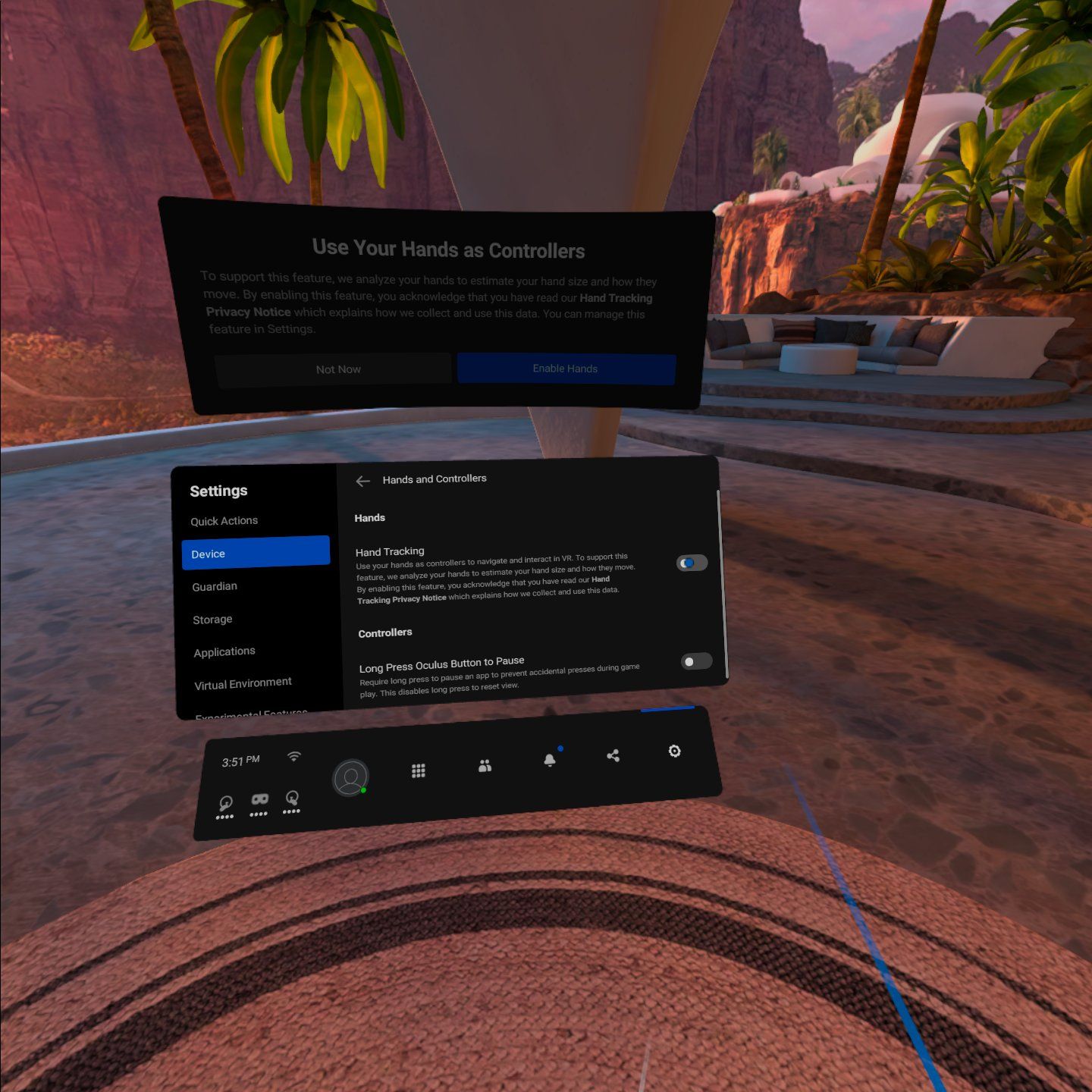

Enable hand tracking
  1. Enable hand tracking in your headset's settings.
  2. In Arkio, open Settings → Arkio Labs (the experimental settings tab) and enable Hand tracking.
  3. Place your controllers on a stable surface, hold your hands where the headset can see them, and wait for the tracked hands to appear.
To return to controllers, pick them up again. If they do not become active immediately, press a controller button. To prevent automatic switching to hands, turn off Hand tracking in Arkio's experimental settings.

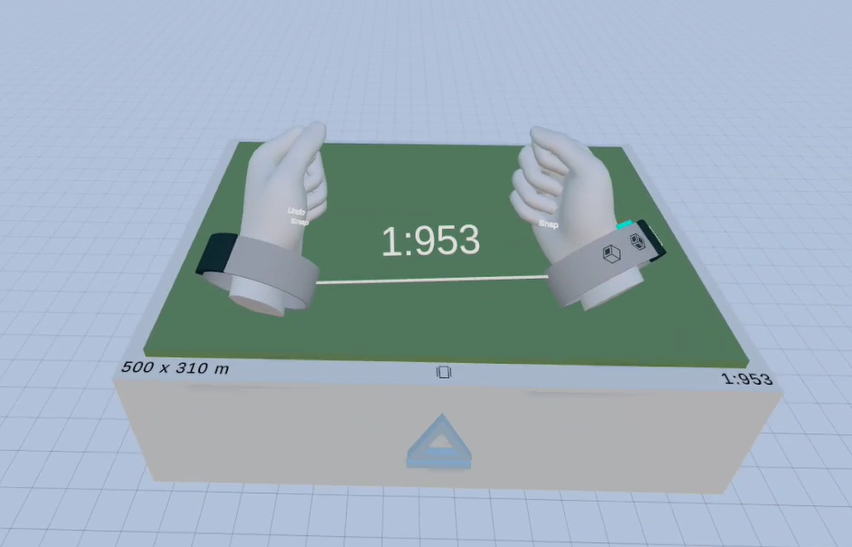

Move and scale the world
Form a fist with one hand to grab the world, then move your hand to reposition it. Form fists with both hands and move them apart or together to change scale. Open your hands to release the world.
These gestures work like the grip buttons on your controllers. Start with your hands in view and your palms facing away from you so you do not activate the palm-facing shortcuts.

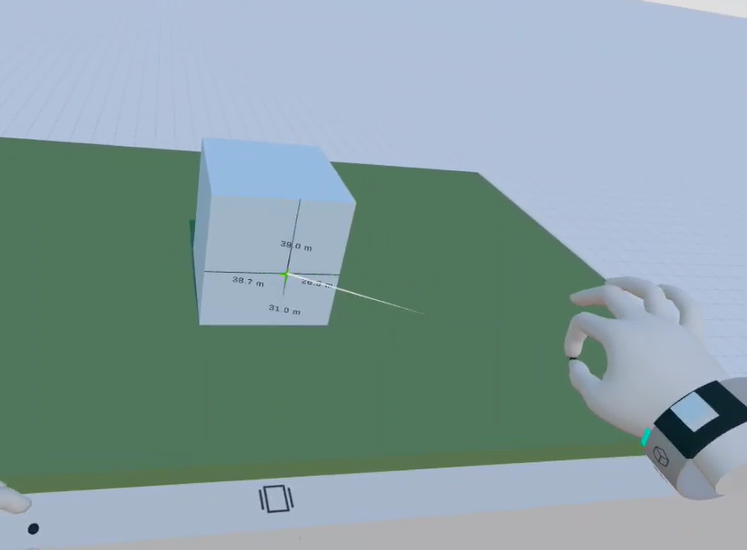

Activate the laser and use tools
  1. Open your hand, spread your fingers, and face your palm forward, like a stop sign. The laser for that hand's active tool appears.
  2. Aim at the object, surface, or menu control you want to use.
  3. Pinch your thumb and index finger together to start the action. Hold the pinch while moving or editing, then separate your fingers to release.
The index-finger pinch acts like a controller trigger. You can also reach toward nearby geometry and pinch at the interaction point to manipulate it directly. See Laser & grab interactions for the difference between working at a distance and working within reach.

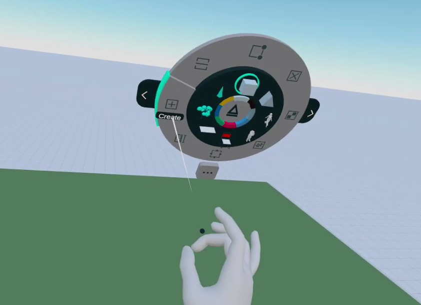

Open menus and select tools
Open the main menu with your palm
Look at your right hand, open it with your fingers spread, and turn your palm upward to show the menu. You can touch its buttons with the index finger of your other hand. This is a separate gesture from the middle-finger pinch used for quick tool selection.
Use the right-hand Quick Access Menu
Keep your right hand in view with your palm facing away from you. Pinch your thumb and middle finger together while keeping your index finger extended and clear of your thumb.
Hold the pinch and aim over a tool to switch to it. Release the pinch to keep the last tool selected. You can also select tools by touching their buttons with your index finger.
See Quick Access Menu for more about quick tool selection.

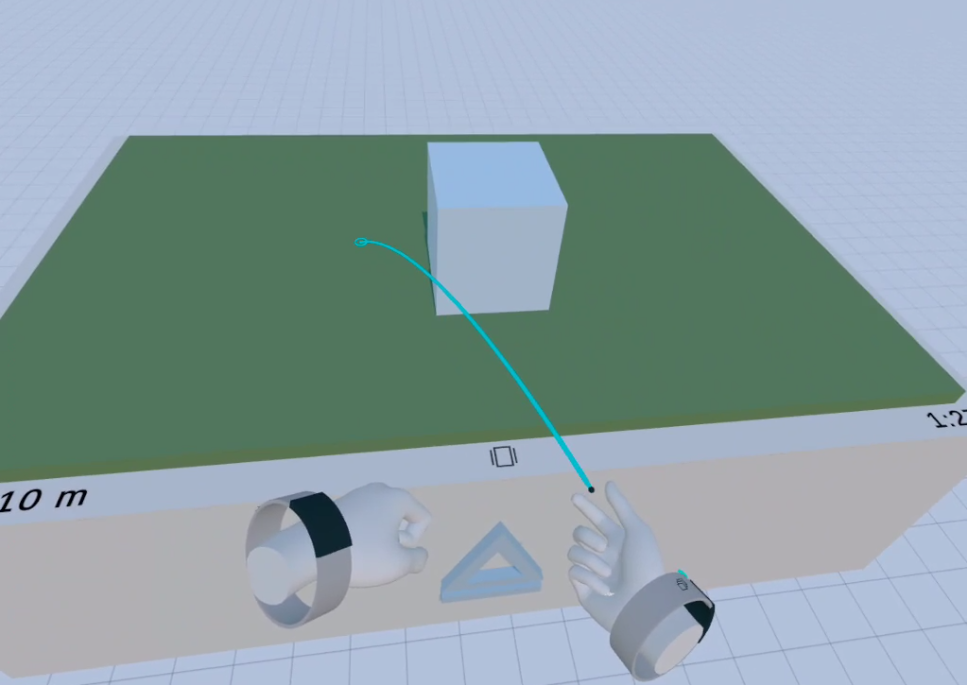

Teleport
  1. Turn your right palm upward and toward you, extend your index finger, and curl your middle, ring, and little fingers to activate teleport mode.
  2. Aim at the location you want to move to.
  3. Pinch your thumb and index finger to teleport.
Keep the pointing pose to make another jump. Open the curled fingers to leave teleport mode.

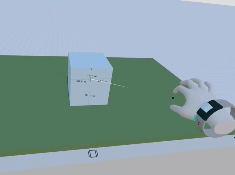

Temporarily disable snapping
Turn your palm upward and toward you until the Snap hint appears near your little finger. Pinch your thumb and little finger together to temporarily disable guides and snapping.
Keep the fingers together while you need snapping disabled. You can turn the hand back down while holding the gesture. Separate your thumb and little finger to restore snapping.
