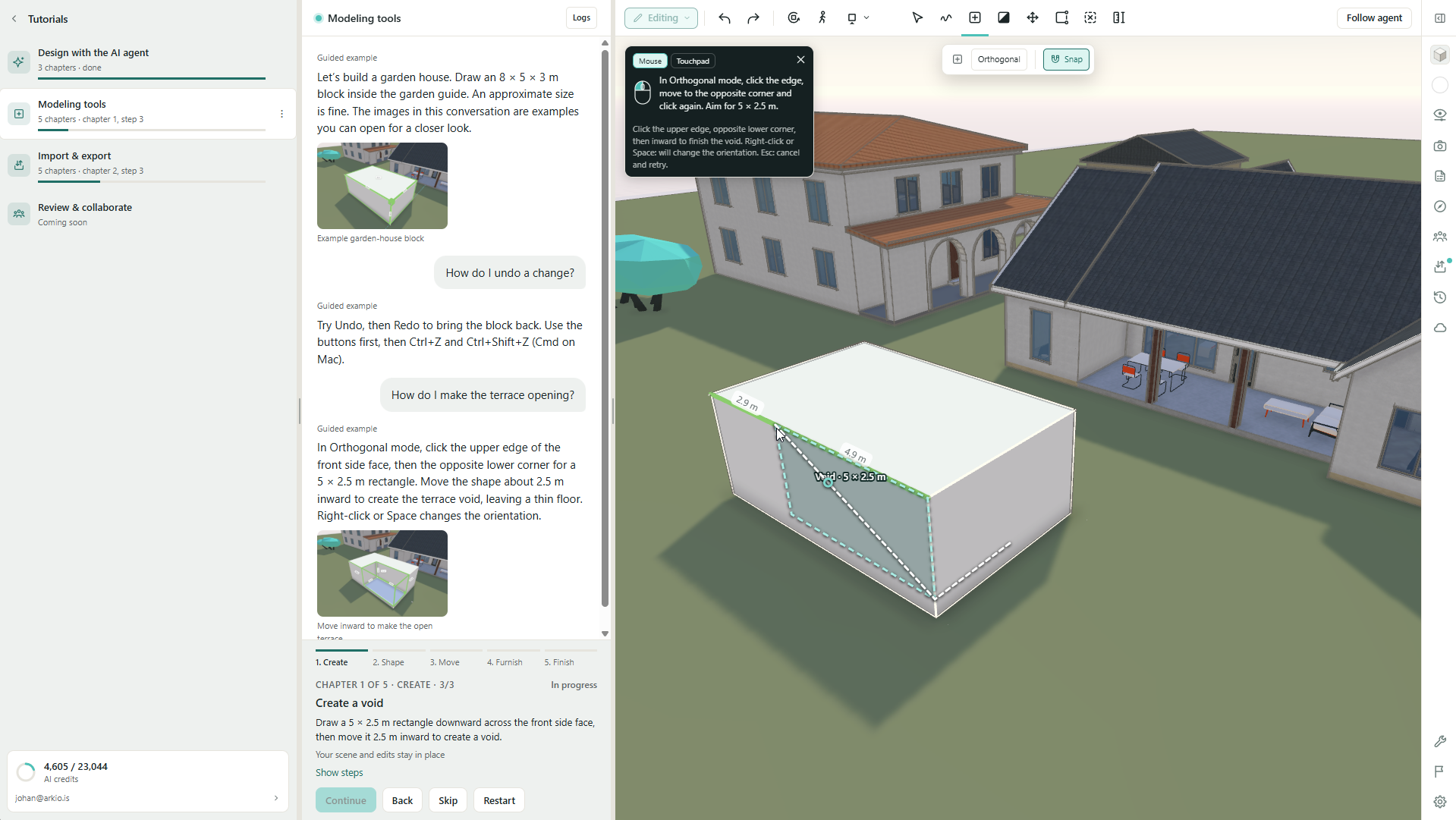

Shape space with solids and voids
Solids add built form; voids remove space from Arkio geometry. Overlapping them lets you create openings, recesses, and courtyards. You can continue moving or reshaping the geometry as the design develops.
Try a simple terrace opening:
  1. Create a rectangular block approximately 8 × 5 × 3 metres.
  2. With Create in Orthogonal mode, start a rectangle on the block's front face. Leave some material around the opening and a thin floor below it.
  3. Extend the new shape inward into the block to create a void, stopping before the back face.
  4. Inspect the recess from the front and side. Use Edit to adjust its size or depth.
The Modeling tools tutorial demonstrates this exercise with placement guides. Begin with Arkio-created shapes for this exercise; imported models are reference geometry and do not behave like editable Arkio solids.
