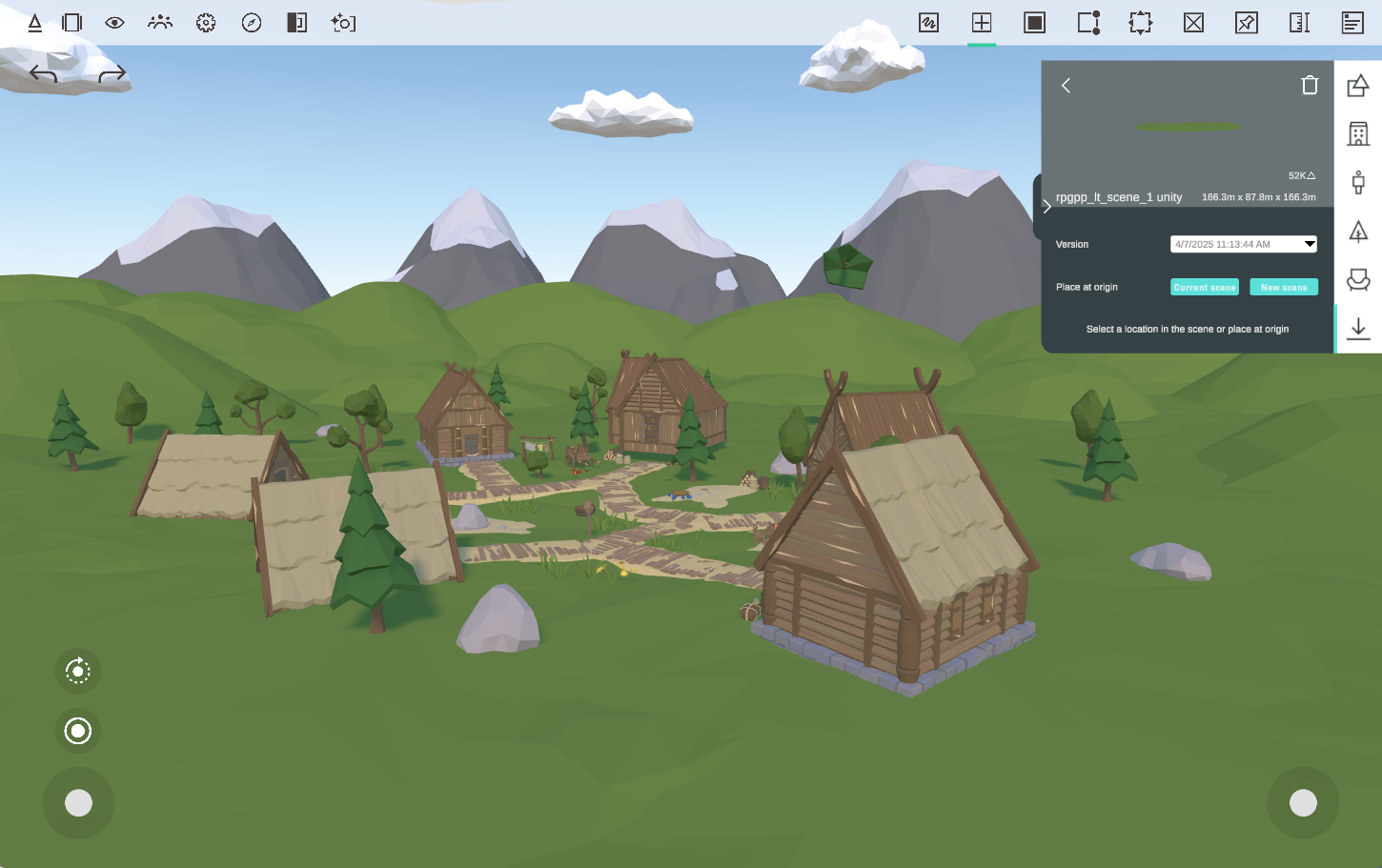

  1. Open Arkio’s import library and wait for the model to finish processing. On the desktop interface shown below, use Create → Import.
  2. Select the model and check its scale and orientation.
  3. Place it manually, or choose placement at the origin in the Current scene or a New scene when alignment matters.
  4. If the placed model is pinned, unpin it before moving it. Keep it pinned when you want to protect its position while designing around it.

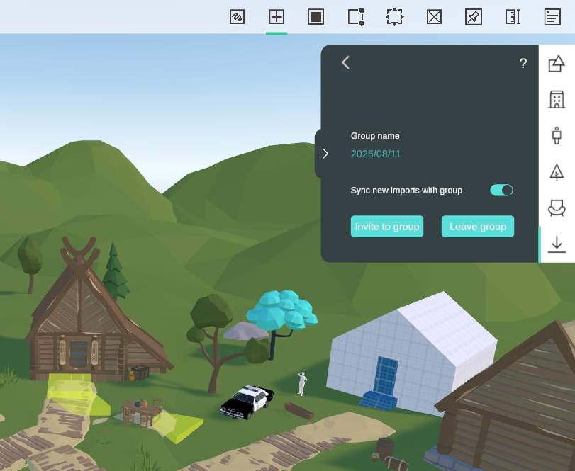

Connect your devices to the same Arkio Cloud group to access the imported file on each device. On the desktop interface shown below, open Create → Imports → Cloud and enter the group’s link code.
