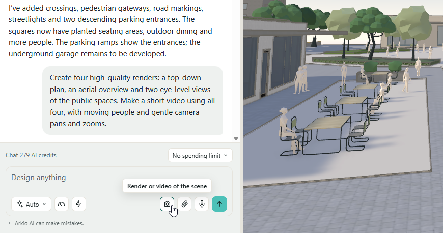

  2. Select the camera button in the chat message box, labeled Render or video of the scene.
  3. Choose Render and select Current view, Saved views, or Let the agent choose. Saved views uses the saved viewpoints in the scene; check the request summary before sending. When the agent chooses, you can set the number of renders.

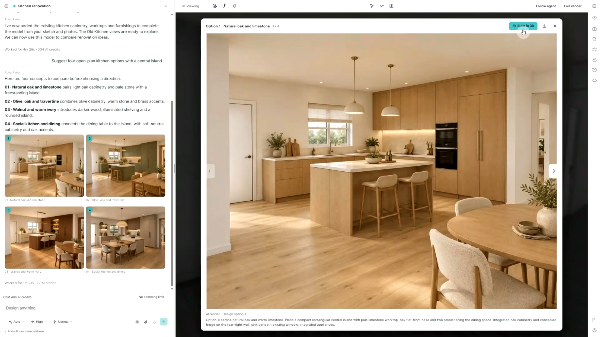

Review and refine an image
Open the completed image from the chat to inspect it. Compare it with the model: AI images can interpret or add details that are not present in the geometry. Describe the specific image change you want in a follow-up request.
If a change should also become part of the 3D design, ask the agent to update the model or use Arkio's modeling tools. Changing the appearance of a generated image does not automatically make the same change to the geometry.

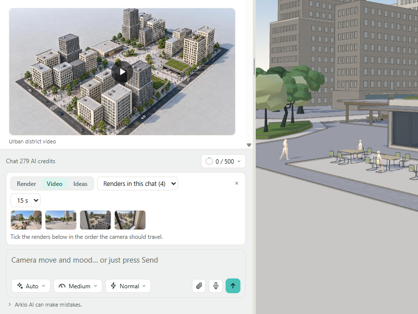

  1. Select the chat's camera button and choose Video.
  2. Choose a source. Use Renders in this chat to work from completed images, or choose the current view, saved views, or views selected by the agent.
  3. When using existing renders, select the images in the order you want the camera to travel. With one image, describe the camera movement; with two, the video starts from the first and ends at the second.
  4. Choose the video length from the available options. Add instructions about the camera movement and pace, then send the request.
  5. Open the completed video in the chat to review it.
Create a 10-second video from these two renders, moving slowly from the entrance toward the courtyard.

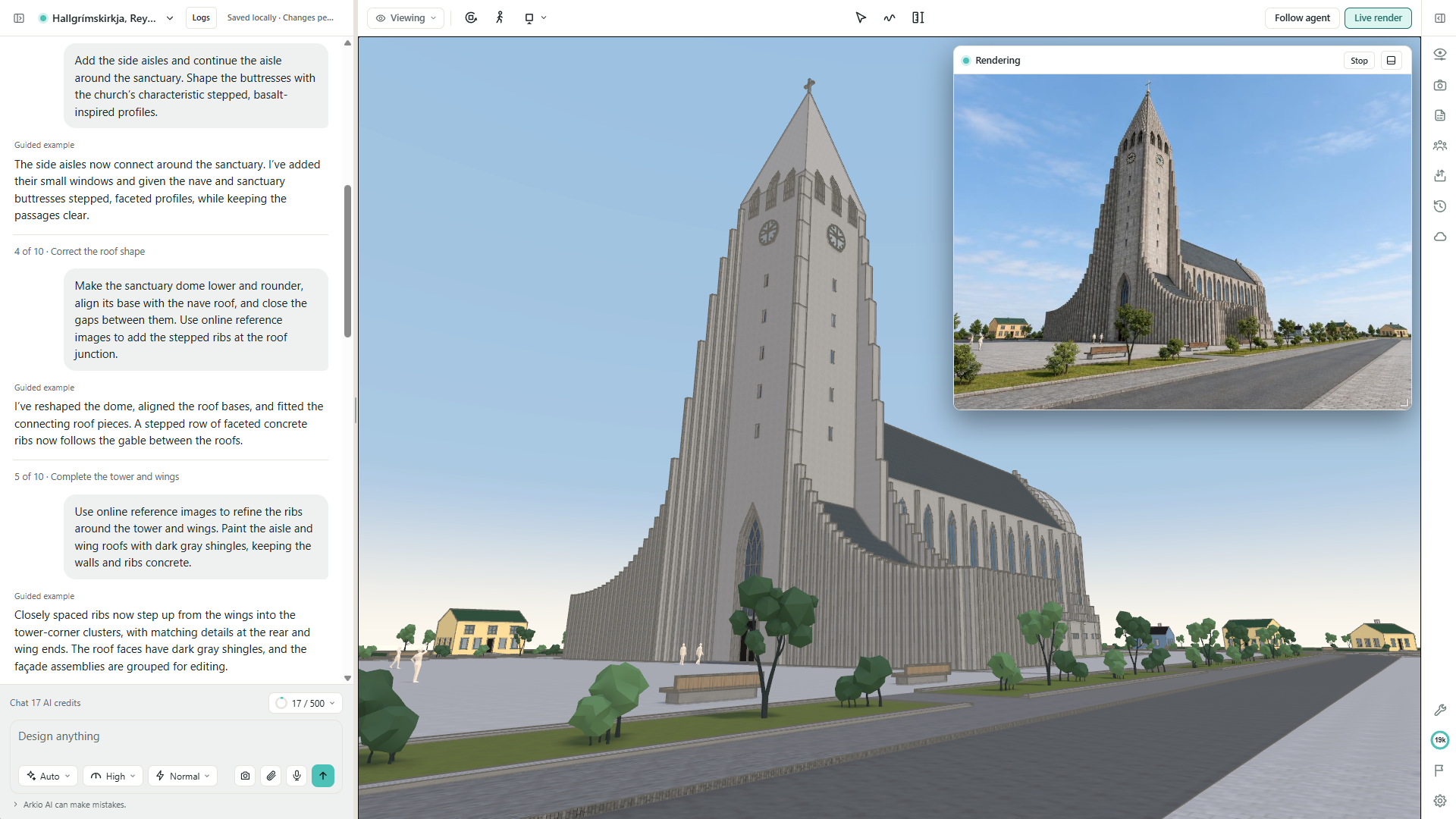

  1. Open Live Render above the scene.
  2. Choose Render once for one image, or Start for ongoing updates.
  3. Explore your design and allow the view to settle while images are generated. The Interval control sets the minimum time between updates; generation time can make updates take longer.
  4. Select Stop when you have finished. You can keep the panel below the scene or use its float control to place it over the scene.
Live rendering uses AI credits as images are generated. It is a sequence of rendered updates, not a saved video recording. For a presentation image or video you want to keep and share, request it through the chat.
