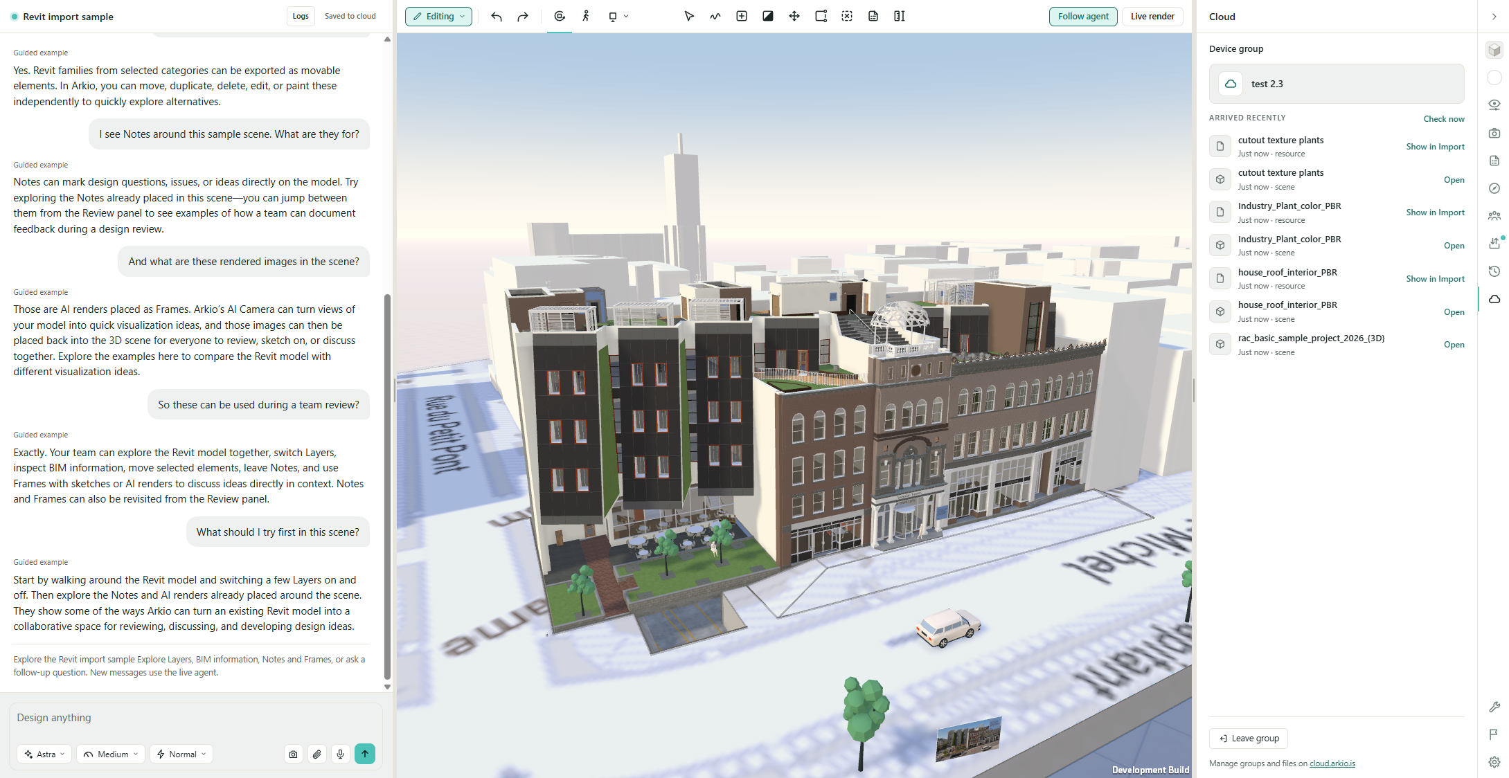

2. Connect Arkio on Windows and Arkio Web
Use the same Arkio Cloud device group in both applications. Signing in to your Arkio account does not automatically connect you to a device group.

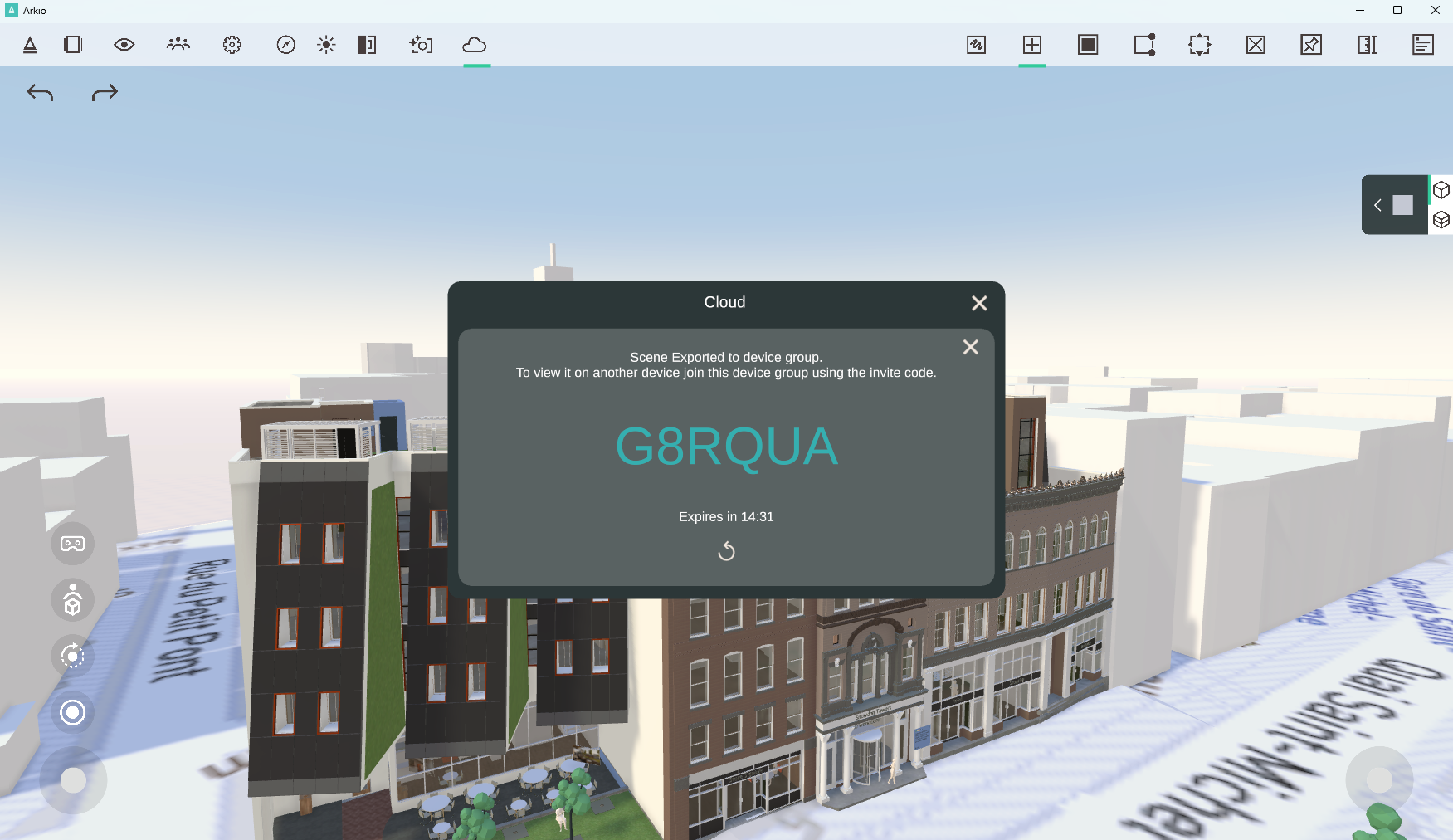

  1. Open Arkio on your PC and connect it to your Arkio Cloud group. You can manage groups at cloud.arkio.is.
  2. Open Arkio Web and sign in.
  3. Open the Cloud tab, enter an invite code for the same group, and select Join.
  4. Keep Arkio running on your PC while exporting and syncing files.
Arkio Web checks the group for new files automatically. You can also select Check now in the Cloud tab.

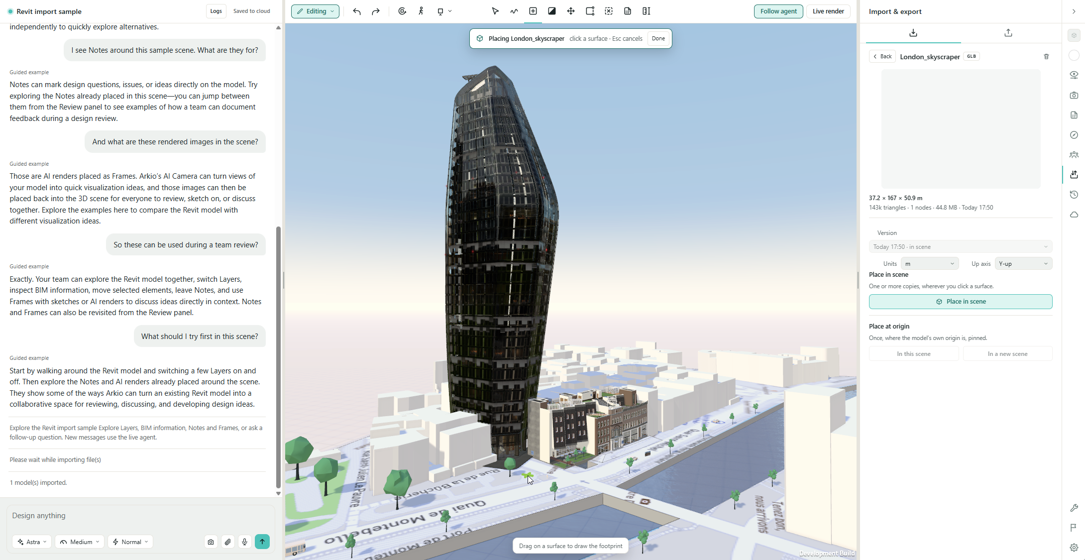

The plugin exports the model to Arkio on your PC, which processes and syncs the files through Arkio Cloud. Once this finishes, the model appears in Import & export → Import in Arkio Web. You can also select Show in Import beside a model that has arrived in the Cloud tab.
4. Place the model
Open the model's details in the Import panel and choose:
  • Place in scene: Position the model manually. Each click places a copy until you select Done, press Esc, or choose another tool.
  • Place at origin: Place the model at its original coordinates in the current scene or in a new scene.
Plugin exports include their units and orientation. For generic model files, check Units and Up axis if the model appears at the wrong size or orientation.

  • Check that Arkio on your PC is running and that both applications are connected to the same Cloud group before you import the file again to Arkio on your PC
  • Wait for export, processing, and Cloud sync to finish, then select Check now.
