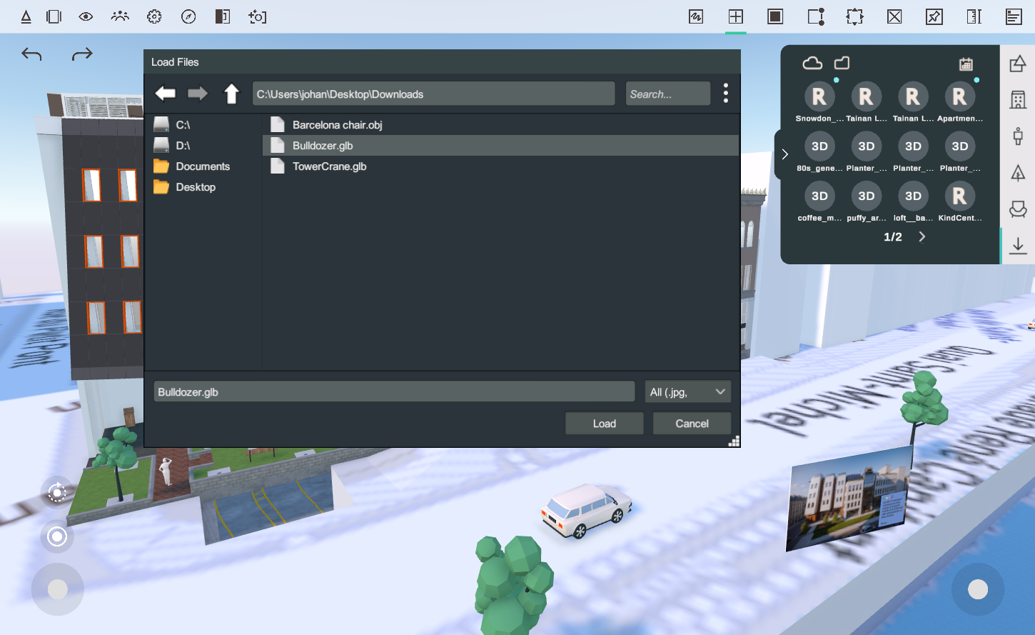

The PC version of Arkio includes our plugins for Revit and other design tools that open your exported models directly in Arkio with layers and movable elements. You can also manually import OBJ and GLB/glTF files on your device by selecting files from the Create > Import drawer. Alternatively, you can place the files in your device's import directory, located in Documents/Arkio/Import on Windows.

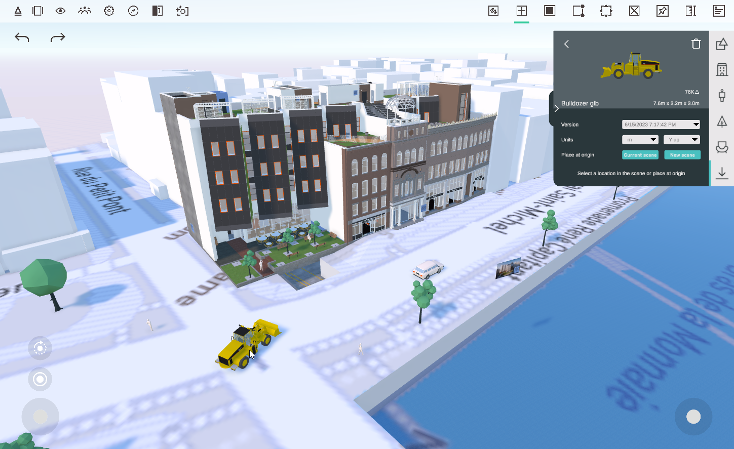

Files imported to Arkio will show in your Create > Import drawer. You can sort these imported resources by name, date, or type and click the file to open a preview with placement settings for that resource. In your model preview tab, you can see the number of triangles and movable elements for that imported object. For generic imported OBJ and GLB models, you can set a different unit and up-axis orientation from the dropdowns. Exports from our plugin already include the correct size and orientation and include layers with individual, movable objects.

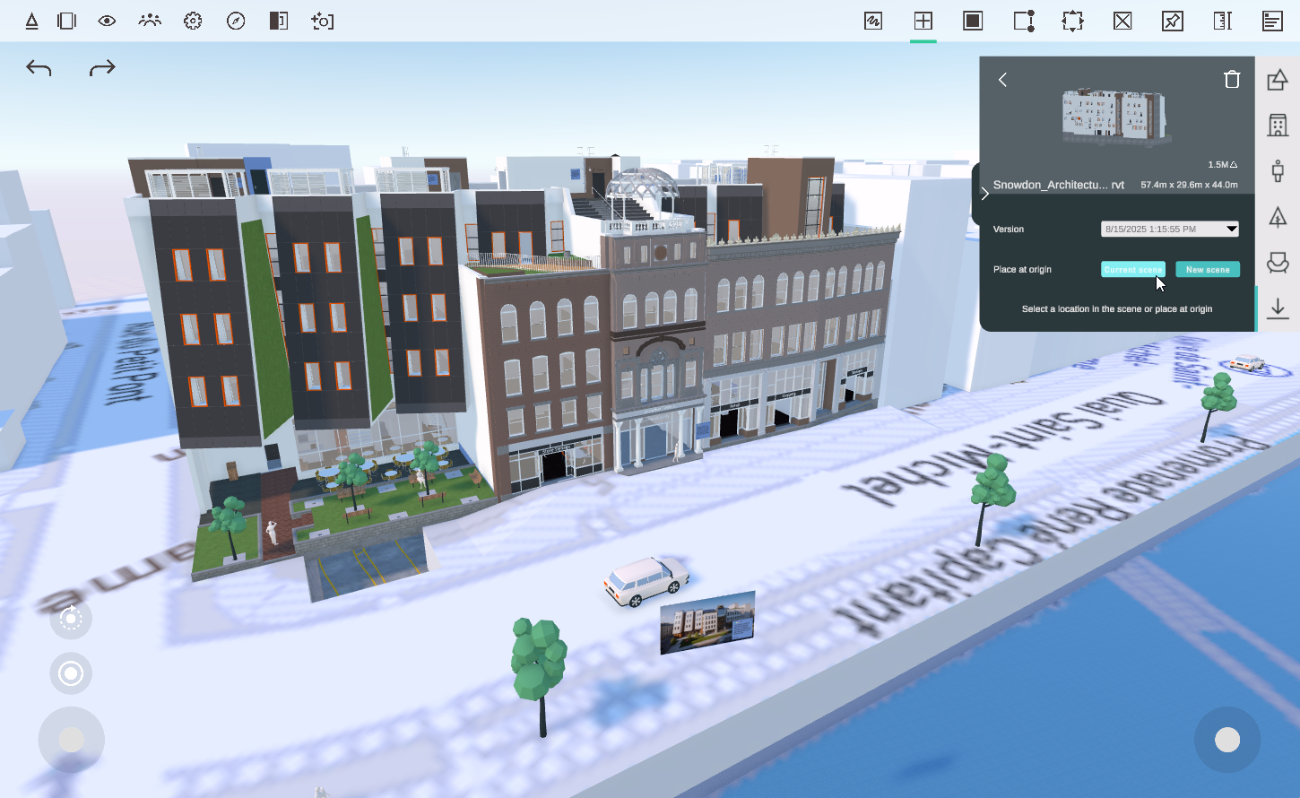

With the placement tab open, you can click anywhere in the scene to manually place an instance of that model. Or press the green Place at origin buttons to place the model pinned in the current or a new scene. Models placed at the origin can be aligned with other models, enabling a round trip between your design tools when exporting Arkio-added geometry back to your existing tools.
After you place the imports on one device, you can start a live meeting with your other device to share the scene with that device, including all imported geometry. You can also link your PC to the same Arkio Cloud to automatically synchronize new imports to your other devices.

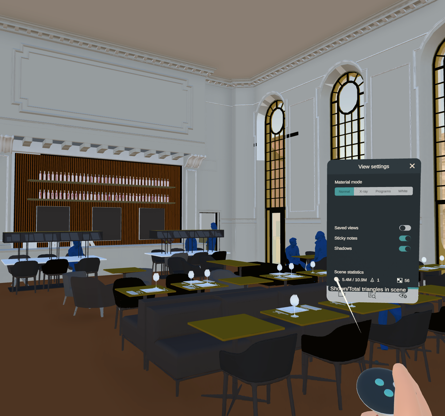

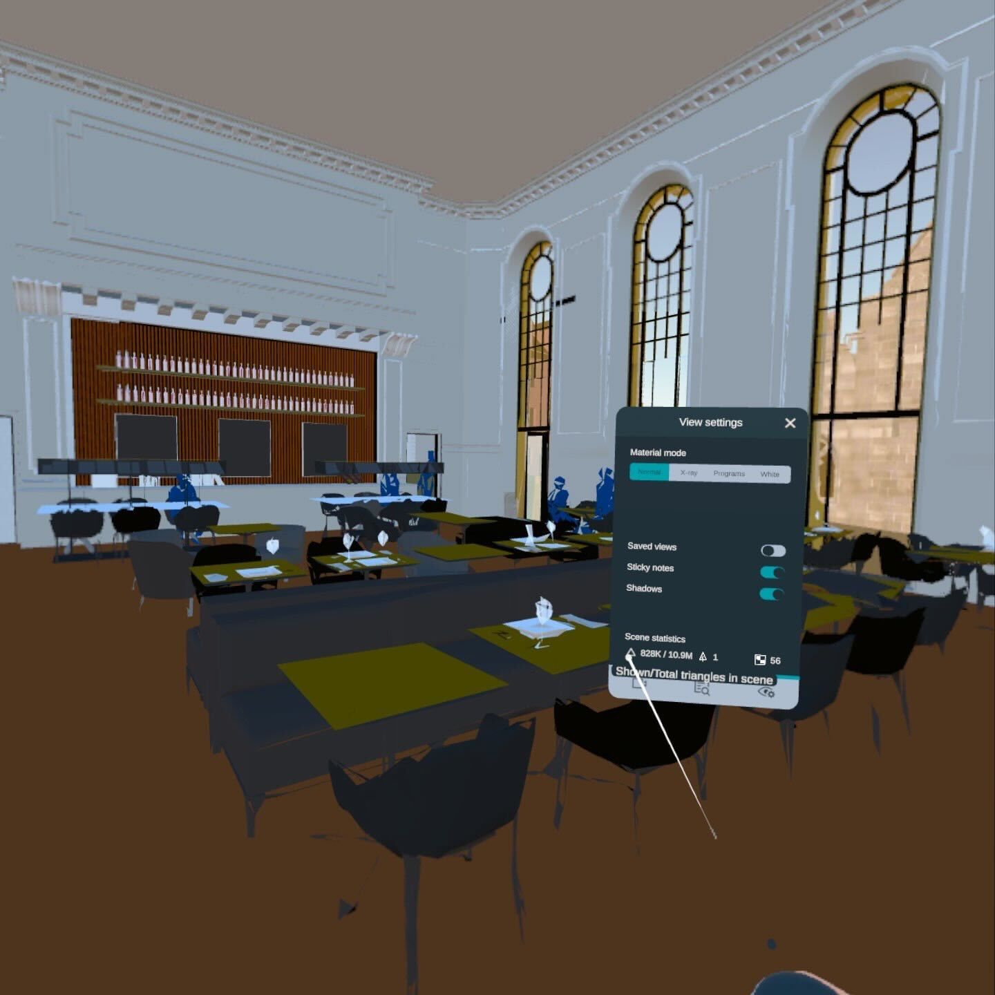

Arkio supports importing large models with millions of triangles. If you want to load large files, we recommend importing the model in Arkio on a more powerful device, such as your PC/Mac, before sharing it with a mobile device using Arkio cloud or a live meeting. Imported models may appear less detailed, depending on your device's triangle budget.
828K/10.9M on Quest 3 standalone
5.4M/10.9M on Quest 3 in PC link mode

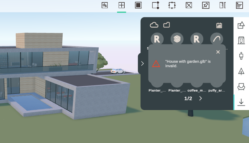

Some 3D models may fail to load in Arkio, resulting in a warning in the import panel.
  • If you experience issues loading your models, try loading the file in GLTF viewers or tools like Blender to determine if the mesh geometry is invalid or too far away from the origin.
  • Avoid issues and long processing by importing only the geometry you need. You can find tips and best practices to optimize your geometry here.
