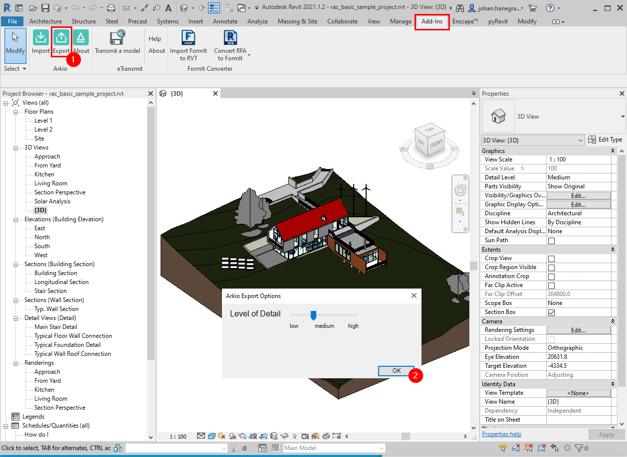

  • Open a Revit sample model
  • See the Arkio plugin in the Add-In ribbon
  • Export the Revit model from a 3D view.
  • Arkio should start and open the Import drawer after a successful export
  • You can place the model in the scene and share it with Arkio on your mobile device using a meeting, if you want to test whether those features work well in your organization's network
Revit
The Revit plugin can be found under Add-Ins>Arkio.

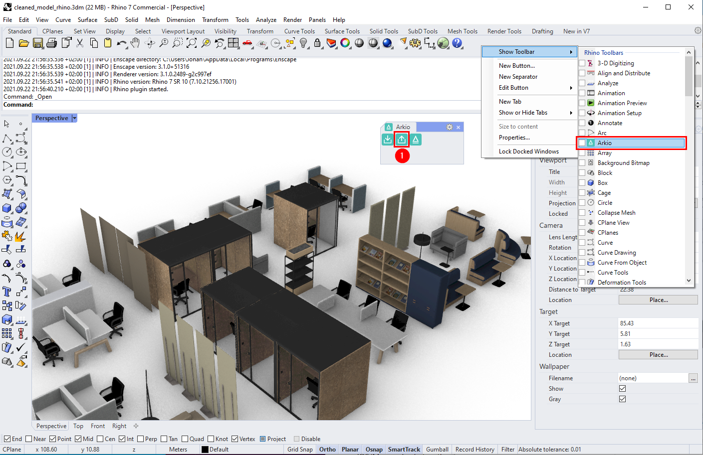

Rhino
The Rhino plugin can be found in the Arkio toolbar

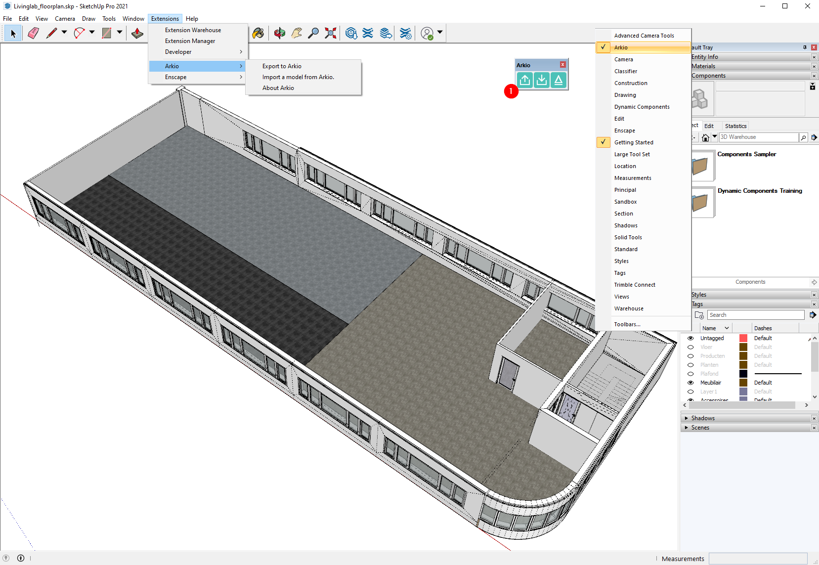

SketchUp
The SketchUp plugin can be found in the toolbar by right-clicking and adding the Arkio tab

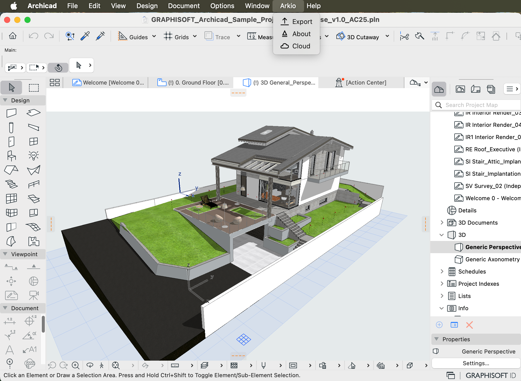

Archicad
The Archicad plugin is available in the main Arkio tab.

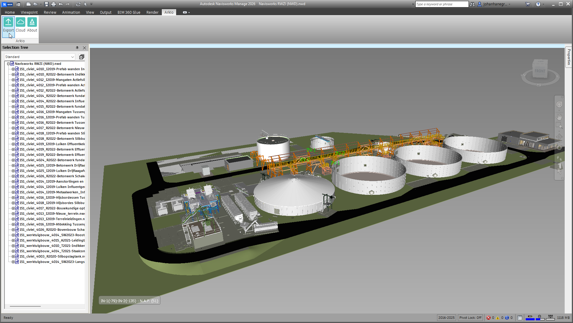

Navisworks
The Navisworks plugin is available in the main tool ribbon
