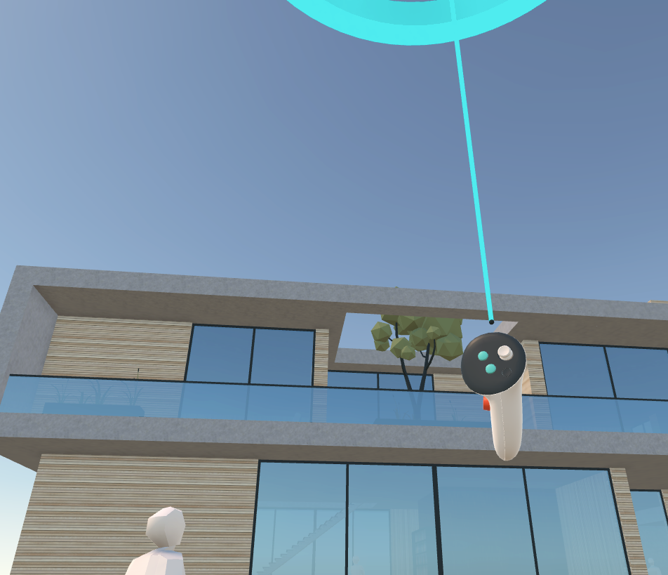

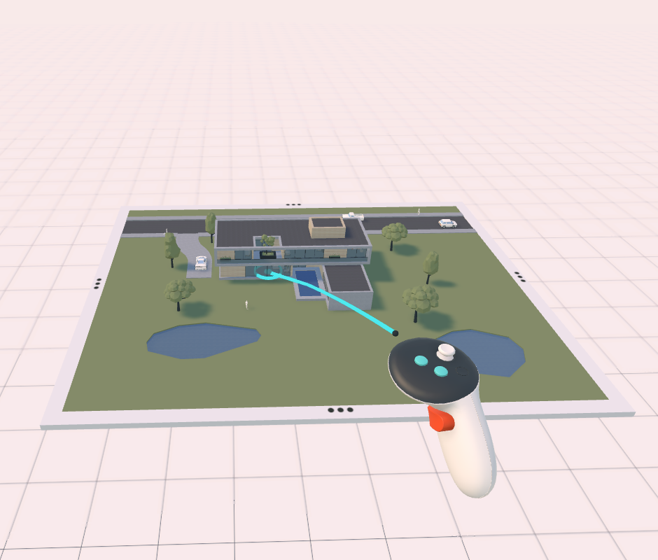

Teleport - You can teleport by pressing the dominant hand thumbstick forward. This teleports you to the target and changes your scale to human scale (1:1). Teleporting into the sky will put you back to your previous god scale. It's possible to teleport through vertical planes in Arkio to allow you to teleport inside buildings. We're also looking into adding a dedicated fly mode in Arkio in upcoming updates for users who want an alternative way to navigate.

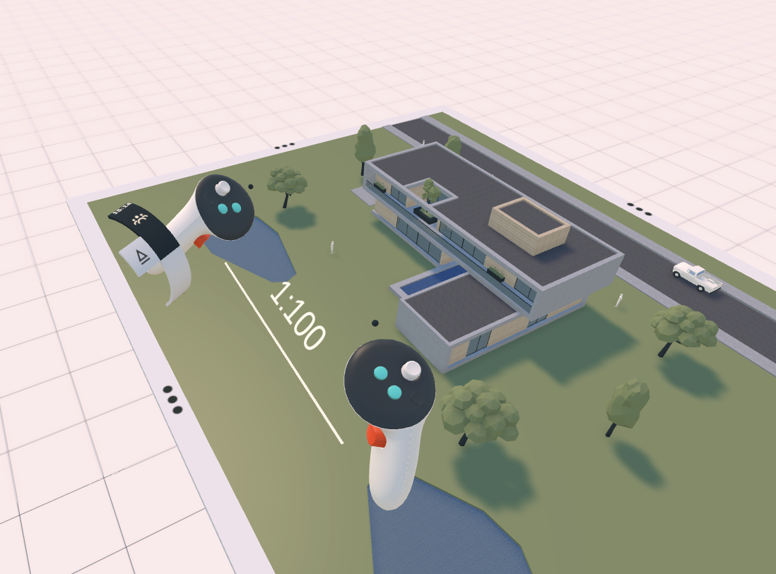

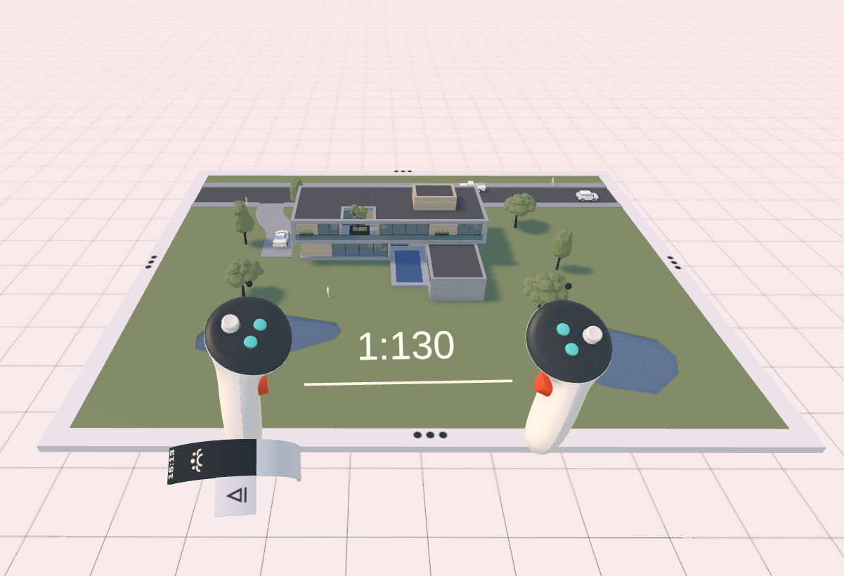

Scaling - To scale the scene, hold the grip button on both controllers simultaneously, then move your hands together or apart. You will see a white line connecting the controllers with a scale indicator. And should feel your scale change physically. The scale will automatically snap when nearing an architectural model scale (1:10, 1:50, 1:100, 1:500, 1:1000).
Rotating - To rotate the model, hold the grip button on both controllers simultaneously. You will see a white line connecting the controllers with a scale indicator. Rotating the controllers horizontally rotates the world around them accordingly.

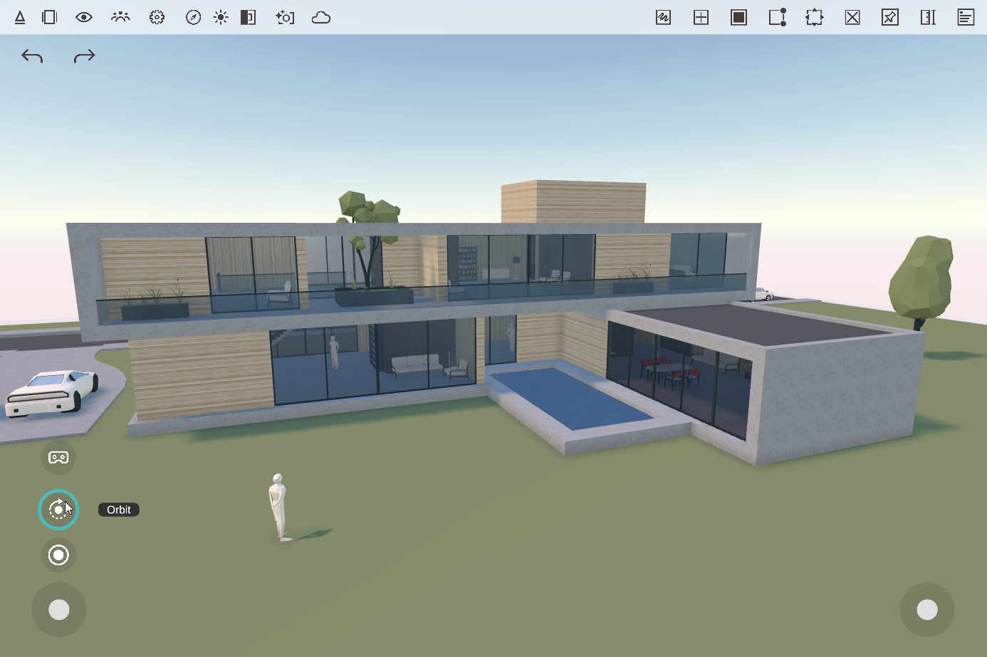

Orbiting - Use your right mouse button anywhere in the scene, or swipe or click the left mouse button on the sky or the white ground to fall back to an orbit, no matter what tool is selected. You can also select the Orbit tool from the bottom left corner to allow orbiting from all surfaces in the scene using your left mouse button, or by swiping on your touchscreen.

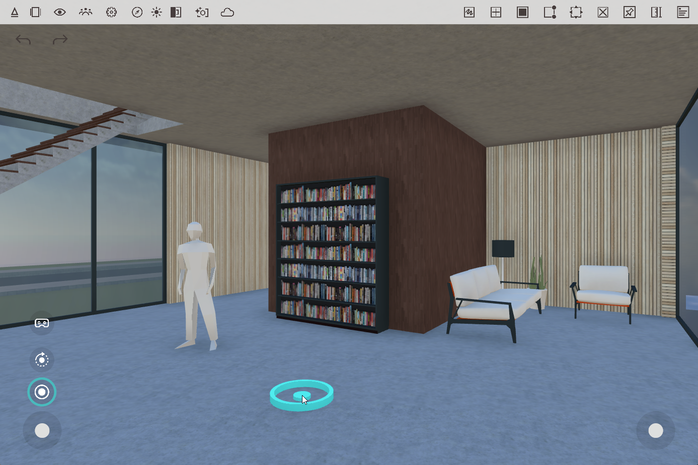

Teleporting - Using the teleport tool in the bottom-left corner lets you teleport anywhere in the scene at human scale (similar to VR navigation) with your left mouse button or by tapping on your touchscreen.
Looking around - In teleport mode, your right-mouse-button navigation switches from orbiting to looking around, making it easier to walk inside your spaces. On touchscreens, you can use the left thumbstick to move around and the right thumbstick to look around.
