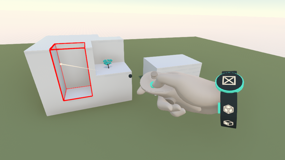

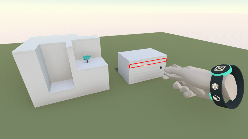

Delete tool - the most straightforward way is to use the delete tool, highlight the object that you like to remove from the scene (also possible for void shapes) and press trigger to confirm.
This way of deleting is practical when you only want to delete certain objects one by one. You can also keep holding the trigger if you like to keep deleting other objects hit by the laser, useful for quickly cleaning out your scene.
With the delete tool, itβs also possible to toggle the wristband to sub-elements so you can delete individual elements from compiled shapes like walls and ceiling in hollow primitives.
