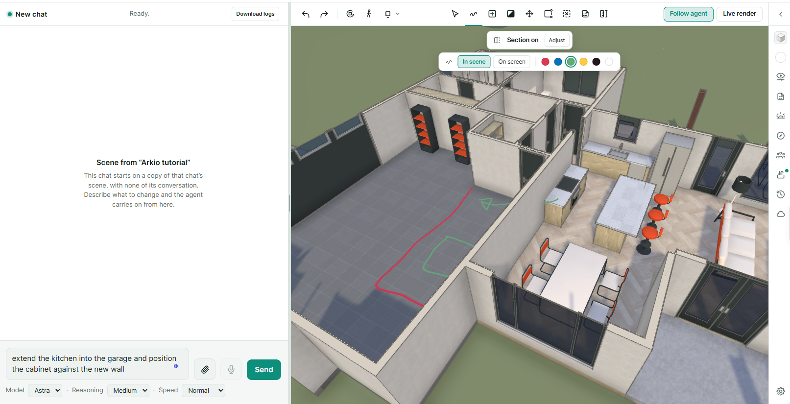

Guide the agent with selections and sketches
Select objects before sending a request to make it clear which parts of your design you want to change. Describe what should happen and what should stay unchanged.
For example:
Move the selected table closer to the window and leave the other furniture unchanged.
Use the Sketch tool when it is easier to show an idea than describe it:
  1. Position your view so the area you want to change is clearly visible.
  2. Select Sketch and choose On screen to draw over the current view. The camera stays in place while you sketch.
  3. Draw an outline, circle an area, or use different colors to indicate changes.
  4. Select Send to agent to attach the marked-up view to your message.
  5. Add instructions explaining your marks, then send your request.
Add a canopy following the red outline. Keep the entrance circled in blue clear.
Send to agent prepares the image in your message; it does not submit the request automatically. You can also choose In scene to sketch within the 3D scene.
