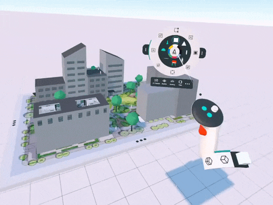

When the create or paint tools are active, the inner circle of the menu shows the favorites palette, allowing quick switching between shapes and materials without opening the asset or material drawers.

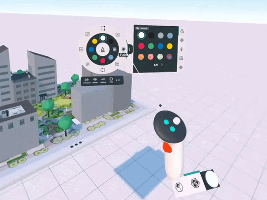

You can customize the favorites menu by dragging assets or materials from the side drawers onto one of the eight slots on the favorites menu. Just hover over an item in a drawer, press and hold the trigger, then drag and drop the asset onto your favorites in the center of the menu. This also works for materials that can be customized from the paint tab. The create tool favorites also show these materials at the center when selecting an Arkio primitive shape.
Your actively selected favorite will show in your favorite menu with a highlighted ring. You can easily switch to another one usingย the Quick Access Menuย and laser select, or touch the favorite prop you like to place or the material you like to paint next.
