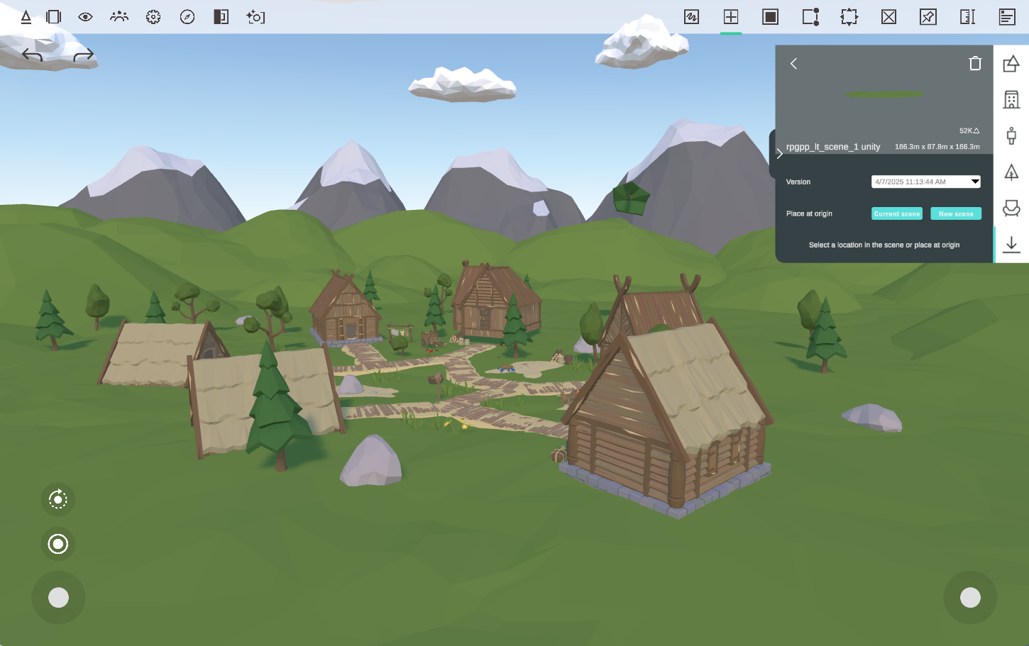

Import and place the model in Arkio
Upload the exported file to the Arkio Cloud portal, or use the local import workflow for your device. On Windows, generic model files can be placed in Documents/Arkio/Import/Models. See Import & export basics for the available options.
  1. Open Arkio’s import library and wait for the model to finish processing. On the desktop interface shown below, use Create → Import.
  2. Select the model and check its scale and orientation.
  3. Place it manually, or choose placement at the origin in the Current scene or a New scene when alignment matters.
  4. If the placed model is pinned, unpin it before moving it. Keep it pinned when you want to protect its position while designing around it.
The screenshots show the desktop interface; import controls may look different on other devices.

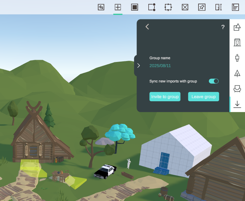

Share the model across Arkio devices
Connect your devices to the same Arkio Cloud group to access the imported file on each device. On the desktop interface shown below, open Create → Imports → Cloud and enter the group’s link code.
Once the model is placed, you can also review the scene with others in an Arkio meeting. Sharing a file through Arkio Cloud and joining a live meeting are separate workflows.
