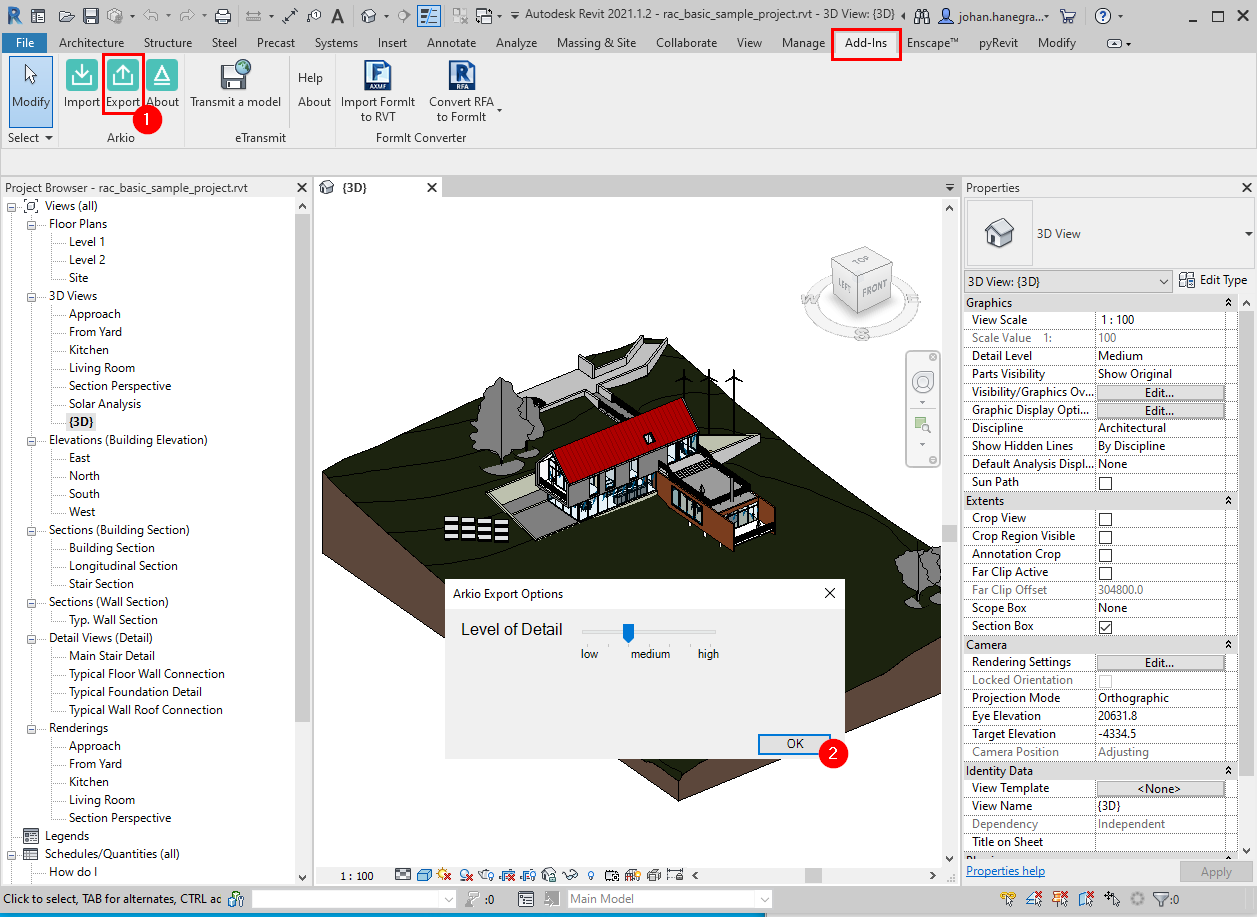

Revit
The Revit plugin can be found under Add-Ins>Arkio.

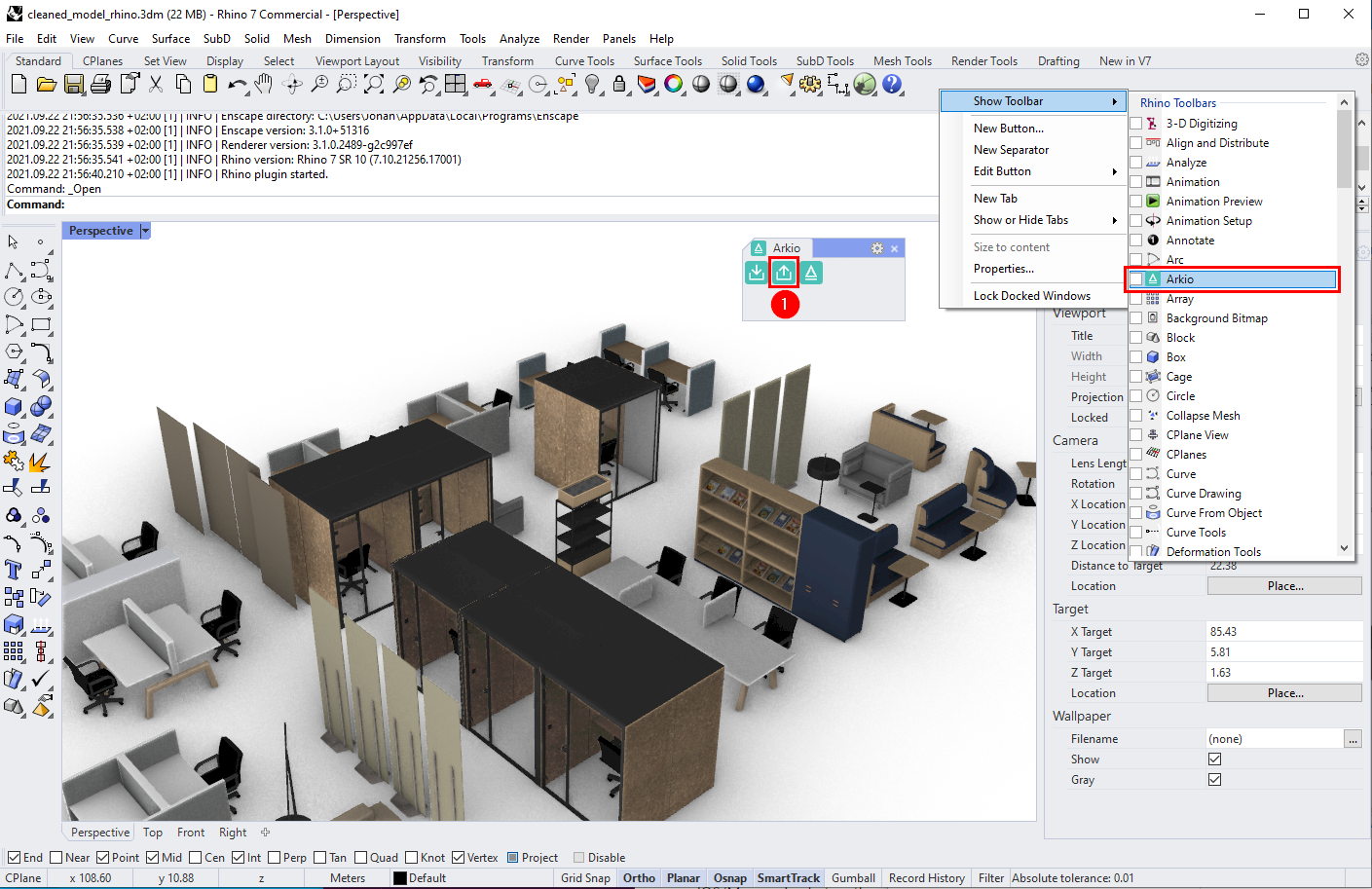

Rhino
The Rhino plugin can be found in the Arkio toolbar

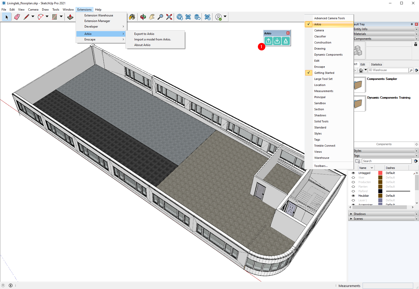

SketchUp
The SketchUp plugin can be found in the toolbar by right-clicking and adding the Arkio tab

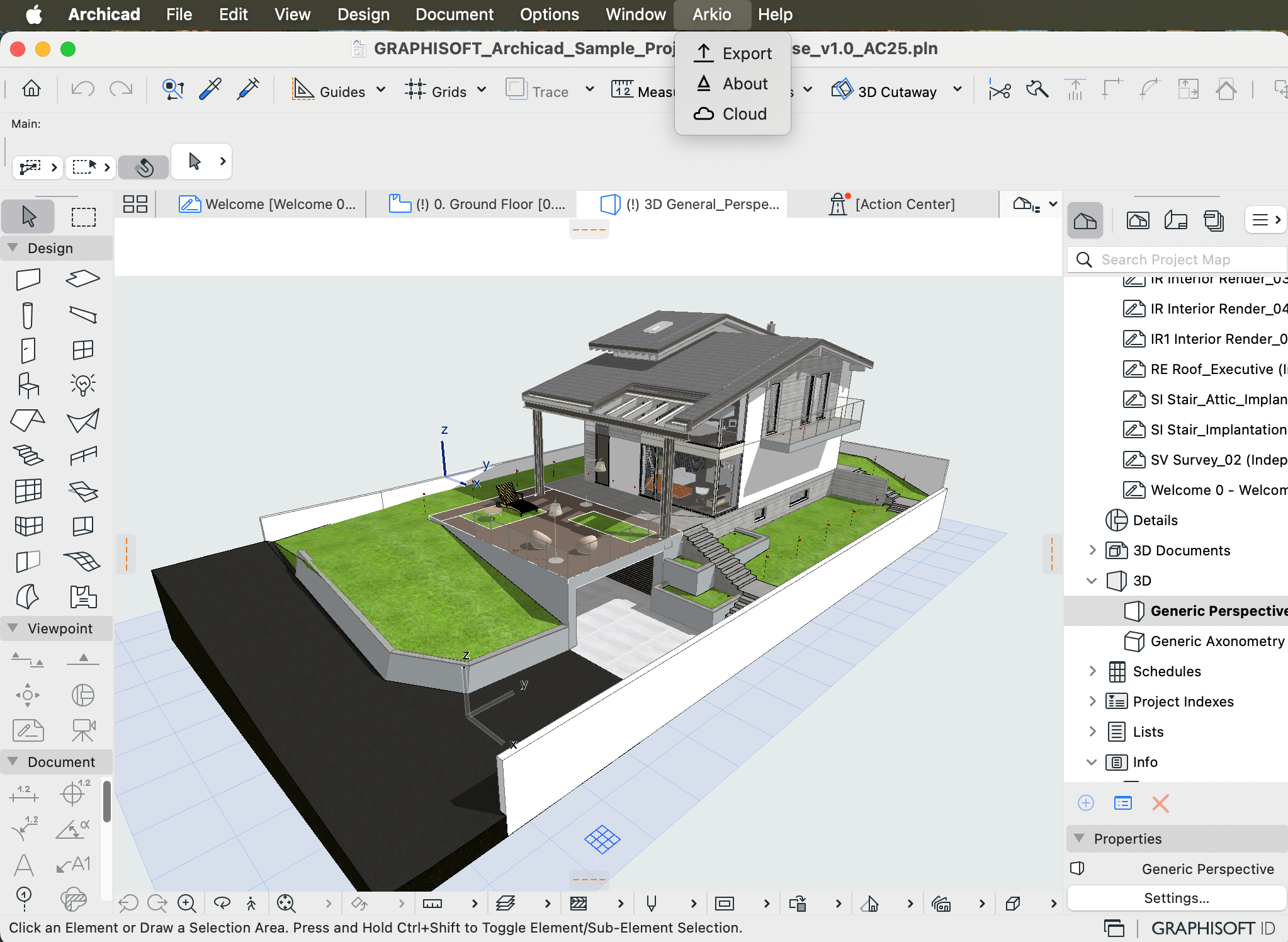

Archicad
The Archicad plugin is available in the main Arkio tab.

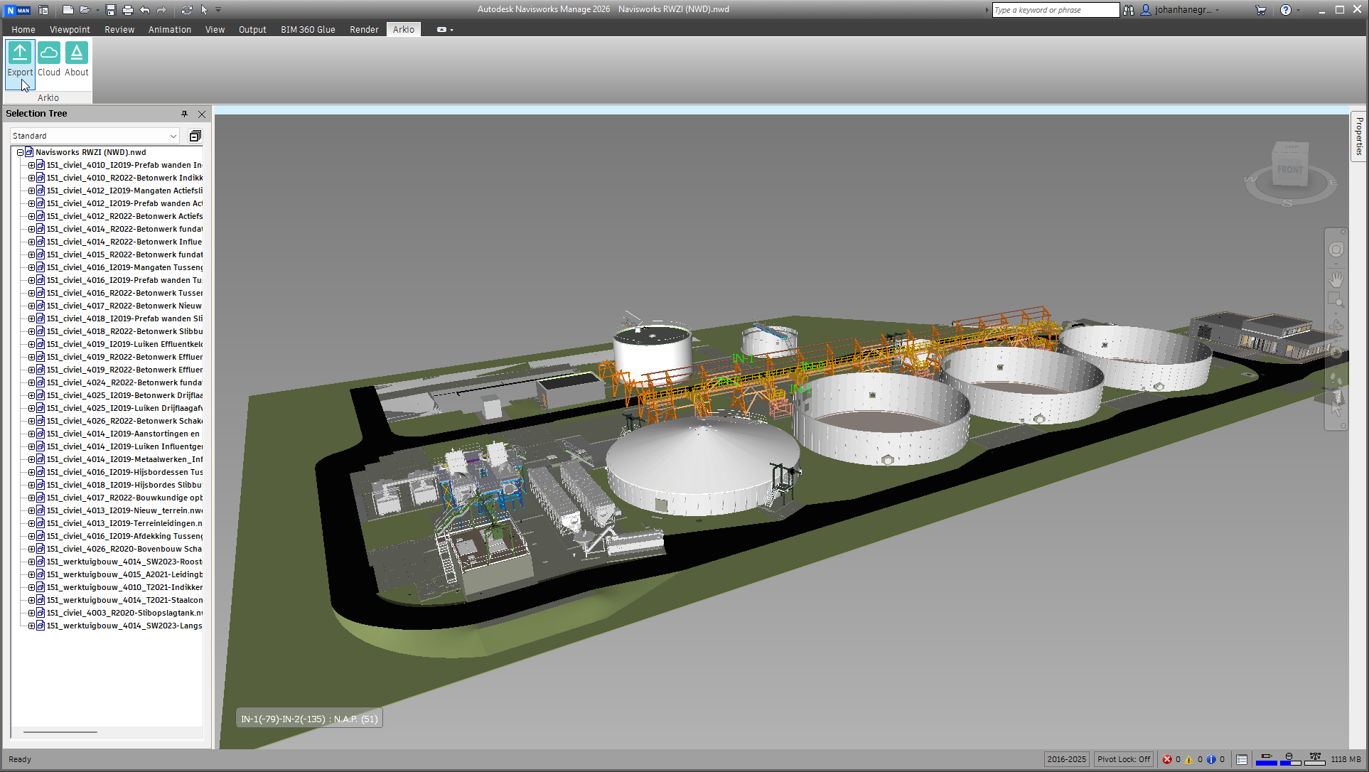

Navisworks
The Navisworks plugin is available in the main tool ribbon
